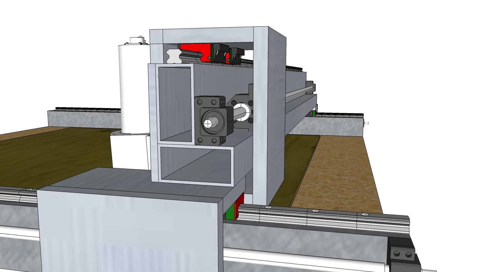

    Quote Originally Posted by PSG View Post
    what is this for? gantry? just trying to work out. thx for the help.
    also if i only use one ballscrew, where will that go? wont one either side be better? or did you mean one length each side?
    I am itching to start this now. going to draw up the steel base now and calc how much it will cost.
    Yes it's for the Gantry, with a 10mm Ali plate bolted to the front.
    Generally people only go for one ball screw on the Y axis as the bearings aren't spaced that far apart. See added components in pic below.
    You're welcome to have the SKP model if you want, PM me your email addy and I'll send it to you.

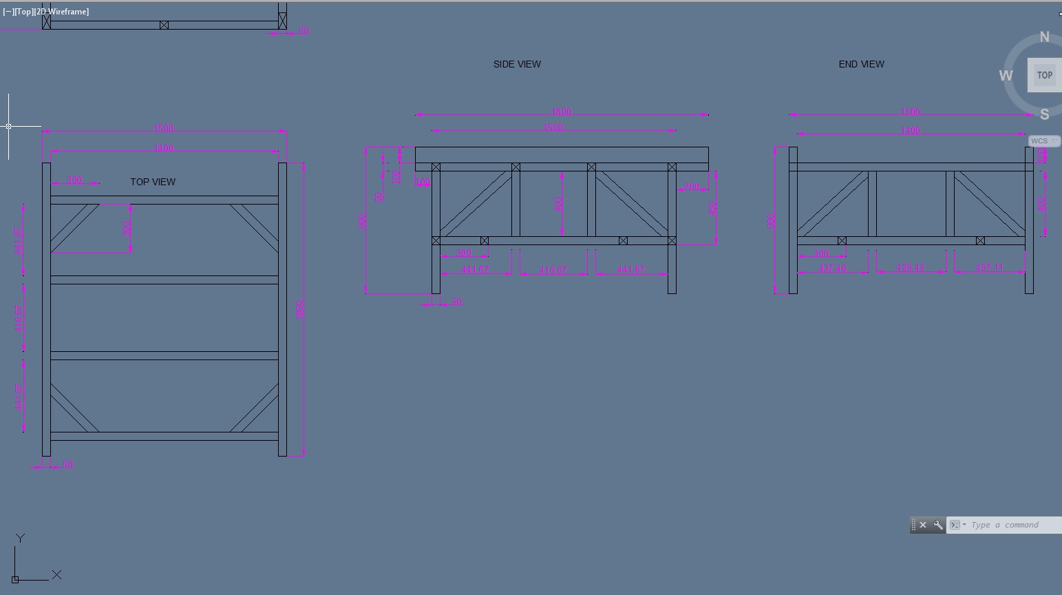

    OK, so after great help from all of you, and this design from NJ, here is my cad version of the base framework

    Hi all,
    after a chat with a few people, and a lot of help from one in particular, this is my new and possibly final design for base framework.

    If the 'top' view shows the actual bed, then I think most would put an additional support right down the centre, top to bottom on your drawing. Also on the screen I'm using just now I can't read the dimensions due to their colour.
