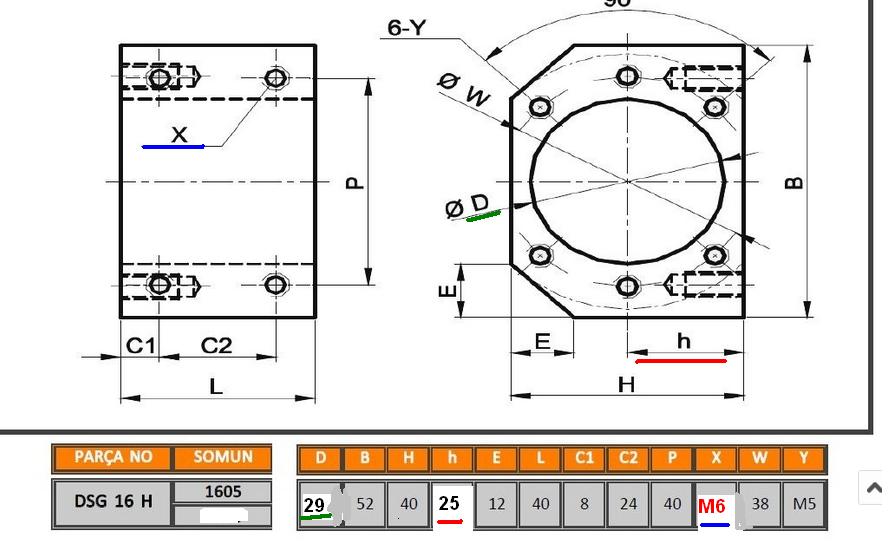

    Building my new Y and Z axis with 1605 ballscrews and SBR20 supported rails.
    The ballnuts I have are 5mm short from center to top. I need 2 made this week please.

    Decided to use 5mm aluminium pieces to pack it out. Parts no longer required
