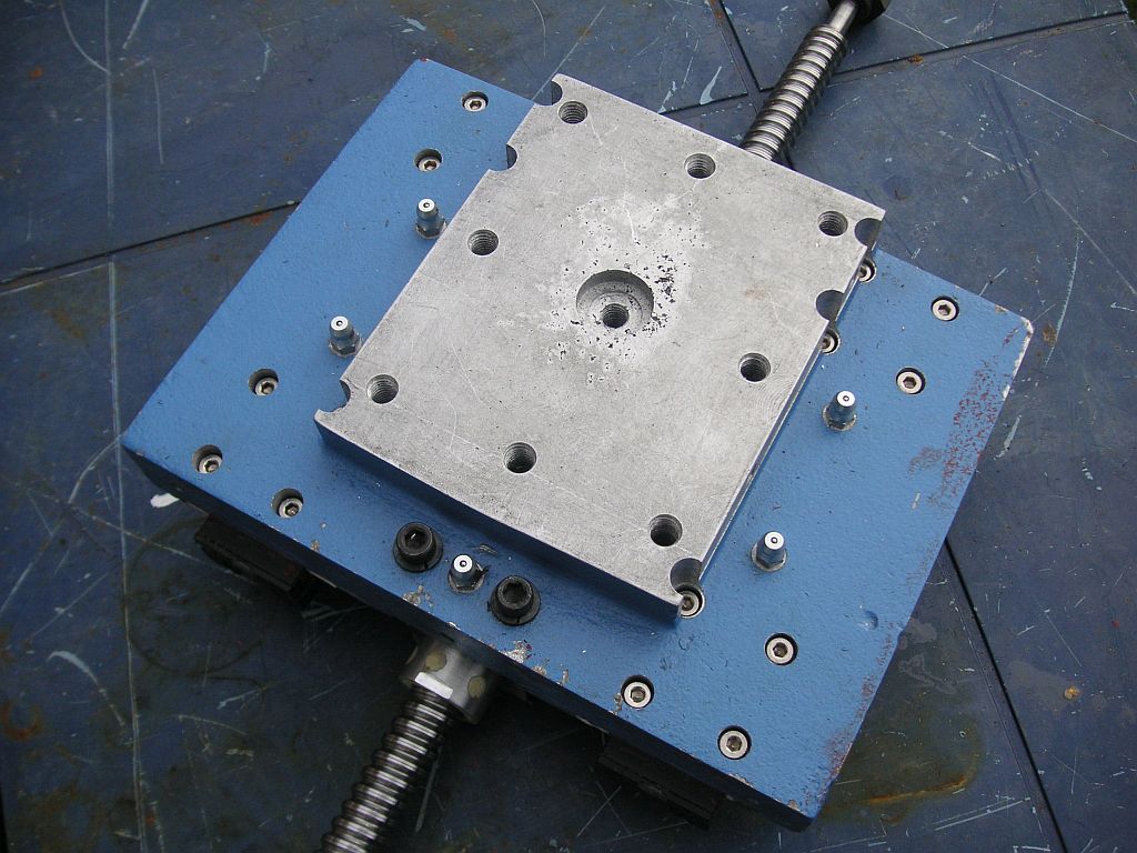

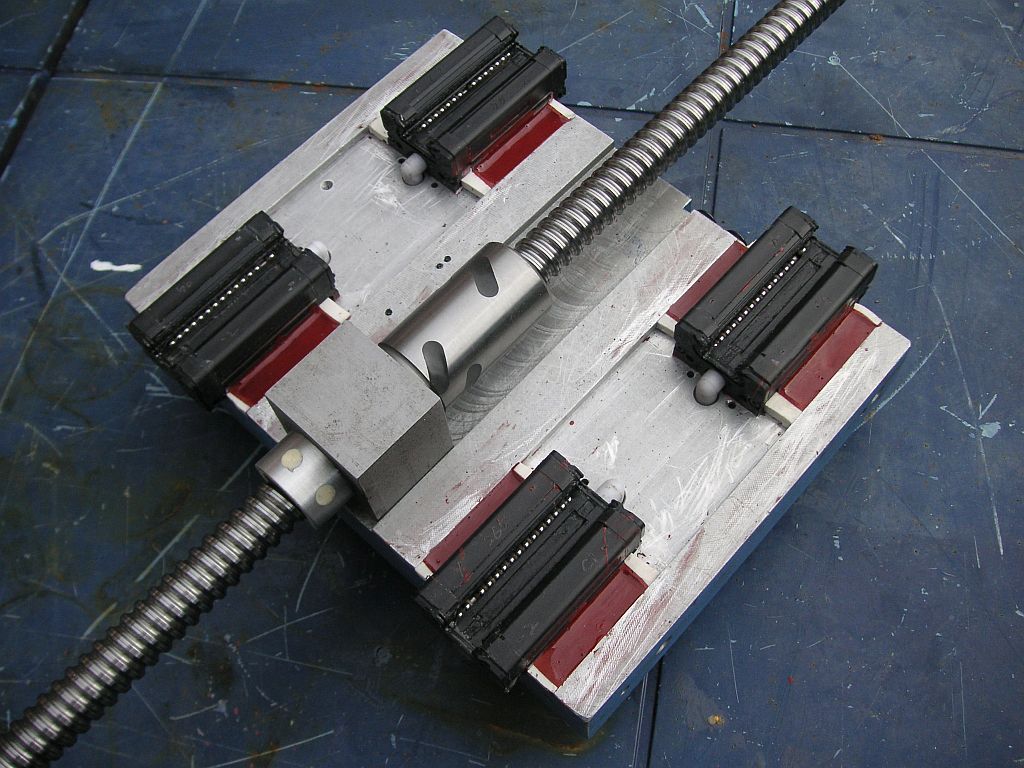

    used 4mm nylon elbows which were a push fit into the carriage

    Looks tidy and good access to nipples, got a source for these elbows ? I can only seem to find pipe thread fittings.

    Ah I see it just pushes in at both ends. With it being captive in the aluminium plate it can't go anywhere so as long as there's a good seal at both ends it should be fine. thanks.
