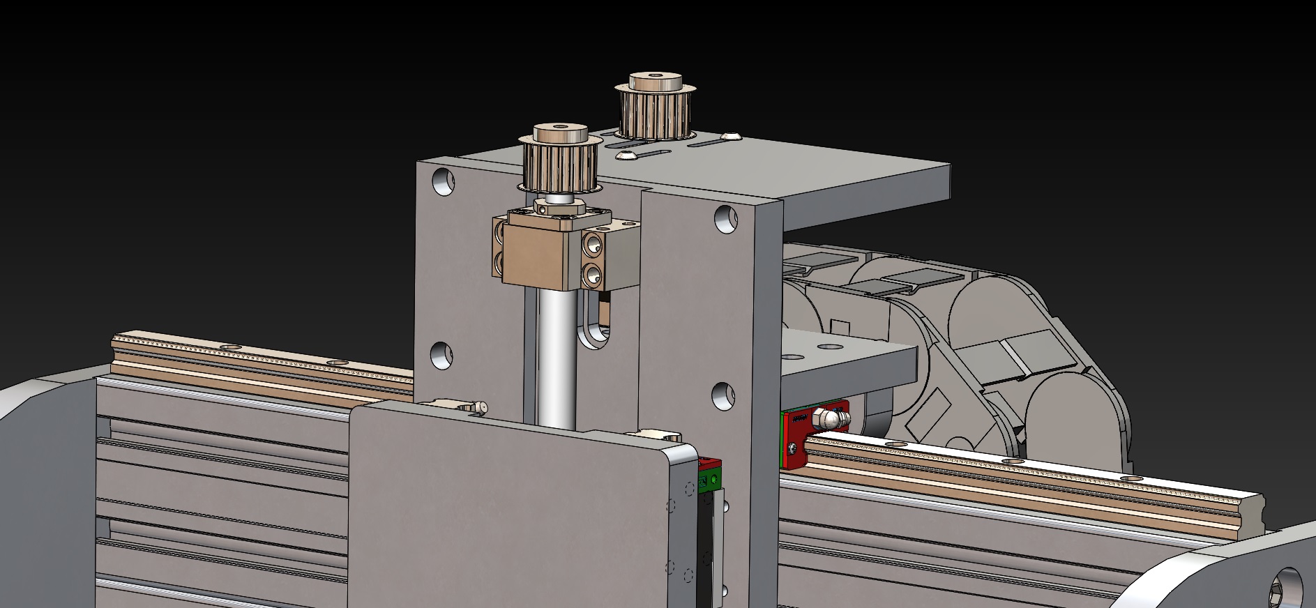

    Just a quick one for anyone, I presume the bf12 can go either way round, but which way does the bk12 go?
    Can go either way but like this is most common. Click image for larger version.
    Quote Originally Posted by qwertyjon View Post
    Funny you should say that, here's my recent findings about the similar FK12
    http://www.mycncuk.com/forums/machin...2-bearing.html
    FK bearings are slightly differant but same applies they can go both ways around. Then only thing with FK is that you can only use one side of the flange but which way it fits on the screw doesn't matter.
    When I've fitted them I've always found it best to fit the flange to outside of bracket or plate holding then this way it makes removing screw easier.
    If you put it on inside it's trapped and makes removing harder and means taking brackets or plates off to remove which then means you have to realign again when replacing. Where if you machine brackets accurate so nice fit for bearing then removing screw for what ever reason is simple and goes back in same place without disturbing anything.! . . . . If that makes sense.??

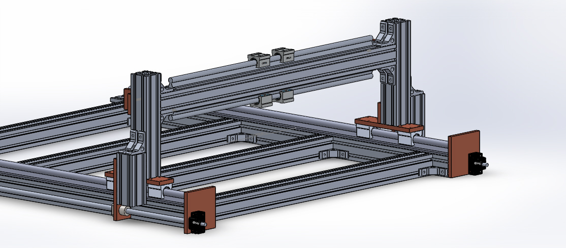

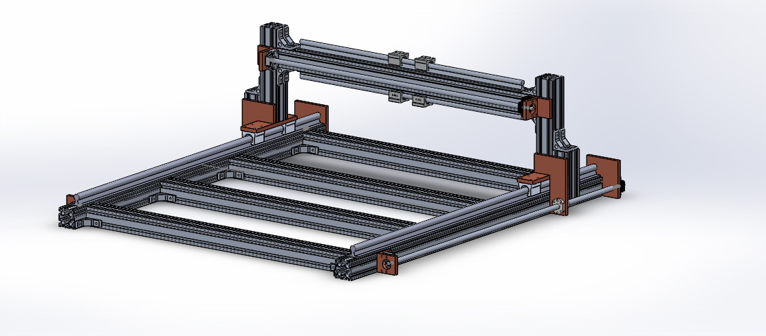

    As promised, I've been working on my design. I've decided to go slightly larger as it works out at only a few £ more. So overall size is nearer 1100x1100mm now.
    Can anyone point out any obvious faults before I carry on? I've designed it with twin X ballscrews, probably going to be belt driven. I'll apologise now that the screws, don't look like screws. And I've not worked out the Z axis yet. Hopefully its a good starting point though.
    The base runs on 20mm supported rail, and the gantry on 16mm. The brackets that I will need to make are out of 12mm aluminium. Will that be strong enough?
