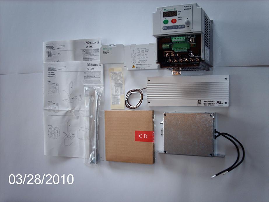

    Jim,
    As Irving has described I clipped one of these types of ferrites on each end of the spindle cable just in case:
    12 5mm Clip ON Ferrite Core Data Cable Ferrous Ring Bead Choke Filter EMI RFI | eBay
    Here's my VFD (top right), mains filter (bottom right), and brake resistor (middle) which was a waste of money (£50) as I never used it since the spindle stops pretty quickly without it.
