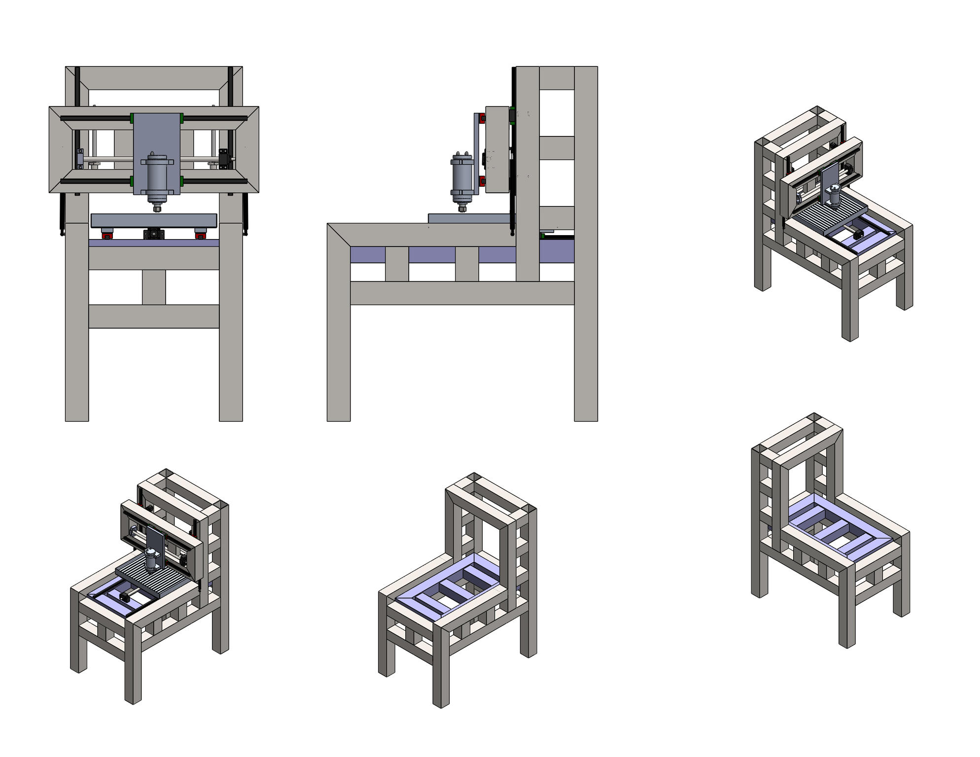

    I have some small stepper motors and availability to get great price thick aluminium plates and steel profiles. So now the idea is to build fixed gantry, super rigid and suitable for at least aluminium/hard materials. Precision is the goal here. I would love the idea of machining steel but its not easily achievable with Chinese WC spindles - I will investigate alternative spindles for that.
    Here is the latest version: 4x100x100 steel frame, welded, epoxy leveled X and Y, 20mm aluminium Z-axis, HIWIN 20 rails, 1605 ballscrews all axis, timing belt drives, aluminium bed with fluid collector, 460x500x200mm.

    Please dont hold back your comments! Steel frame in the picture is probably 3rd version. Still dont like it. I think its rigid enough but although Im good welder it is still complicated and lacks of adjustment options. I will probably separate the frame to lower and upper part. Mybe someone can point me to genius simple fixed gantry frame designs? ;)
    Another issue is with x-bed design. It is designed with aluminium material dimensions that is accessible to me. Fastened with countersunk screws. Could this work or needs more support?

    Sensible thinking on the others and credit to you for doing research before jumping in and having ago your self with design, wish others would do the same.!
    Your design like you say is a little restrictive and complicated around the backside but it's not too far away.
    Now for a long time I've been going to make something similair thou slightly larger but with a slightly differant design that in my opinion if done correctly will give best possible amount of strength at the tool where it's needed.
    Now I've seen a few machines done in this way before but other day found this on youtube which will show you what I mean.
    As you'll see the Gantry lifts not the Z axis. This gives some very serious advantages where it matters at the tool because your getting maximum support from the Gantry at the spindle with No Z extension so only extension from the Spindle is the tool length the chatter is greatly reduced. This allows either better finish or deeper/faster cutting or some of both.
    The machine in the video could be done better regards the frame and it's got a crappy spindle on it so not showing it's true potential but it will show exactly what I mean.
    If the frame was beefed up and Gantry counter balanced to allow faster Z movements plus take some of the strain of motors etc and obviously put a real spindle on it not a toy then IMO it would be a cracking little machine.

    Very interesting design. Have not seen this approach yet.
    What do you exactly mean by counterbalance?
    First thing that pops into my mind is to add 2x rails for Z-axiz to other side of the gantry(cost and alignment issue). And maybe move spindle closer to center line of the gantry. But maybe move Z rails on the sides of the gantry at all...
    I will put it on the canvas.
    Quote Originally Posted by toomast View Post
    Well the name says it all really but how you go about achieving it depends on design.! You can use Gas struts or simple counter weight on rails like you mention.
    Last year I nearly bought a large-ish Industrial 5axis VMC overhead gantry machine that had a long heavy Z axis which used simple counter weight on round type linear rails running down the back with a pulleys at the top, just like the Old sash windows.!! Simple an affective with very little setup, aliagnment wasn't critcal.

    And almost a hole year later I am back. Despite not posting I have frequently visited forum and learned a lot more. Mean time some fantastic build logs have completed which have sent my mind wondering...
    This is my fixed gantry next revision. Frame design is more clear and simpler now. Z is counterbalanced with gas struts. I decided not to limit my design with the random components I have. In near future I have possible projects for this machine - so then I can review the hole design and make needed changes in workarea or something else.

    Thats looking excellent and will be a very strong capable machine. Only thing I see that you dont show is any scope for adjustment between the moving table rails and the gantry upright rails.? (Or is that why the moving table frame is blue.?) They need to be perfectly perpendicular to each other.!
    You wont easily achive this welding the frame so you need some form of adjustment building into the machine. !! PLENTY OF ADJUSTMENT IS THE KEY TO GOOD DIY BUILD.!! . . . I say this in CAPITALS because it's often missed and then regreted later.
  9. #7
    The blue frame is separate from main frame and therefore adjustable. For now I`m not sure how the adjustment and rigid fixating of the bed frame will look like...
    Welding the big frame together will take some time but. Wonder if there is any point creating subassemblys and bolt them together?...there is not any adjustment needed if I epoxy level gantry upright rails and bed frame is adjustable. It will be heavy fo sure.
