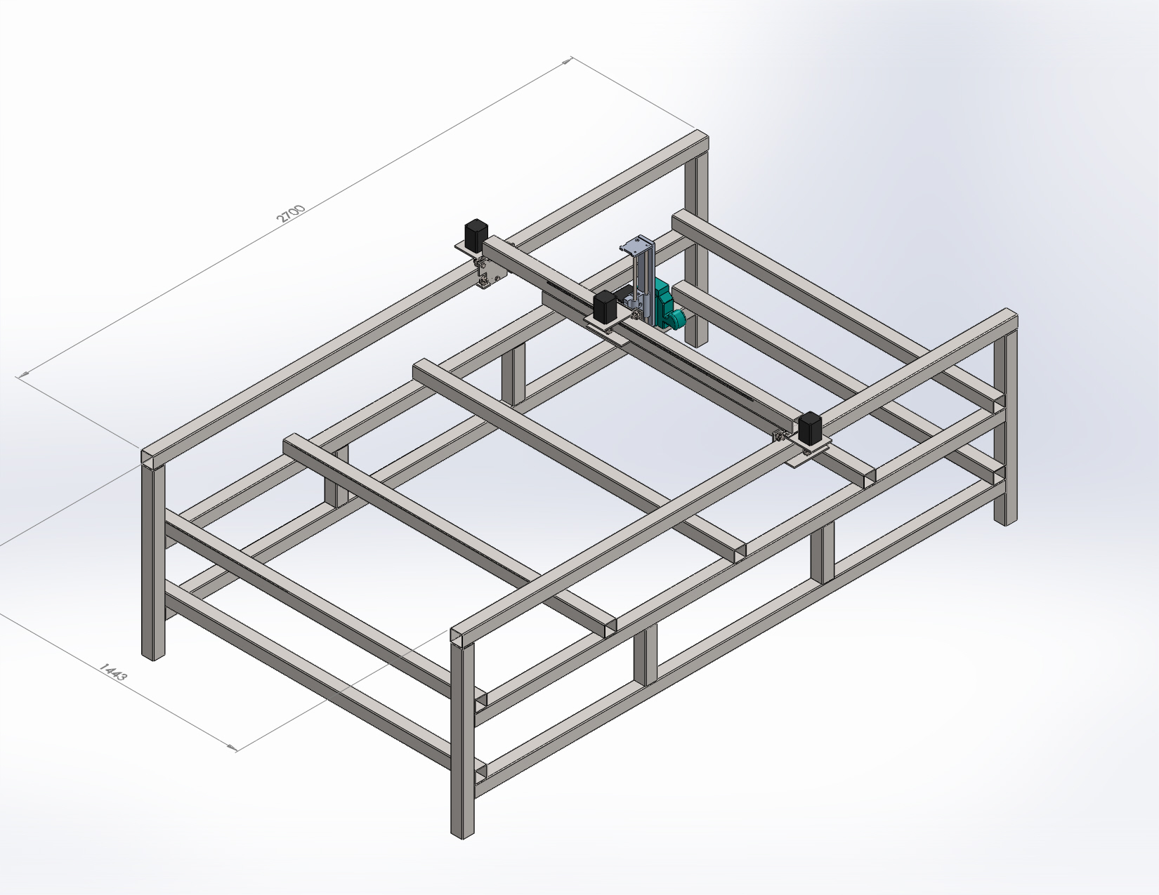

    Next in line was serious wood router for big format 1250x2500 timber sheets. With possible precise aluminium options. Design came up like this. Aluminium gantry, adjustable bed, eopxy leveling and HIWIN rails.

    But could not really see much work for large wood sheets and it would suck at precise aluminium. So folded again.

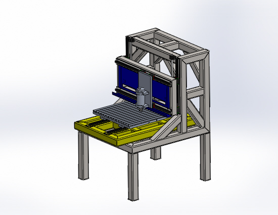

    I have some small stepper motors and availability to get great price thick aluminium plates and steel profiles. So now the idea is to build fixed gantry, super rigid and suitable for at least aluminium/hard materials. Precision is the goal here. I would love the idea of machining steel but its not easily achievable with Chinese WC spindles - I will investigate alternative spindles for that.
    Here is the latest version: 4x100x100 steel frame, welded, epoxy leveled X and Y, 20mm aluminium Z-axis, HIWIN 20 rails, 1605 ballscrews all axis, timing belt drives, aluminium bed with fluid collector, 460x500x200mm.
Name:	Fixed gantry 460x500mm ver 1.jpg
    Please dont hold back your comments! Steel frame in the picture is probably 3rd version. Still dont like it. I think its rigid enough but although Im good welder it is still complicated and lacks of adjustment options. I will probably separate the frame to lower and upper part. Mybe someone can point me to genius simple fixed gantry frame designs? ;)

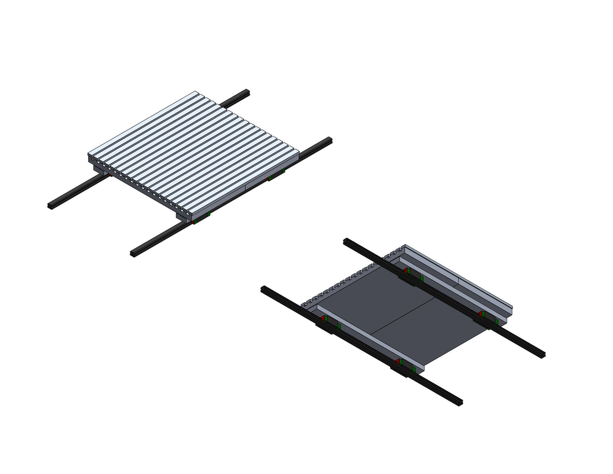

    Another issue is with x-bed design. It is designed with aluminium material dimensions that is accessible to me. Fastened with countersunk screws. Could this work or needs more support?

    Sensible thinking on the others and credit to you for doing research before jumping in and having ago your self with design, wish others would do the same.!
    Your design like you say is a little restrictive and complicated around the backside but it's not too far away.

    And almost a hole year later I am back. Despite not posting I have frequently visited forum and learned a lot more. Mean time some fantastic build logs have completed which have sent my mind wondering...
    This is my fixed gantry next revision. Frame design is more clear and simpler now. Z is counterbalanced with gas struts. I decided not to limit my design with the random components I have. In near future I have possible projects for this machine - so then I can review the hole design and make needed changes in workarea or something else.

  7. #6
    Thats looking excellent and will be a very strong capable machine. Only thing I see that you dont show is any scope for adjustment between the moving table rails and the gantry upright rails.? (Or is that why the moving table frame is blue.?) They need to be perfectly perpendicular to each other.!
    You wont easily achive this welding the frame so you need some form of adjustment building into the machine. !! PLENTY OF ADJUSTMENT IS THE KEY TO GOOD DIY BUILD.!! . . . I say this in CAPITALS because it's often missed and then regreted later.
  9. #7
    The blue frame is separate from main frame and therefore adjustable. For now I`m not sure how the adjustment and rigid fixating of the bed frame will look like...
    Welding the big frame together will take some time but. Wonder if there is any point creating subassemblys and bolt them together?...there is not any adjustment needed if I epoxy level gantry upright rails and bed frame is adjustable. It will be heavy fo sure.

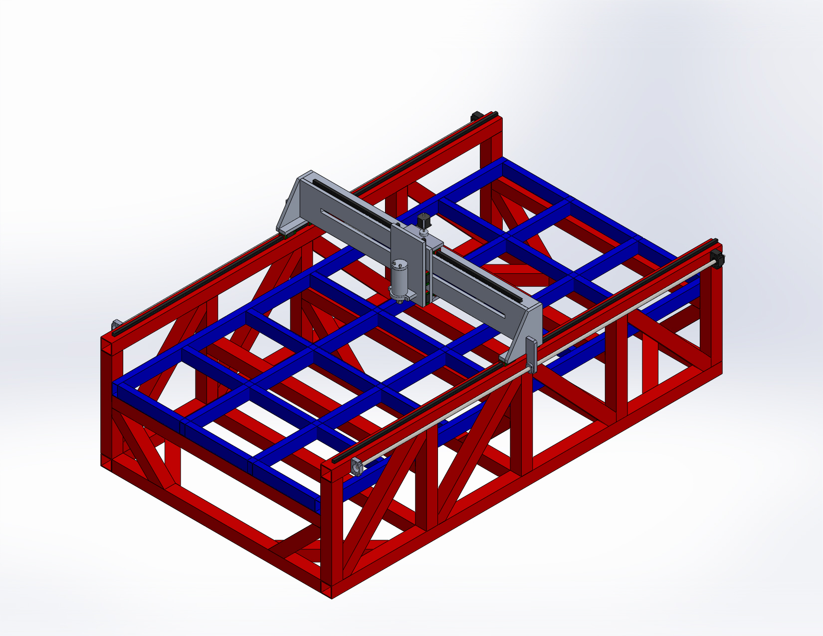

    In search of a better/simpler/cheaper design I have come up with these versions. As pictures illustrate I did not succeed.
    For the time being this fixed gantry design will come to a halt. As I have a need for larger work area and more general machine. Probably will go with something similar to Syliavski`s design.
    This project is published in https://grabcad.com/library/fixed-ga...nc-460x500mm-1

  11. #9
    It still looks a tadge wrong to me...
    I thought the big advantage of the fixed gantry was that you could localise the support for the bed where it was needed. You put your rails on the bottom of the bed and your linear blocks under the gantry. There is no point in supporting the bed anywhere but under the gantry, you are just introducing unnecessary overhangs
    The machine should appear as a gantry with a bed sliding through it

    It is not perfect :)
    I don't quite follow you though.
    Do you mean fixing HIWIN rails to moving bed and bearing blocks to main frame?
