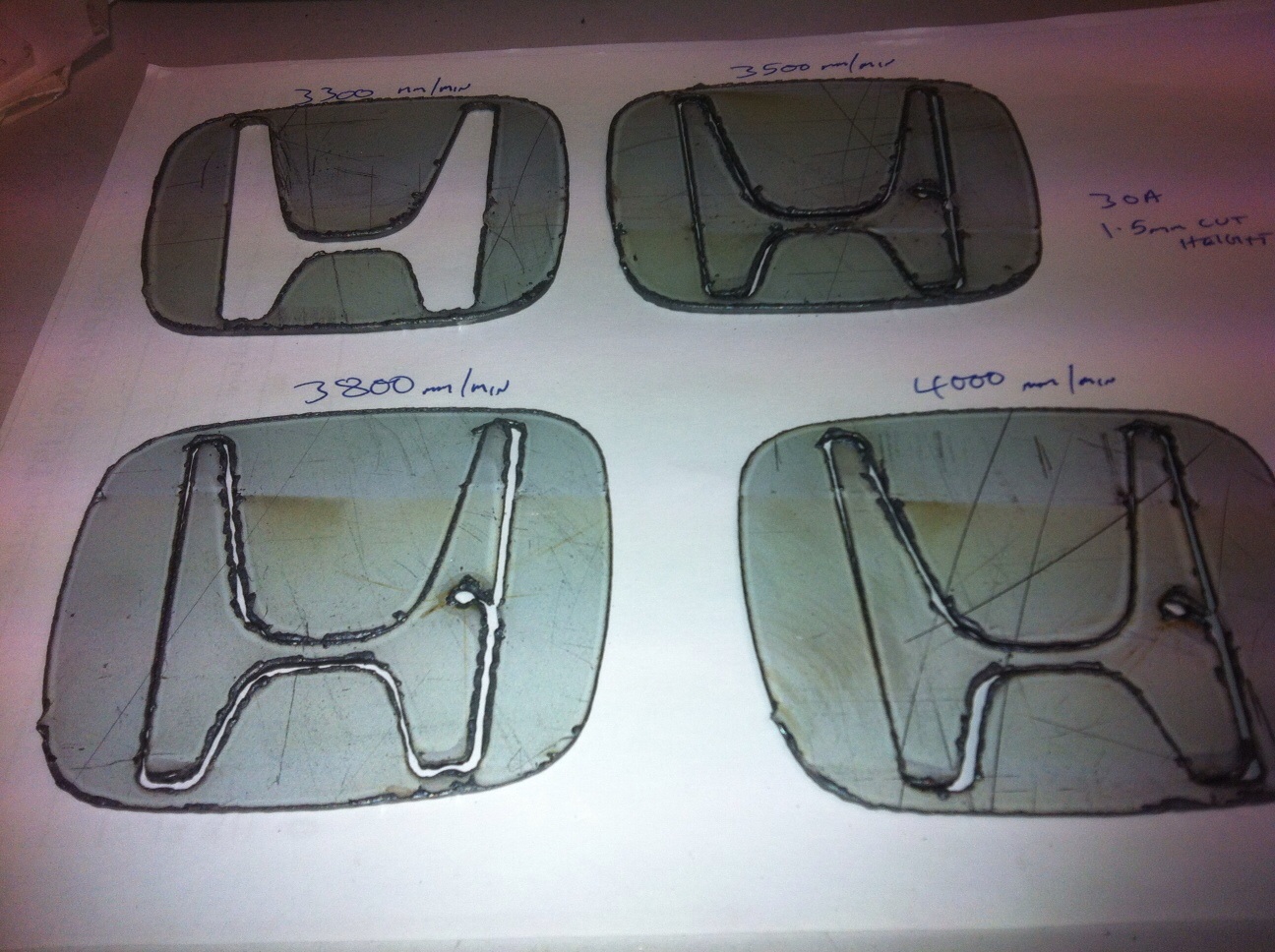

    Having finally got my table up and running, I need assistance with poor cuts, could anyone give some suggestions as to what I can check, these are the results I am getting....
    There is no visible slop in my axes movements, speed seems to make little difference. Cutting height was 1.5mm it was worse at 2mm but no better at 1mm.
    this is 1.5mm steel at 30A, rear view.
    the dross chips off pretty easy, but there is a lot of bevel in the edges which varies as the torch goes round, the edges show a swirly cut type effect in many places, not smooth at all.
    in a straight line it cuts far far better.
    any suggestions?

    It could be related to speed/power, due to the fact the plasma/flame lags behind the actual torch position, however I'm only guessing.
    Suggestions are coming in that I have the wrong torch for 1.5mm cuts, it's a 100A torch on a 50A plasma with a 1.1mm tip. It seems the flame is far too hot/wide but the torch does not have a smaller tip.
    i need a 50A torch with possibly 0.9 or 1mm tips for this thin steel.
    i will get some thick steel to test, this should prove the theory if it cuts well.
    How does the plasma cut manually? If you're able to get good cuts by hand you can measure distances and estimate speeds to get close to a starting set of figures to work from.
    I have a plasma cutter that's currently manual but has remote switching for automation, the torch it came with has cut 1mm through to 10mm neatly without the need for nozzle swaps, are you delivering enough air pressure at the machine while it's cutting to provide sufficient flow? Low air delivery will give you wide, wandering and messy cuts,

    Thanks, swapping tips is out as this is the smallest listed for the machine torch, I will have to fit the hand torch to the machine, that is a smaller torch and has a better range of tips.
    i will certainly be trying the hand torch Monday on this metal and have a feeling I will also be talking to the suppliers, I am guessing they presume everyone will be cutting thick steel so put a nice big torch in, but when it comes to thin sheet it's like using a sledge to crack a nut, works but not very well.

    Results are in...
    30A Machine torch cut on 3mm steel...
    30A Hand torch cut on 3mm steel (top line only)...
    20A Hand toch cut on 1.5mm steel at a good speed...
    The same cut but showing the reverse side (top)...
    The back dross knocked off easy, there was none on the front, one side of cut was bevelled, other was straight, i think this is normal behaviour.
    SO I will be ringing the suppliers for a smaller torch more suited to 20-50A cuts than the 50-100A torch they supplied
    I have also found another user who was sent a massive torch and is now just using the hand torch.
    This seems to be the answer.
    Tried it on 3mm sheet and much better...
    Both at 35A and 1500mm/min, the dross is easily knocked off, the "good" side of the cut is nice and square and within 0.1mm of dimension too.
    It seems it just does not like thin steel??
    I have some 1/4" scrap somewhere, will try that too, but its looking more promising.
    I have a feeling that thin stuff is going to be tougher than thick stuff.
