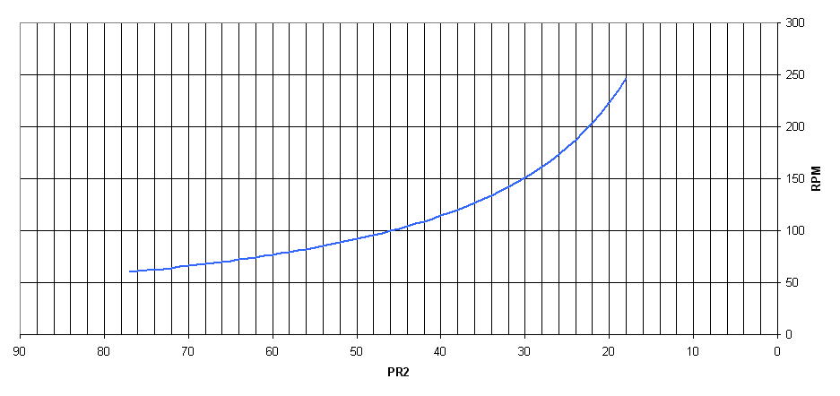

    I'm running a stepper via an EM806 driver and I'm generating the pulses with a PIC via PWM. The frequency is modified by changing the PR2 register, it's pretty crude as it doesn't guarantee a linear speed change, but it's easy to implement (every 25ms or so I simply reduce the PR2 by one), here's what the acceleration curve is like:
    The motor stalls sometimes during acceleration, which got me into thinking that maybe the speed is increased too quickly. I'm guessing the answer is no, but is there an easy way to calculate dynamic torque or an acceleration rate to guarantee the least torque drop during speed ramp up? The motor ramps up from 60RPM to 240RPM within 1500ms and is running at 800microsteps per turn.

    The acceleration 'ramp' is not linear, as I do this via modifying the PR2 register, the RPM changes vary as the speed goes up ie. the lower the PR2 gets, the higher the speed, but the bigger the impact a 'PR2 - 1' operation has. For example going from PR2 = 155 to 154 means a change in speed from 30.05RPM to 30.24RPM, going from PR2 = 40 to 39 means a change in speed from 114RPM to 117RPM. Not sure if it affects anything, the bigger motor seems to stall at the same spot every single time, but I haven't yet tried a constant RPM delta for ramp up (say 1RPM per 0.025s or similar)

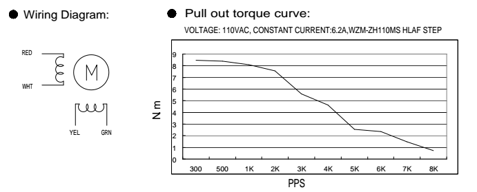

    I haven't got a detailed torque curve for the 12Nm motor, this is the only thing I have:

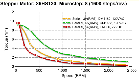

    but it's for a 100VAC driver and that particular motor is a 4 wire version, I'm using an 8 wire connected in parallel. I've asked Leadshine for a torque curve for their own 12Nm just to get an idea of what can be expected and it looks like this:
    As you can see, it also drops off pretty quickly for the VDC EM806 drive, performs much better with VAC and higher voltages. Looking at the speed values and the EM806 at 72VDC, the drop off point is around 80-100RPM, afterwards torque falls dramatically, with only around 3Nm available at 240RPM, this is much worse than the less powerful 8Nm motor I was using before which has a torque curve like this:
    I wouldn't mind using the 8Nm instead of the 12Nm, but unfortunatelly I need the start torque to be at around 12-10Nm, 7Nm from the smaller motor isn't acceptable and causing stalling pretty much on startup.

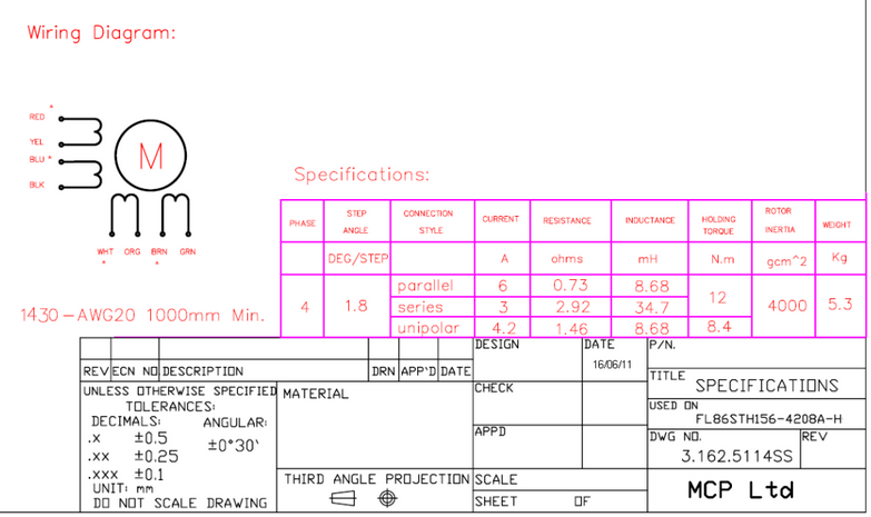

    irving: it's 68VDC on the EM806 driver, here's the inductance data, the 12Nm is used in parallel:
    This is the connections on the driver:
    Phase A: RED + BLU
    Phase A': YEL + BLK
    Phase B: WHT + BRN
    Phase B': ORG + GRN

  9. 9mH inductance :(
    A very crude mental calc shows that at 100rpm on 68v you'll be struggling to get little more than 2Nm torque and at 200rpm it's going to be nearer 1Nm, so you've got less than 1Nm available to accelerate the load through that range.
    The AC drivers still provide dc to the motor so 100vAC is crudely 140v DC so at 68v the performance is going to be roughly 50-60% of the 100v AC curves.

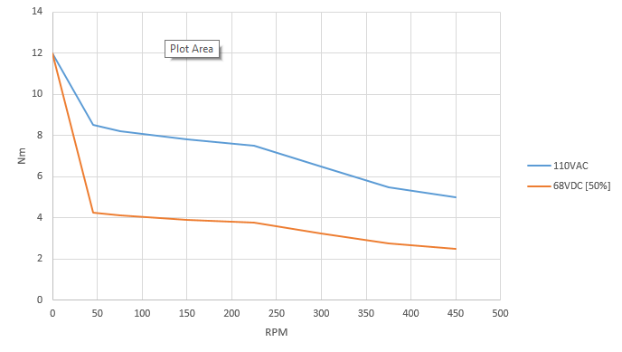

    If 68VDC gives around 50% of what a 110VAC can do torque-wise, here's a chart made using the info from the original 110VAC data from my previous post:
    This would mean still around 4Nm at a pretty wide range of speeds, which isn't the case as testing has shown.
    The 8Nm motor used to stall sometimes at 480RPM at which it had 3Nm:
    http://www.americanmotiontech.com/Up...80_EC_1000.jpg
    this means that the bigger 12Nm must have at least 4Nm or so as it's not stalling at all. It begins to stall at around 180RPM which must be the moment when the torque drops below 3Nm or around. I'd gladly use the smaller motor, but it hasn't got enough starting torque :( it seems that I need around 10Nm on startup, which the small motor cannot deliver.
