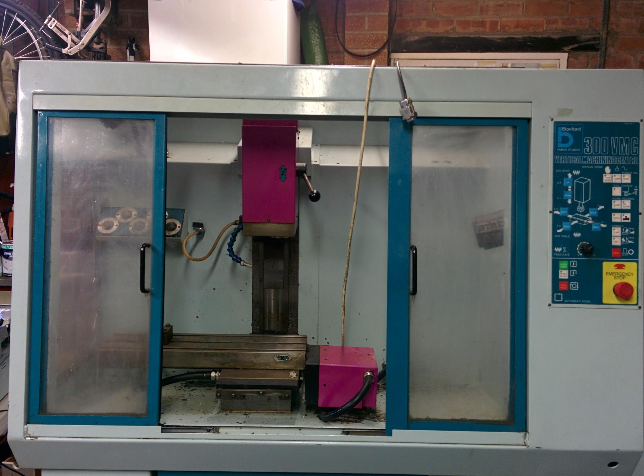

    thanks for all the reply's manage to get a boxford vmc300 now how and what to buy to get it on mach 3 ???

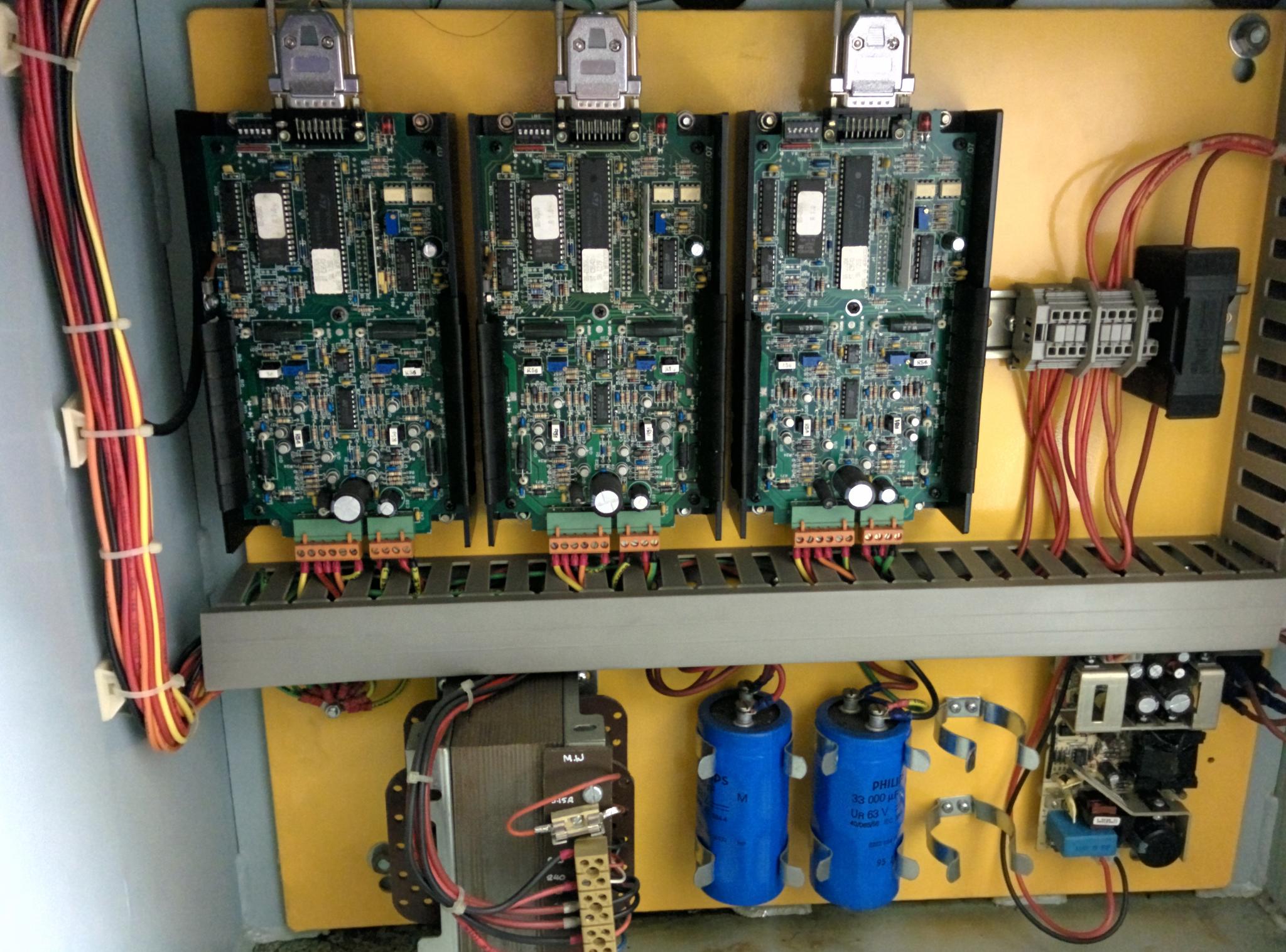

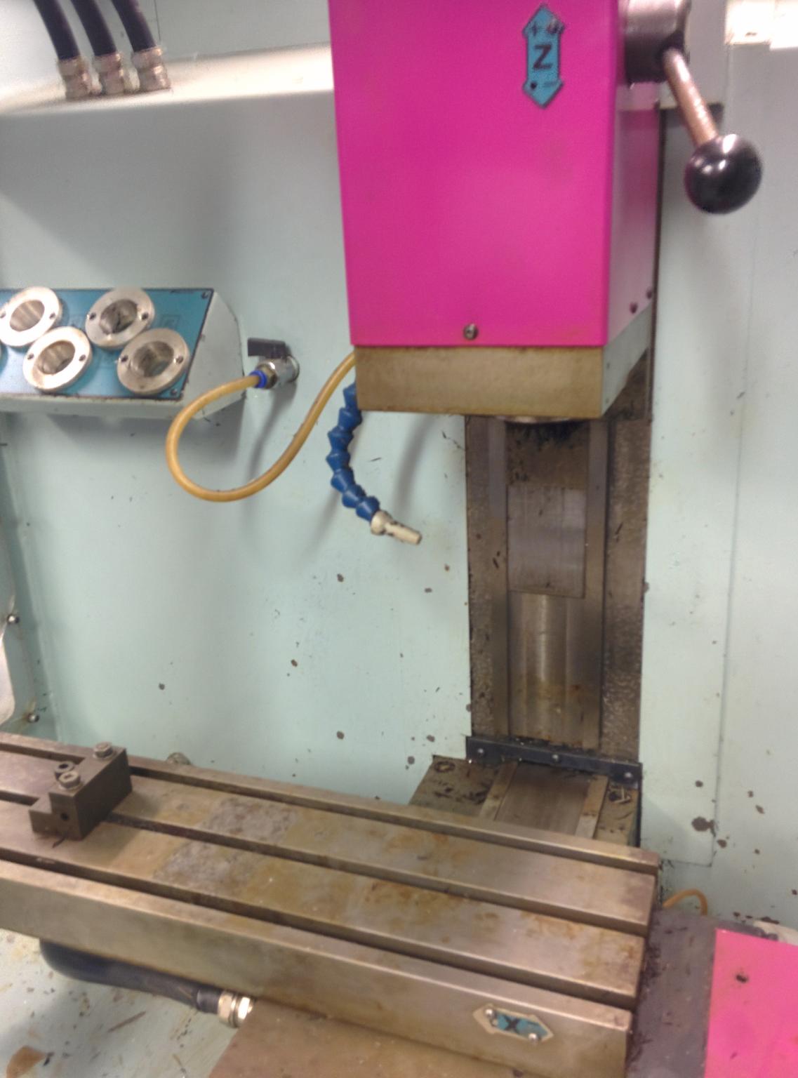

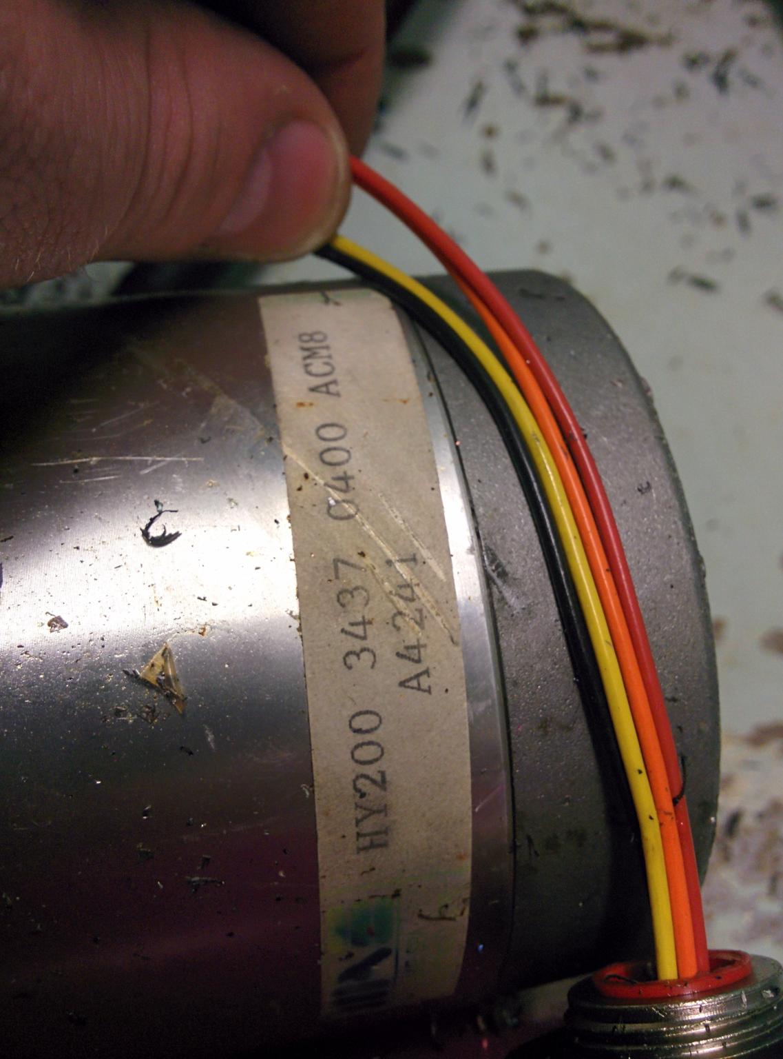

    ok here it is nice clean tidy machine shame to rip it apart but a mach 3 ing I must go any help hints would be greatfully recieved
    Lives in East Lothian, United Kingdom. Last Activity: 17 Hours Ago Forum Superstar, has done so much to help others, they deserve a medal. Has a total post count of 2,994. Received thanks 376 times, giving thanks to others 9 times.
    If you were wanting to go for maximum performance, ideally you'd replace the stepper motors and drives, however what you have should work reasonably well.
    The first step is identifying everything in the control cabinet, and coming up with a plan of what to do.

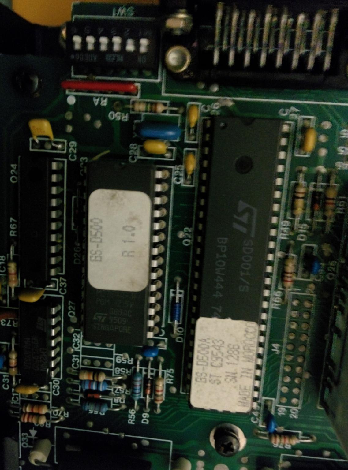

    Google is your friend here, as searching for anything that looks like a part No. or model, will usually help identify things. For example searching for GS-D500 as per the stepper driver, reveals it's a SGS-Thompson GS-D500 driver module, and a datasheet can be found at http://www.premier-electric.com/file...f/GS-D500A.pdf
    I'd say you'll need some form of breakout board, along with either a PC with suitable parallel port, or external motion controller. Personally I'd go for an external motion controller, as they generally make for far easier setup, better reliability, and it'll be more future proof.
    The biggest issue will be if the original control used 24V logic, as most cheaper breakout boards/controllers all use 5V logic. Are there any markings on the linear power supply (circuit board in the bottom right corner)?
    24V logic is the usual industrial control voltage, and makes things more reliable and less affected by noise/interference, however it does make things a bit more expensive.
    And after having a quick scan of the stepper driver manual, it could possibly run on 12V, as the drives use 12V for their logic.
    Also, where do the cables that plug (silver/shielded plugs) into the top of the stepper drives go to?
    There may already be some form of breakout board/controller that they connect to, that might possibly be useable.

    power supply inside will be more than enough ?? DOES THAT LOOK GOOD / SOUND RIGHT
    3 x stepper drivers 4.5 amp minimum 70-80 volt like theses CLICKY LINK (hope that's ok ?) remove if not sorry in advance
    1 x motion controller my pc and laptop are 64 bit and have no ltp port so usb or ether net CLICKY LINK
    1 x pendant not a must have but I want one ? CLICKY LINK
    Personally, if you're going for new drivers, I'd go for some of the digital ones. I think the AM882s have been replaced with the EM series, but I'm not 100% sure on that.
    However, I'd be inclined to try the existing drivers first. I know they're pretty old technology, but a quick scan of the datasheet reveals they were pretty advanced for their time. Even if using them doesn't work out, it'll be a pretty easy swap for new drivers.
