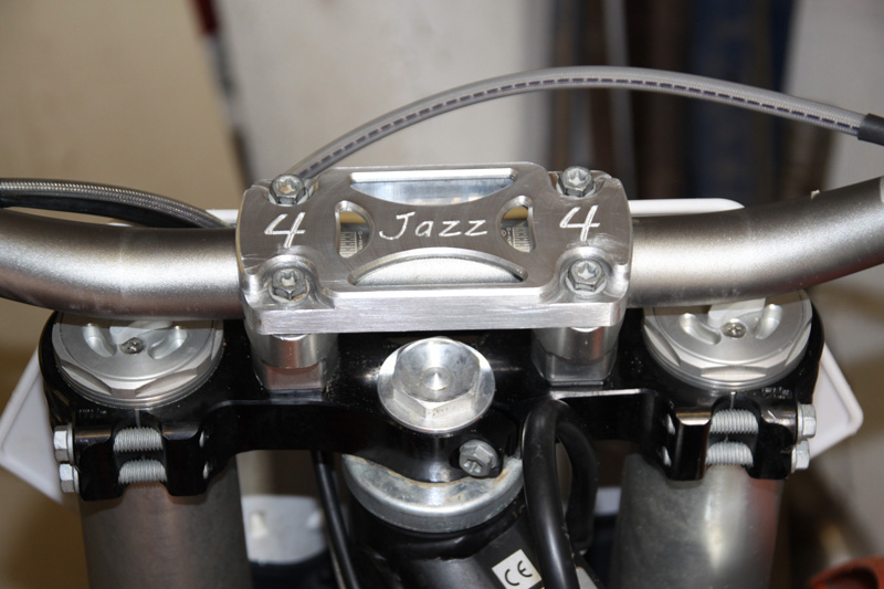

    When they first Came out they had a problem with top handle bar clamp snapping so I made a Fixed cross brace to replace them it also had the affect of stiffening the forks so they didn't twist when dropped in corners.! . . . . Some where I still have the G-code if you ever need it.
