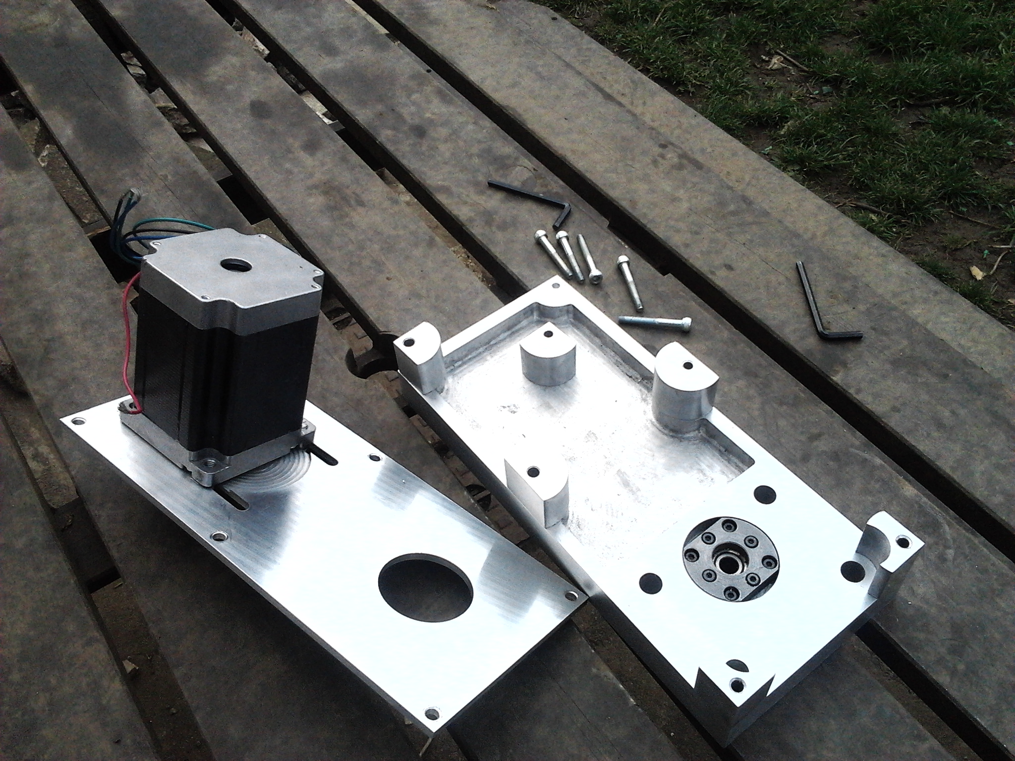

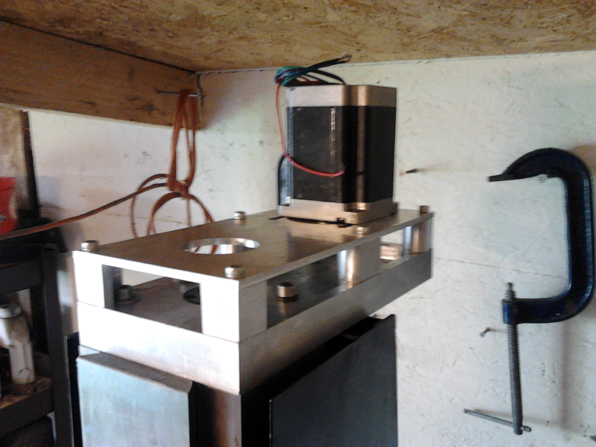

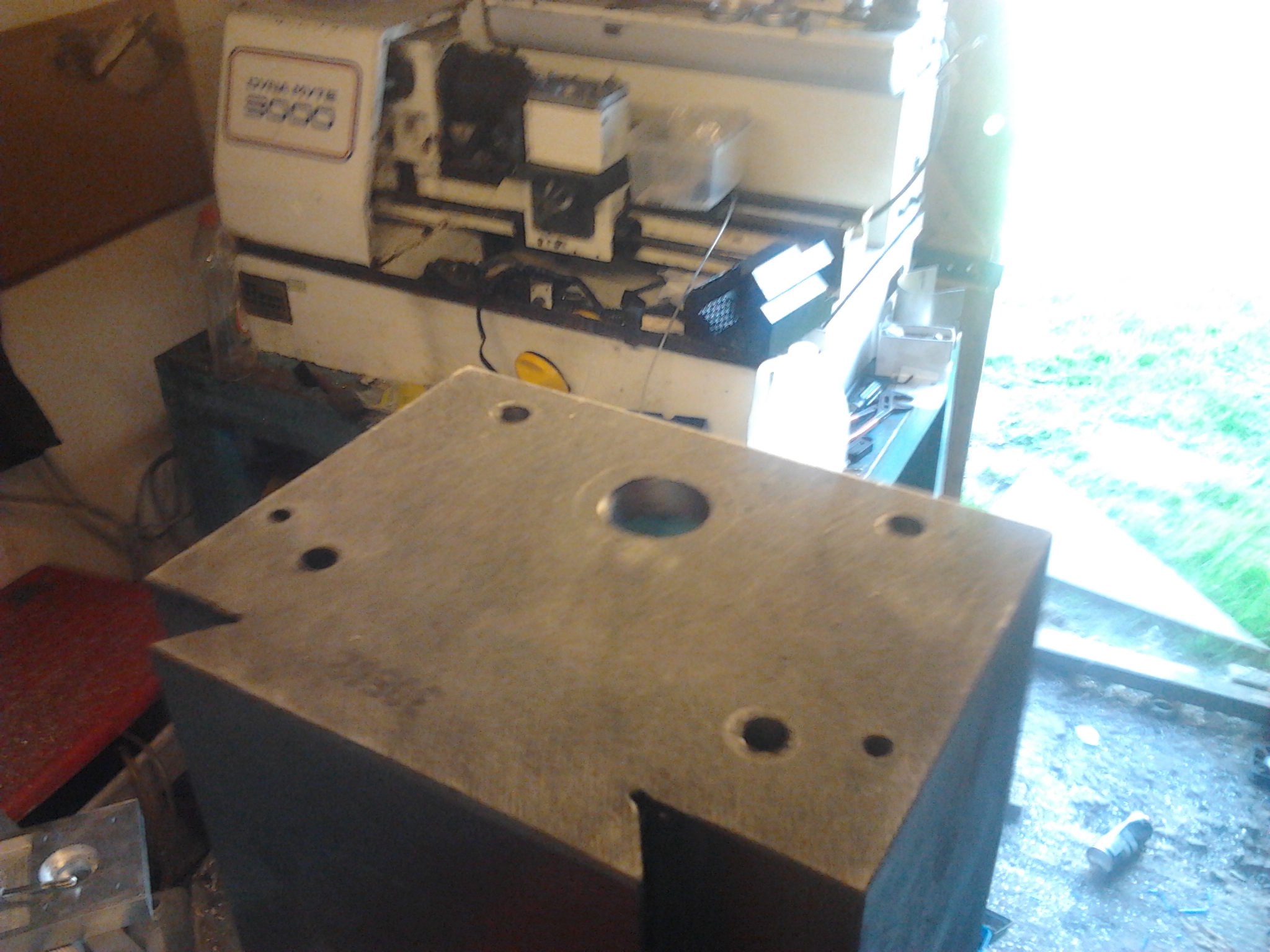

    well progress has been slow,i bought pulleys from beltingonline for the x axis took 15 days delivery only for me to trash em trying to bore them out on a mill,so re-ordered and had them bore them to the correct id ,they should be here around mid may:/.
    just a few pictures of progress so far I will edit this post later today with a few more rather than bump the thread
Name:	nema z axis 013.jpg
Name:	nema z axis 034.jpg
Name:	nema z axis 042.jpg
