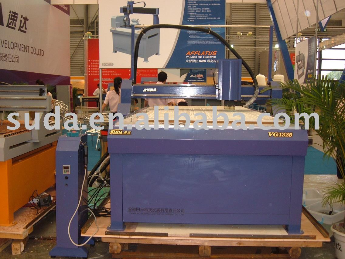

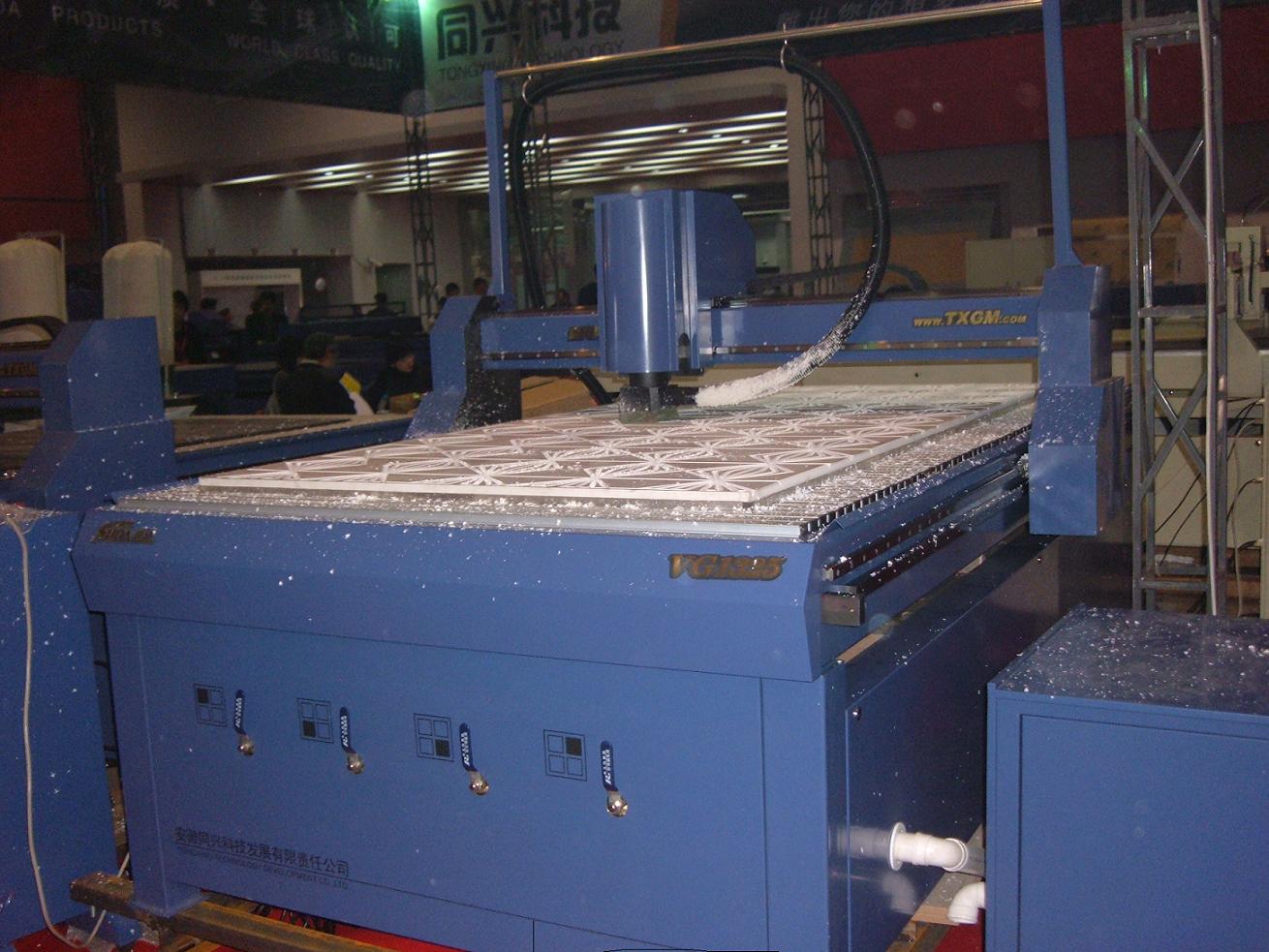

    From what i have looked its as similarities to this one dont you think?

    Maybe Its a older model of this SUDA VG1325 cnc router, from ONGXING TECHNOLOGY DEVELOPMENT Co
    http://www.sudacnc.cn/offer/526836431.html
    https://www.youtube.com/watch?v=EHYUWLCrrI8
    With this specs:http://www.txgm.dpes.com.cn/product/2011/12/278.html
    What do you think?
  7. #5
    Yes that looks very much like the machine doesn't it. I noticed the weight is 1250Kg which i would say is more realistic than 750Kg. That's not overly heavy so should move it easy enough.
    Good Luck.

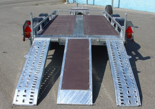

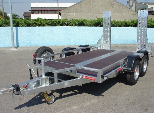

    Well, my idea is to join 3 pallets with 6 x 3m long wood beams, in order to make a 3m x 1,5m pallet, with fixing/anchoring points.
    Then with the help of a hi-lift, slowly put the CnC over the pallet. Fix the CnC router to the pallet and wrap it with plastic film. Then with the help two pallet lifters, pull the pallet near to the trailer:
ID:	12026 Click image for larger version.
ID:	12027 that as 3220x1760mm and can carry 2900kg.
    The with the help of an electric winch assembled in the trailer, i will pull the pallet to the trailer helping with pallet lifters.
    Off course Ideally i would have some machine skates (squid table) to roll the pallet into the trailer. Better, would be to have a Fork Lift Truck to place the pallet with the cnc on top of the trailer...
    What do you think?
  14. #10
    one or two pallet jacks will do the job. And if your dragging it on wood, onto the trailer, grease the wood. We just got a hugely heavy machine out of a small space with 2 of them
    Depending on the weight of the machine, i might consider jacking it up one end, backing the trailer under it, connect and tighten your winch, take both jacks to the back end, jack it close to level, then pull it with the winch,
    What do you think it weighs, i would say bewteen 750kg to 2500kg,
