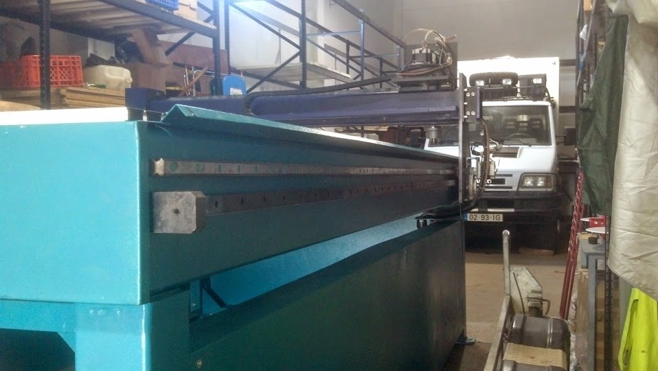

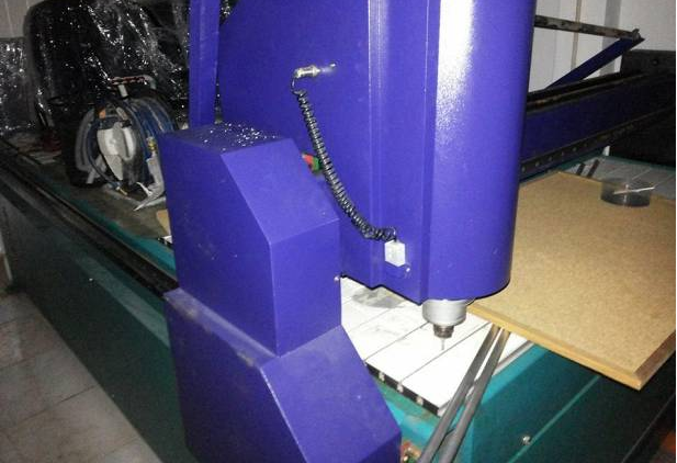

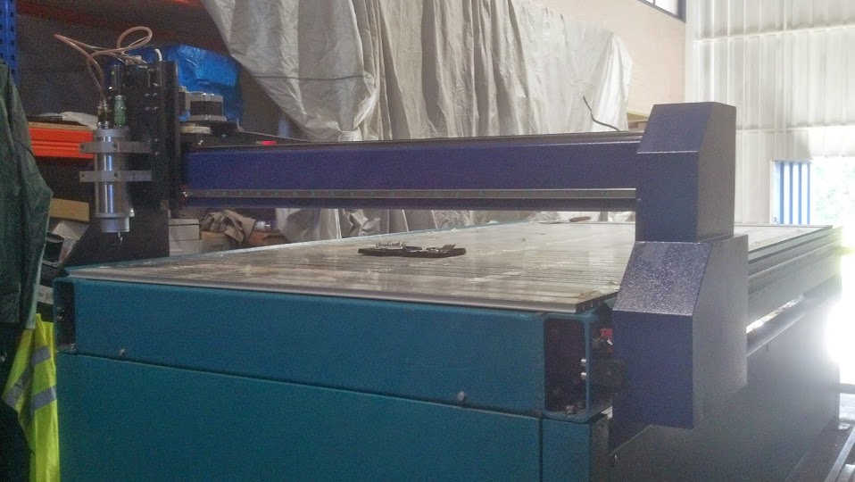

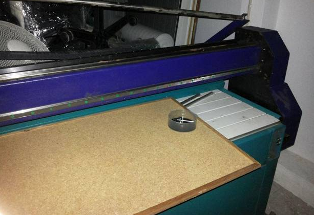

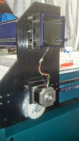

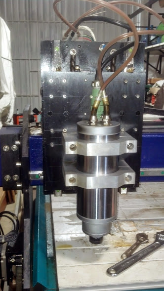

  1. Although these pictures are very small and bad (its what i have been given) what can you say about this 1300x2500 Cnc Router machine, construction quality, etc.
    I dont know the company that makes it, the only thing I know is the worksize. And im tempted to make a trip to get it, but i really need your help and opinions.

    Unfortunately I do not recognise the machine at all - is is described as a Euromod? It doesn't resemble any of the ISEL machines I know of and the construction is not as per ISEL systems (it looks like it has exposed linear rails for example).
    Sorry I can't be of any help - it looks like a nice solid machine though!
    Chris
  3. The Following User Says Thank You to badgerman For This Useful Post:
    Prob an ok machine if the price is right, certainly a good starting point for modifiying/improving. To me it looks like an older chinese built machine, similer anyway. It has Hiwin profile rails and possibly rack and pinion drive on the x and y.
    The size is great as you can use full sheets of ply, which is great for hack spaces as a lot of people design projects around 8 by 4 sheets.
    I you are looking for a guide price I would guess around £1000-2000 if it doesn't work and maybe a little more if it does. You can buy these new from china for £6000 so don't pay over the odd.
    A vacuum pump may be under that black plastic which would be a bonus, but I know the chinese ones do not work very well. A good vacuum pump for this machine could set you back £1000-1500 second hand or £2500 new.
    It looks like there is no tool changer but that would also be a nice bonus if it does.

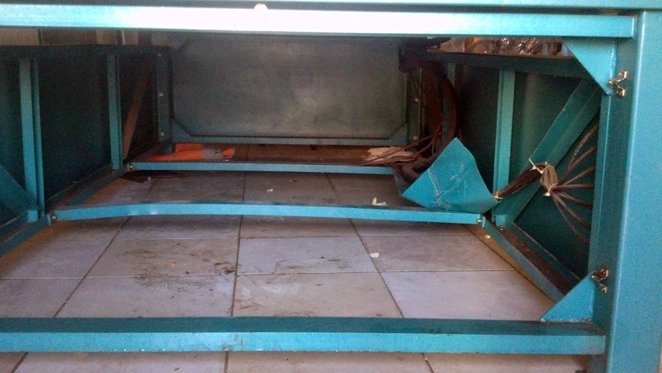

    One of the first things i did was to remove the bented parts and straighten them.
    Then I cleaned and lubricated the entire machine, checking tightness of bolts.

    For tomorrow i will try to make it move and cut something. But i am very positive, because when dismantling some parts for the cleaning i found very little dirt and wood particles. The machine was used but very little time.

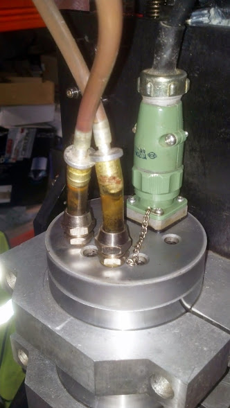

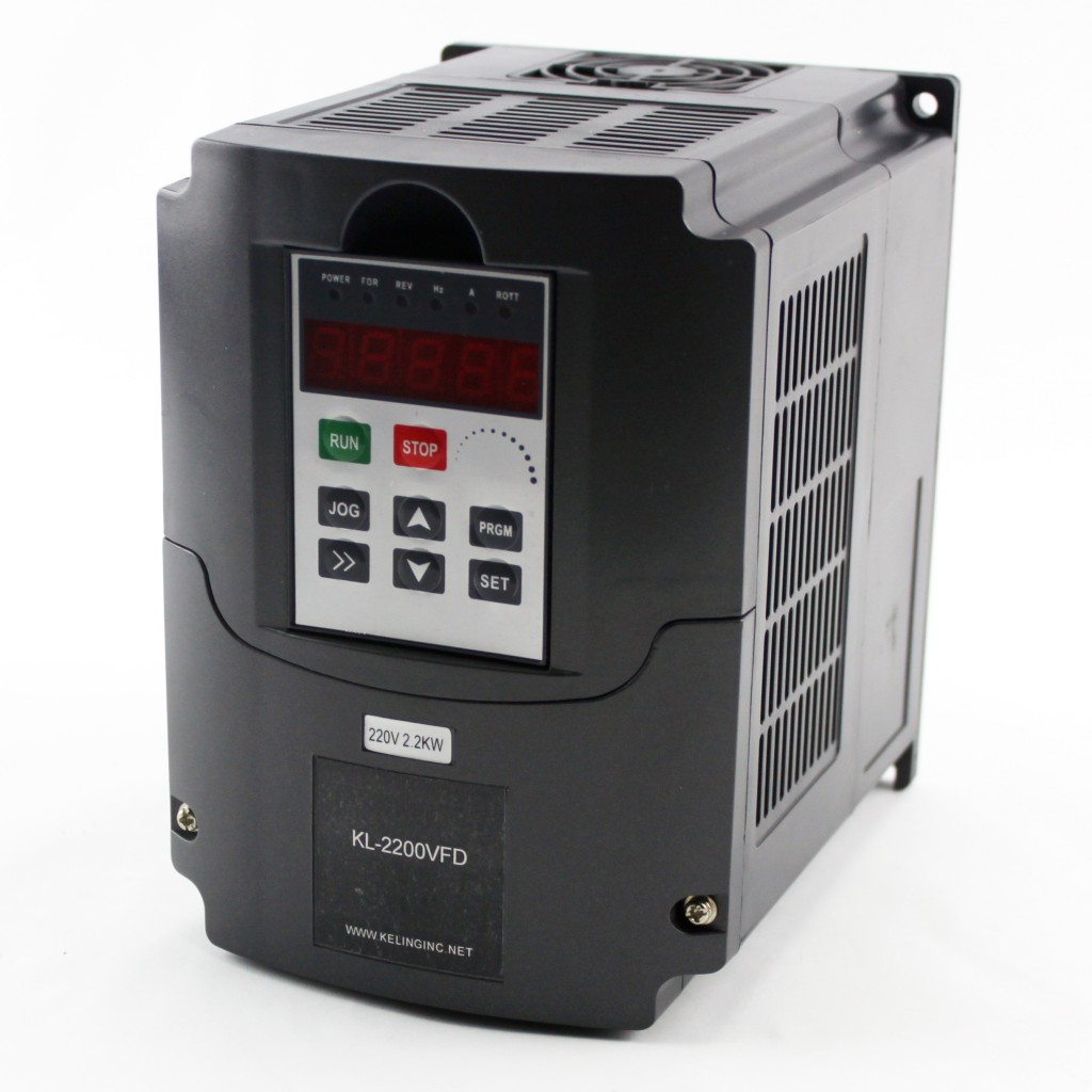

    The Photographs of the controller unit, and command - rznc 0501 are missing, but inside there is a unit similar to this one,Click image for larger version.
    I have some questions , especially regarding the 3kw spindle. Should i install new plastic tubes? In the picture you can see they are not clean, is it supposed to be?
    Does anyone have a manual? Where am i supposed to connect the two plastic tubes?
    I would like to hear your opinions about the machine, bring it on!
    What would you improve/upgraded?

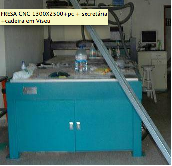

    Looks like it was here, in a job lot I think so price is for other stuff too ? no more info unfortunately.
    (scroll down the page a bit) Fresa usados, baratos para venda
  12. The Following User Says Thank You to EddyCurrent For This Useful Post:
  13. #9
    Eddy Current that's not what the Op asked or probably wanted broadcasting.! . .
    Shapebuster: Sorry don't know the make but Like others say it looks like chinese type machine but resonably well built, thou if that is the price then it's not really worth that sort of money unless it's fully working with Tool changer and Vacuum pump pump and even then I think it's not overly cheap.
