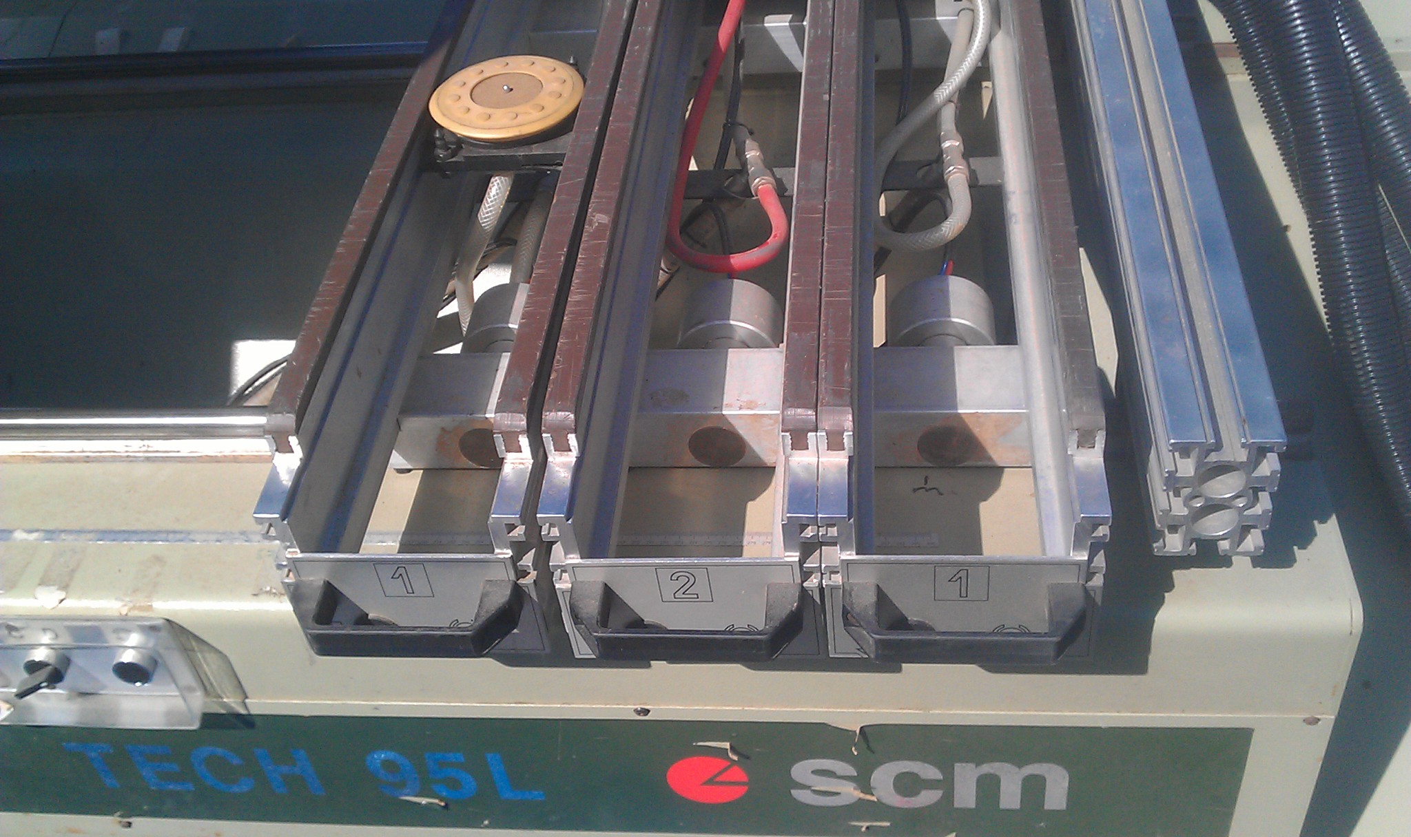

    am presuming these are vac locked, does anyone know if there is an easy way to release them without powering the machine

  7. #16
    I've used a machine in the past (Masterwood) where they were locked with compressed air. But they were free with no air, so I'm not sure. Are they possibly seized?

  8. #17
    I suspect its a reverse vacuum, and am looking for the release points. will give it a go by opening one point on one. There are release buttons, but they done seem to do anything when the powers off
