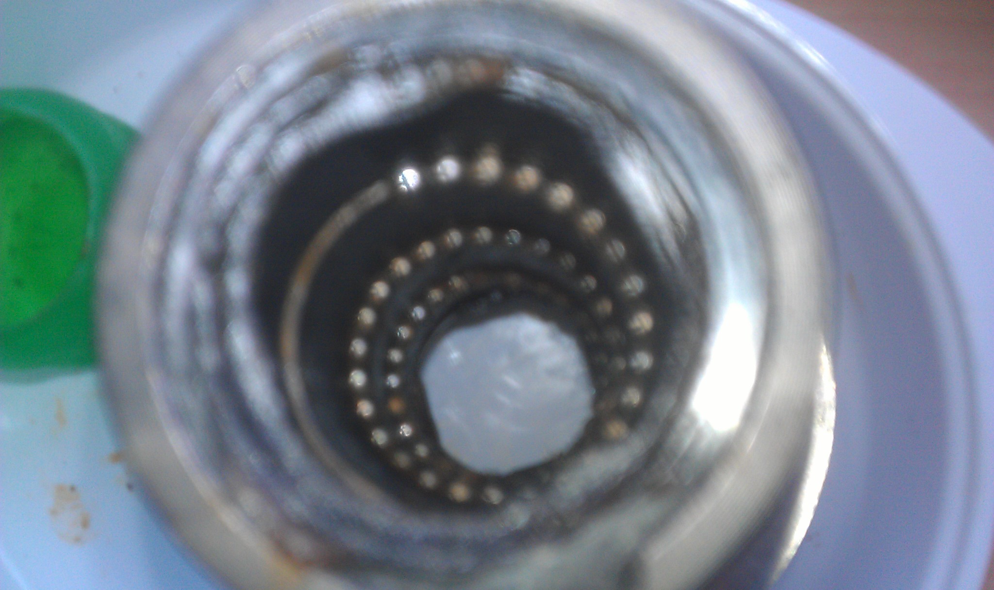

    Just before i start neew thread, in relation to the ballscrew...
    We seem to be missing a few balls, after stripping and servicing the main ballscrew, any idea of a good place to order them from if i can get the correct size... ( if anyone else servicing one of these scm morbidelli, it does not dismantle the way the service manual says, its more complete than it looks ).... any suggestions.

    Try Gary @ Zapp he may have some he can offer you.

    Here is the baring after a clean, about 10 balls misplaced, here is 2 of the pictures showing what we had to do to move it. we managed to get the cross section of that green bit down to 150cm to get it down the ally, still not sure how we made it. Good job that i have great neigbours, and no onew minded us closing the road off twice. ;->
