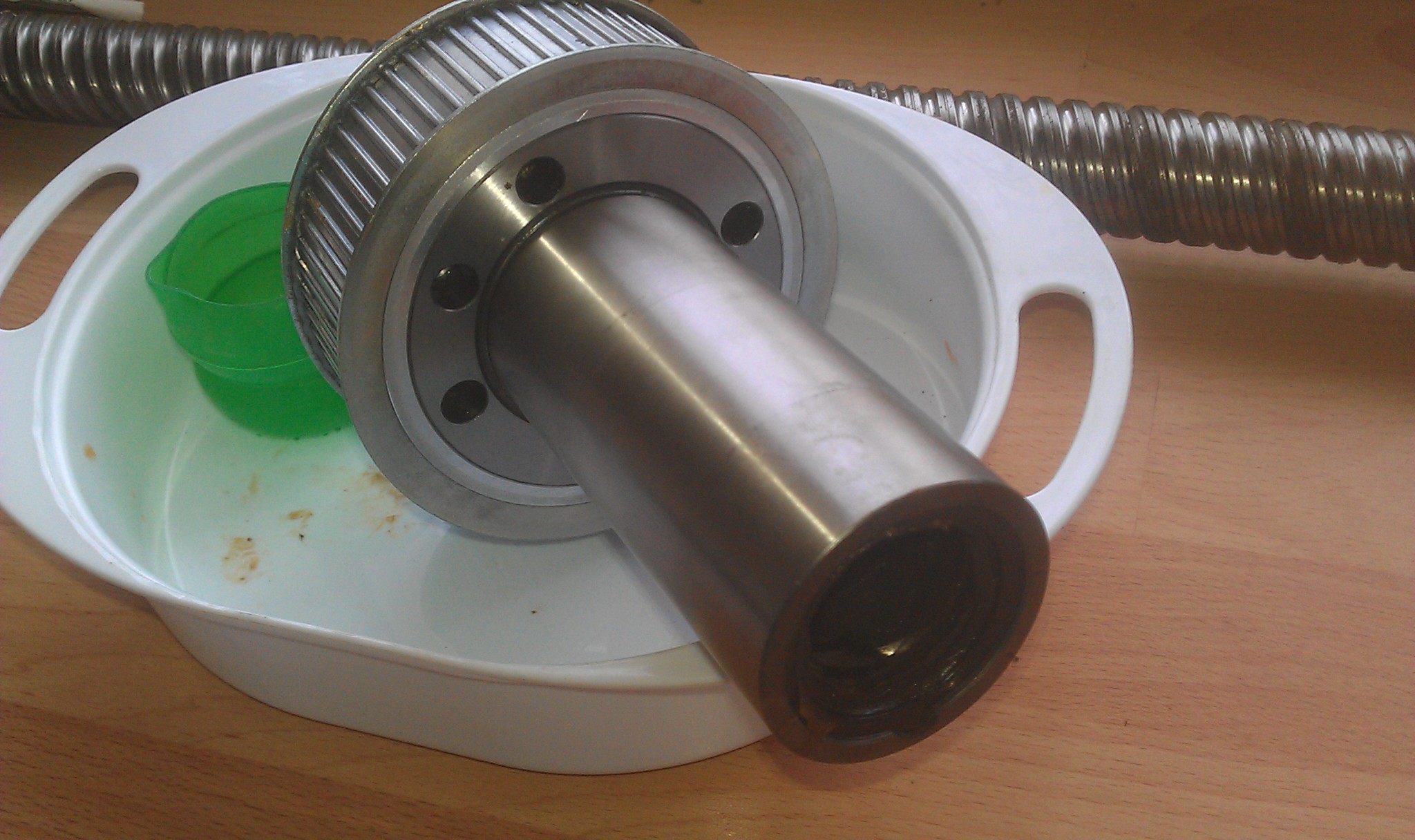

    Just before i start neew thread, in relation to the ballscrew...
    We seem to be missing a few balls, after stripping and servicing the main ballscrew, any idea of a good place to order them from if i can get the correct size... ( if anyone else servicing one of these scm morbidelli, it does not dismantle the way the service manual says, its more complete than it looks ).... any suggestions.

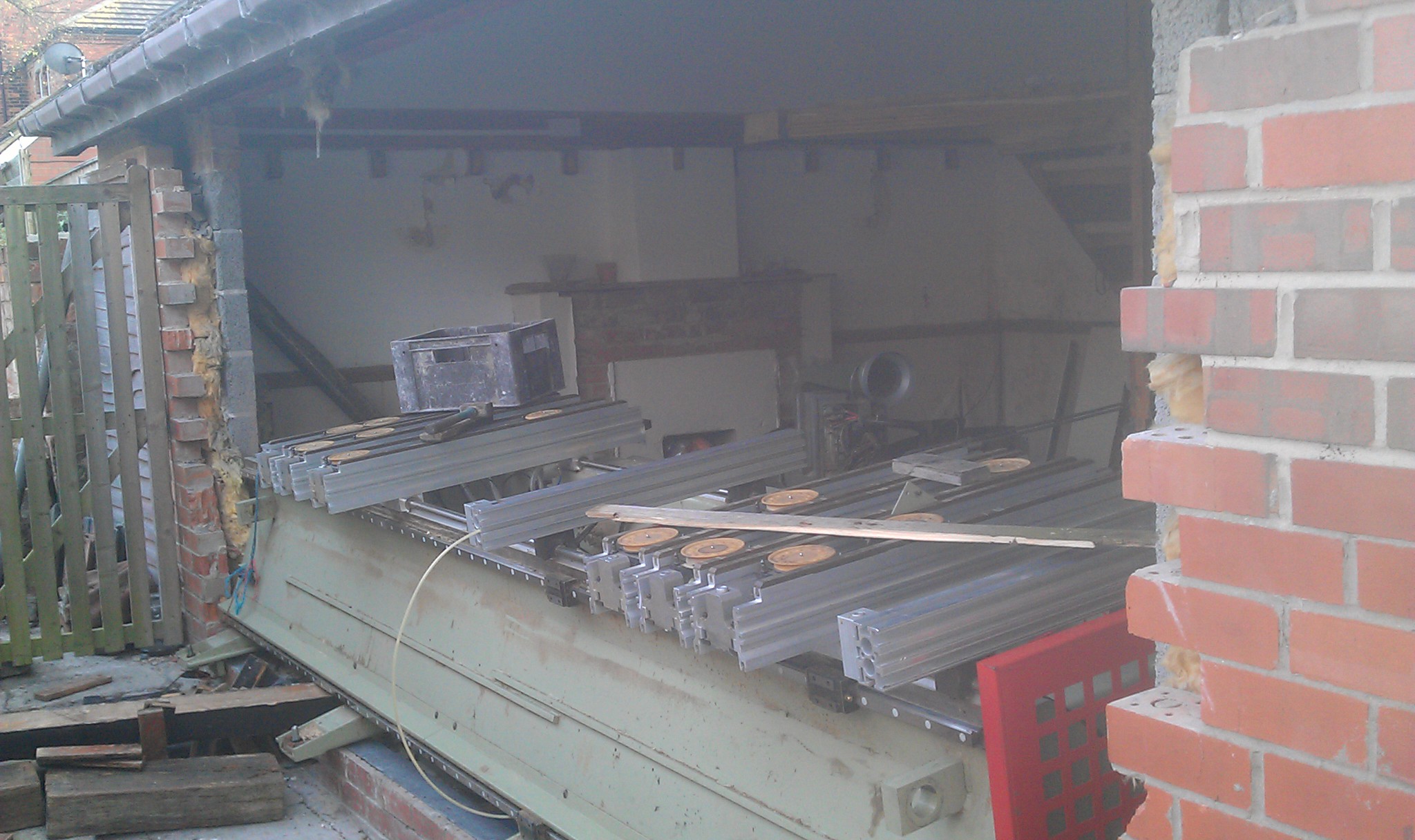

    Here is the baring after a clean, about 10 balls misplaced, here is 2 of the pictures showing what we had to do to move it. we managed to get the cross section of that green bit down to 150cm to get it down the ally, still not sure how we made it. Good job that i have great neigbours, and no onew minded us closing the road off twice. ;->
    Well we have seen people put cnc's in there spare bedrooms study etc. But into your lounge!! and not through the door that's what I call keen Good luck. ..Clive
  8. #38
    He he he, well, at least the council will stop asking why i seem to have a livingroom,bathroom,kitchen and bedroom in the workshop... ( somewere to chuck the kids when they were teens and stroppy )... We are just planning how to get a mill am bidding on in, i underestimated the width of this by 50mm and it caused loads of work..
