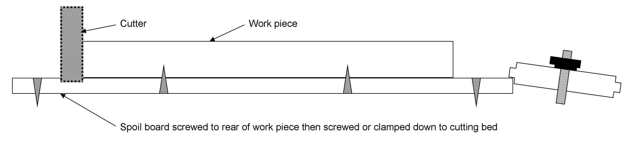

    Hi, as long as you've room and don't mind screwing to the back of the signs there is a very simple answer to your problem. see the image for more details, I've used this method on doors with hand routing designs as long as the customer is ok with a few filled holes on the rear. that's one of the reasons I'm building a new machine wide enough to hold down without drilling.

    Thanks for that but holes in the back would be a problem

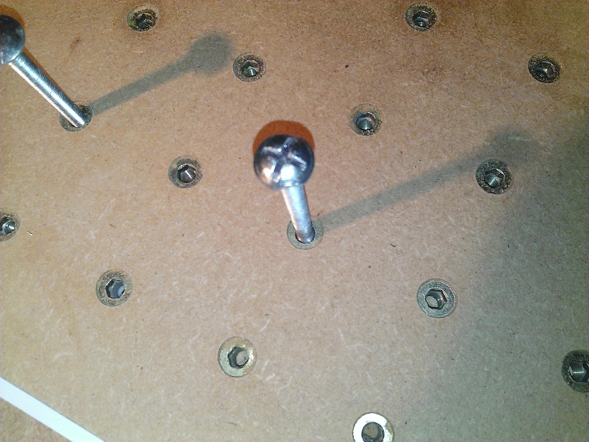

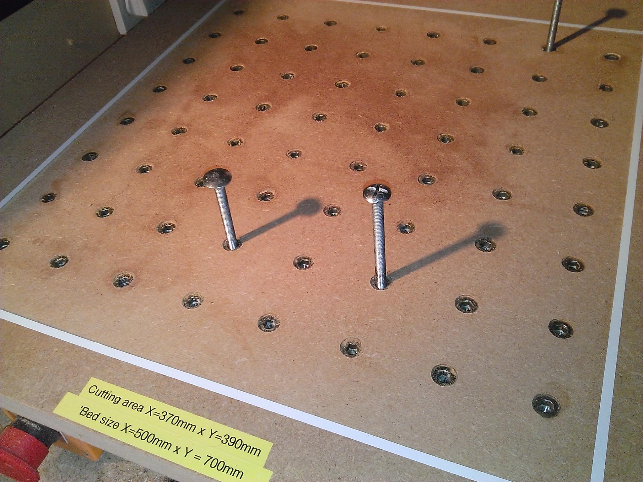

    Well after much research and advice I have gone for 6mm nut inserts on my new bed and I must say I am very pleased so far,
    how long these will last is another story, inserts from Screwfix £2 for 50, MDF board £4 so not a great capital outlay, if it all goes tits up
    I will use clamps along with DST for a firm job

    If you screwed them in from bottom it would stop them pulling out.!! That said the MDF would probably bulge anyway.
