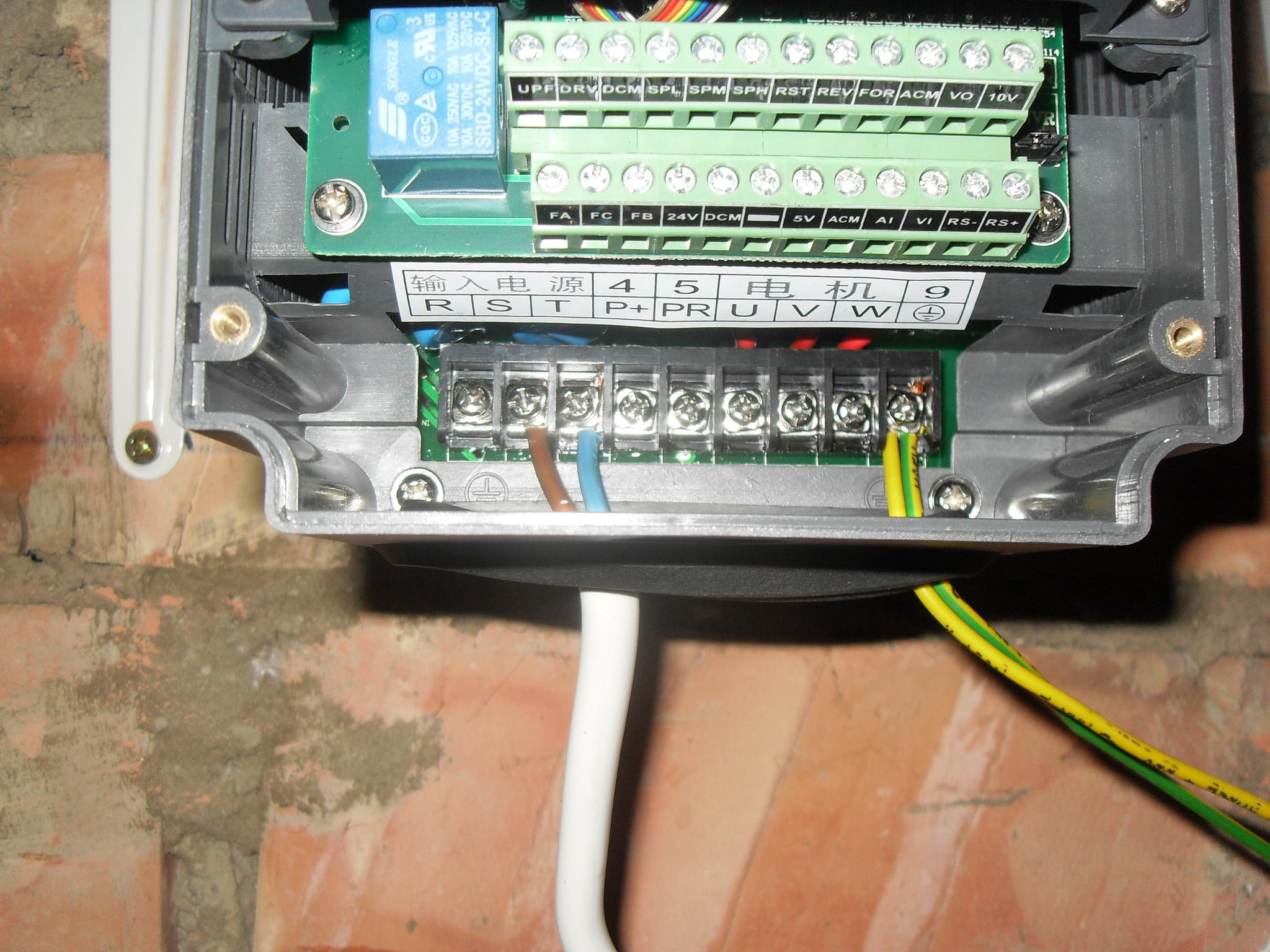

    Yes, I tested everything - there is a live wire going to "R" terminal (tested with one of those screwdriver lights) and neutral to "S" terminal, as well as ground to ground. I will test it with spindle connected in next few days, but I would think that at least power LED turns on when you apply mains, it's not like I am pressing run button or anything.
    EDIT: I attached manual page that came with FVD. My pin layout is like the one in the red box. Question is, perhaps I need to connect P with Pr?

    Just tried connecting neutral to T and pretty much all possible combinations with those 3 terminals, non of them worked unfortunately. Just to make sure I am not missing something I added my connections:
    Just to clarify, I also tested voltage across those two wires - 222V, so no problem with my connections...

    What are those P and Pr for? In manual it says "Connector for braking resistor", maybe I need to add one? If so, what size?

    I think you've tried every combination except the correct one! For single phase you needed to wire up:
    R = brown (live)
    S= (not connected)
    T = neutral (blue)
    9 = earth (yellow/green)
    P/PR not required to get it running - these are if you want to add a brake resistor to quickly stop the spindle. Useful in a production environment where cycle time is money, but for DIY user this is not required.

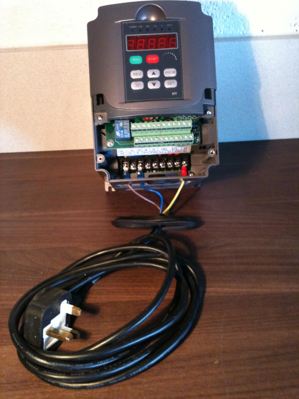

    Here is my unit wired up:

    If this powers up then you then need to set up all the parameters. Some time ago 'Husky' collated all the useful info on that so have a search.
    Last thing before attaching spindle - it is worth just a double check across any pair of leads to your spindle to check there is a few ohms of resistance. If all is well then connect the 3 spindle cables to 'UVW'. The order does not matter. If once it is all working you ask for 'forward' and the spindle goes in reverse, then swap over any PAIR of UVW cables. Obviously switch off before you do this.
    Routercnc is correct I have re checked mine and it is indeed R and T for the mains. No link on the braking resistor terminals.

    In manual P and Pr are connected, does that mean that I have to connect them or are they internally connected?
    Seems like it is just faulty FVD and I will have to have my money back...
    Any other suggestions what to check or what to do to get it working?
