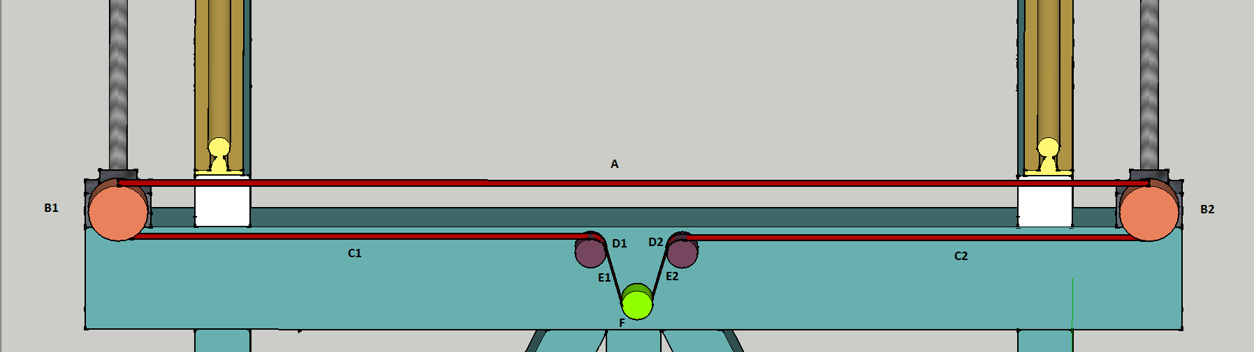

    Couldn't find many cnc's using timing belts for synchronising axis. So I attached what I came up with.
    So the beech colored ones are P32-5M-15F (32T) and the green one is attached to stepper using P18-5M-15F (18T)
    If my calculations is right I need around 2380mm of 15mm 5mm HTD timing belt.
    A = 940mm
    B1 = B2 = R*pi = 50.93*pi = 160mm (assuming half of the belt is on the pulley)
    C1 = C2 = 430mm
    D1 = D2 = 0.5*R*pi = 0.5*25.46*pi = 40mm (assuming 1/4 of the belt is on the pulley)
    E1 = E2 = 50mm
    F = R*pi = 25.46*pi = 80mm (assuming half of the belt is on the pulley)
    So the total length: A+2*B1+2*C1+2*D1+2*E1+F = 2380mm
    The problem is that there are only 2525mm or 2000mm available from here. So I guess I will have to fiddle a bit.
    And does anyone knows where to get these rotating pulleys (purple on drawing), at least the proper name for them?

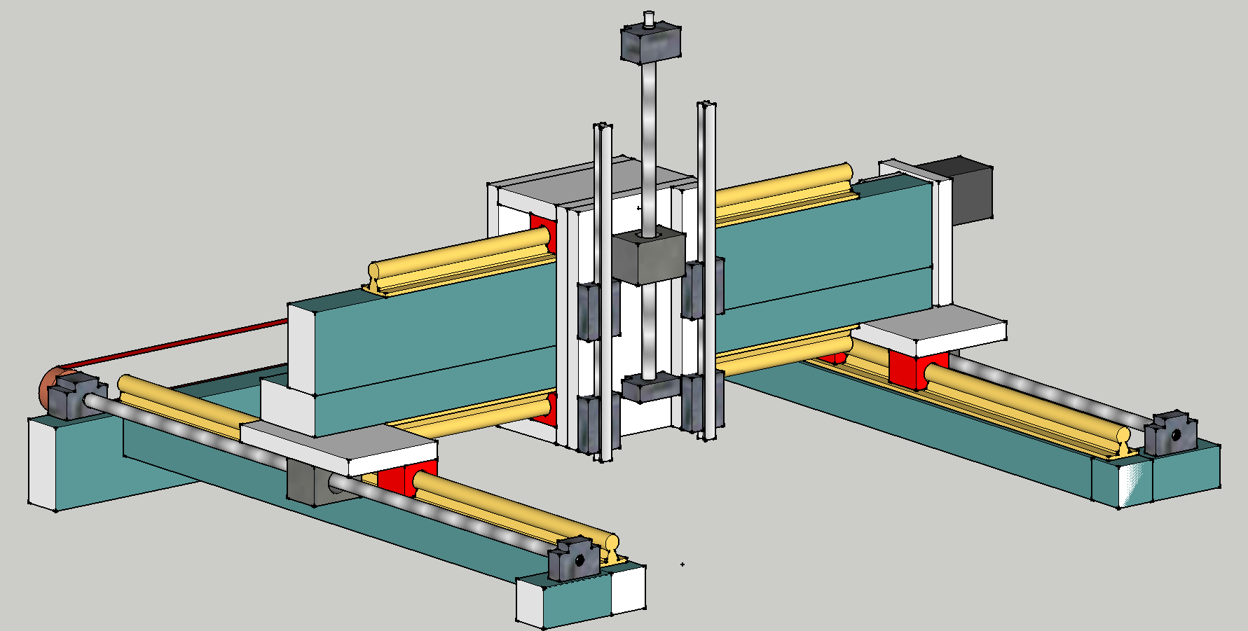

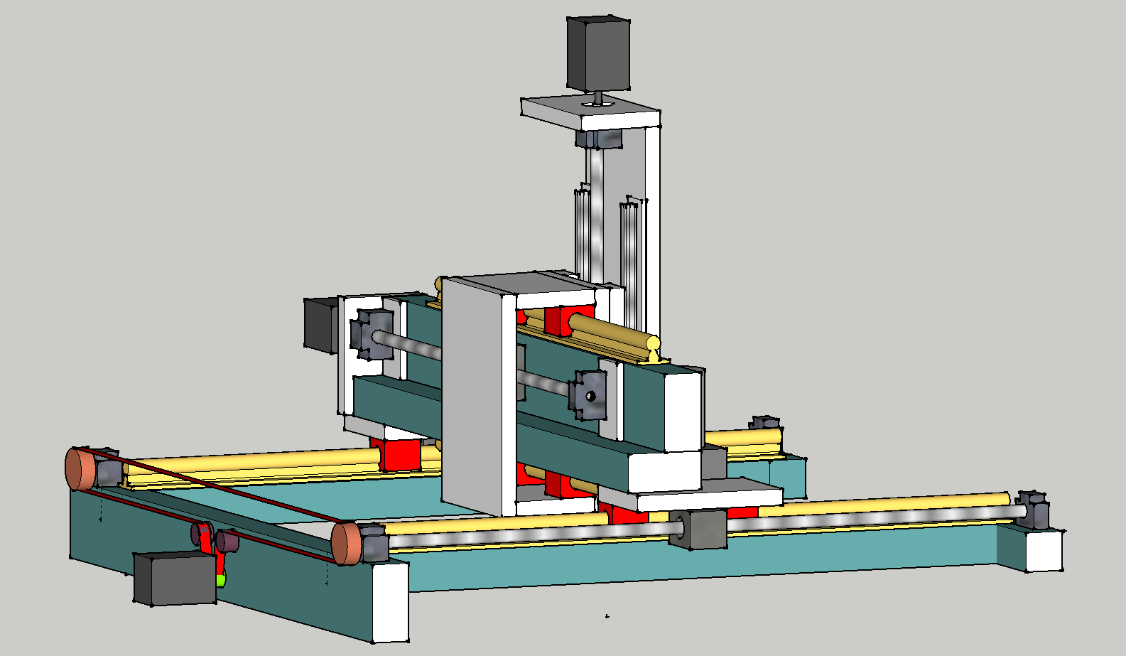

    Have you thought about how you are going to mount the rail blocks to the frame, for instance the X rail blocks appear to be mounted to the gantry without access to the bolts. I would also wait until the clever people check your frame out and lack of table I noticed that you are ordering 5mm screws all round!! just bringing this to your attention ..Clive

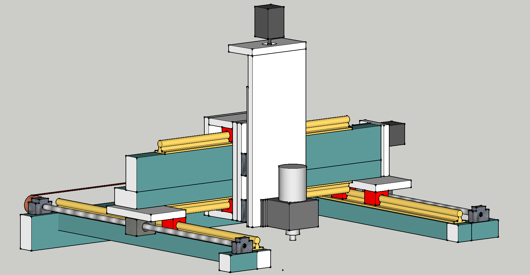

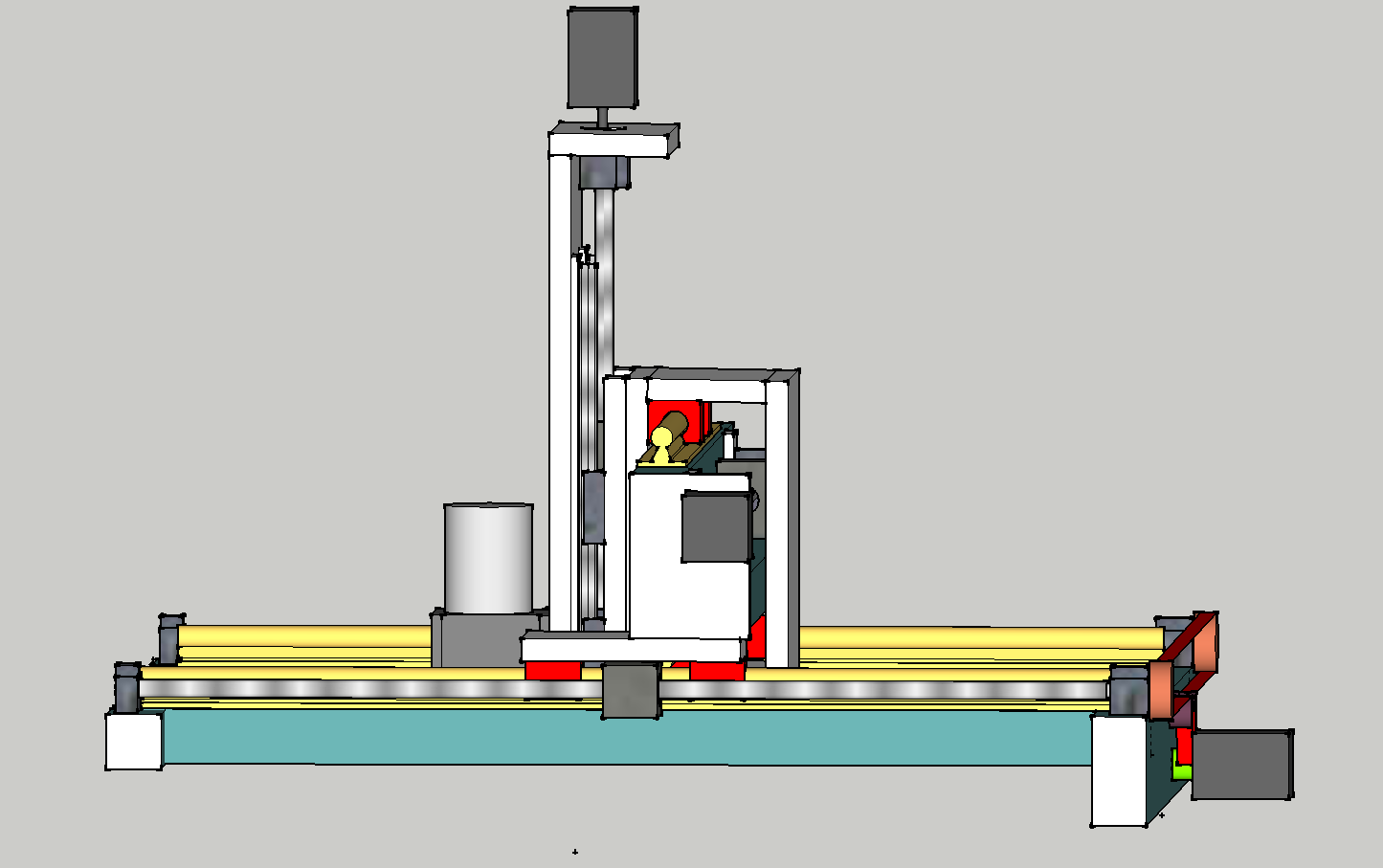

    EDIT: ok I realised I want the frame to be as simple as possible, so 100x50 steel box sections for Y axis makes more sense. Those white plates are supposed to be aluminium 20mm thick. Ignore the missing underneath structure.
    Anyway, this is what I came up with after ~14h of browsing through hell lot of designs. Feel free to comment on any mistakes.
