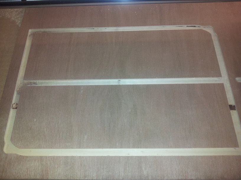

    So doing some mild pocketing in ply... this is meant to be square

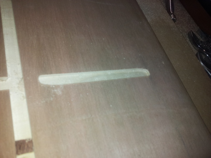

    see how its rounded the edges of two of the corners but not of the other two?
    this is compounded, by the other pocket its doing on the same job has done the same thing

    It must be something physical with the machine rather than software because the toolpath looks fine in vcarve

    only thing ive changed today is... ive tightened the belts... but it jogs around fine.... and ive increased the acceleration on X
    ANY ideas will be welcome... im scratching my head.
    looking at both the photos X is vertical... Y is horizontal

    By 'meant to be square', do you mean it's meant to be a square, or that the corners are supposed to be sharp? If its meant to be cutting squares and you get that, then at least part of the problem is the step/mm value in the motor tuning settings has changed...so check those. On your machine it should be the same number on X and Y and two times that number on Z.
    CORNERS MEANT TO BE SHARP
    BOTH X AND Y STILL SET TO 80

    SO WHILE WAITING FOR MY KNIGHT IN SHINING ARMOUR... IVE REDUCING THE ACCELERATION RATE OF BOTH x AND Y TO 2500.. NOW IT GOES VERY SLOWLY, IT DOESNT CUT THE INSIDE OF THE CORNER LIKE THE PICTURE SHOWS MY INITIAL RUN DID, BUT IT DOESNT SQUARE THE OUTSIDE OF THOSE TWO CORNERS EITHER.. IT KIND OF CUTS THE CORNER. IM VERY CONFUSED.

    If the acelleration is far too low and you're using G64 (constant speed) mode, then your corners will all get rounded... but it would have to be very low for that to happen. 2500mm/s^2 is pretty high (sure that's not the rapid feedrate). You could try putting G61 at the beginning of the code to force the machine to stop at each co-ordinate precisely.
    Where you've tried to cut the slot, parallel to Y, it does look like one of the X motors has lost position and skewed the gantry, causing the subsequent cut to not be parallel to the first. Are the pulleys definitely tight and not slipping on the shafts?

    However if you look at the picture it cocks up on opposite corners, assuming the picture is taken from the front of the machine then it barfs out when the Y changes direction so I'd check couplings, pulleys belts etc, anything to do with the Y axis mechanically
