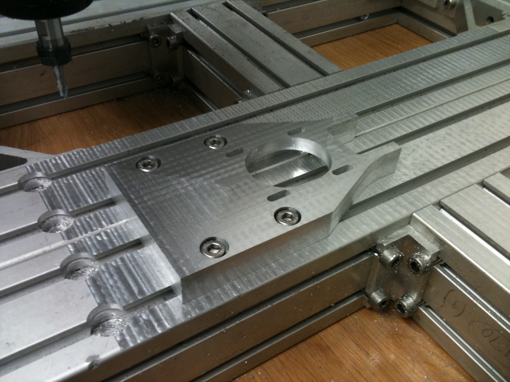

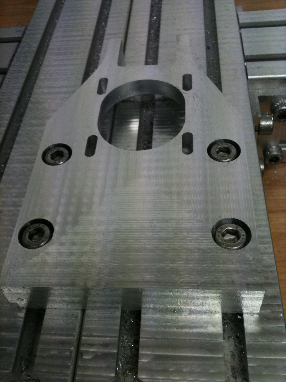

The 5th Video is probably the best one with the two 5mm deep pockets being cut - the noisiest thing in the room was the compressor, but I have made some horrendous noises previously when F&S have been wrong, misting not running properly etc. Oh the description for that vid is slightly wrong as the previous vid was an 8mm Carbide Single Flute and the 5th vid uses a 6mm End Mill @16439rpm, 2mm DoC, 539mm/min.
I'll back Jazz up and recommend ramping for single flute cutters - I've broken the tips off of a number of them by plunging and I tend to find if you have to plunge try and set that in your CAM software at ~30% of your normal feed rate.
One of the things I found frustrating is the CAM software I am using, as Vectric's Cut3D and 2D does not always consistently apply ramping and in the case of Cut3D doesn't give you a ramping option at all. I am mostly using Deskproto now which does apply ramping, but only if there's enough room on the first move, but at least I can force it to plunge if there isn't at 30% feed.
I'm still learning myself and will post more vids as I progress and if you want to see something really cool look at Jazz's video of his machine using iMachining trochoidal toolpaths - that stuff is amazing (one day I'll be able to afford that :-) ).

Just wondering why you didn't climb mill the 5mm pockets in the vid. Don't take this as a criticism as I bow down to your ability to self build such a nice looking machine. You would find yourself with a longer tool life though if you did all of the 5mm in one pass and cut the pocket using 30% step over. You could increase the feedrate then due to the chip thining so you would have a nice increase in material removal rate. I understand that you are not looking to lash off 1000 pieces so time probably isn't a bit deal but it would be better to let the whole tool wear a fraction than the bottom 2mm wear while the top section does no work.

Yes when you've used Trocoidal toolpaths you really don't want to go back to normal milling. Like Washout says I use i-machining (mostly for roughing) and it's unreal the material it shifts and time it saves even with my low powered spindle and DIY built machine. To watch it dance and chomp 6061 T6 @ 20mm depth between 2500 & 3000mm/min and do it with ease is amazing.

At that point I needed the parts off of the machine without mishap, as they had to go on the race car as one of the first bits of assembly, as they sit between the monocoque and the front sub-frame (replacing bonded ali and silly putty....I mean rubber OEM parts ;-) ). I also had limited amounts of 40mm 6082, so I needed safety and the machine was not long up and running at that stage. Conventional was quieter and I figured less stressful than climb, but I do use both these days and I hear you on the wear at the tip, but I have managed to tune my F&S's, using GWizard's help, to the point where (touching wood) I'm getting much better tool usage than I used to.
