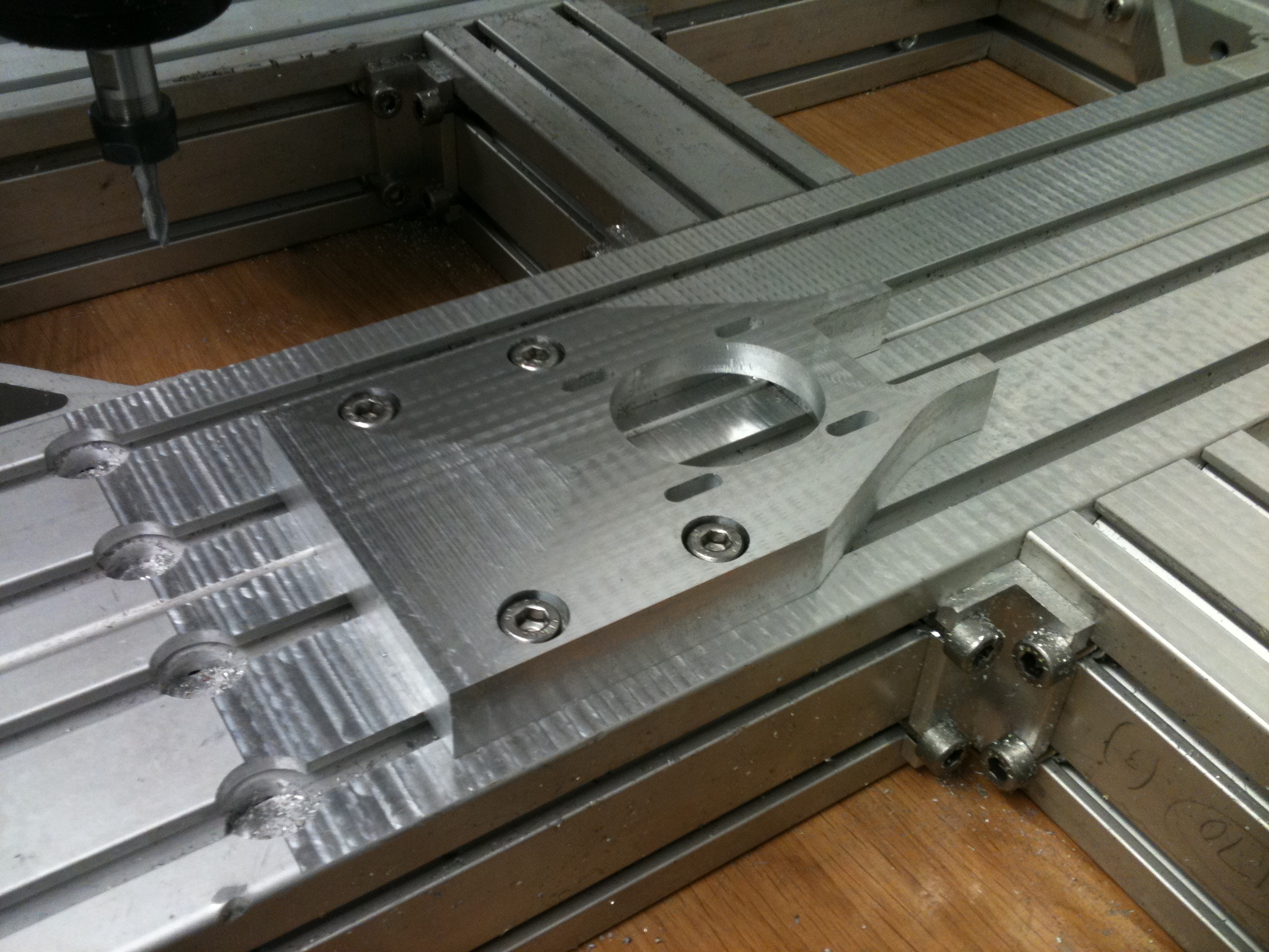

    I recently cut some elongated slots with a 3mm carbide bit without any problems. I don't use the 3mm cutter much (tend to use 6mm) so haven't experimented but the following settings worked OK:
    DOC 0.3mm
    rpm 12,000
    300mm/min feedrate
    30mm/min plunge rate
    The 4 slots were 5mm wide, 15mm long, and 10mm deep (other side is pocketed 10mm). See photos below.
ID:	12324 Click image for larger version.
    (I was actually surfacing the whole part in this photo - hence the 6mm cutter in the collet, not 3mm, but you can see the slots I was refering to)
    I flooded the holes with duck oil as soon as cutting started. There was no smoke, no screeching, just a soup of very small chippings swirling around in the pocket as the cutter did it's job.
