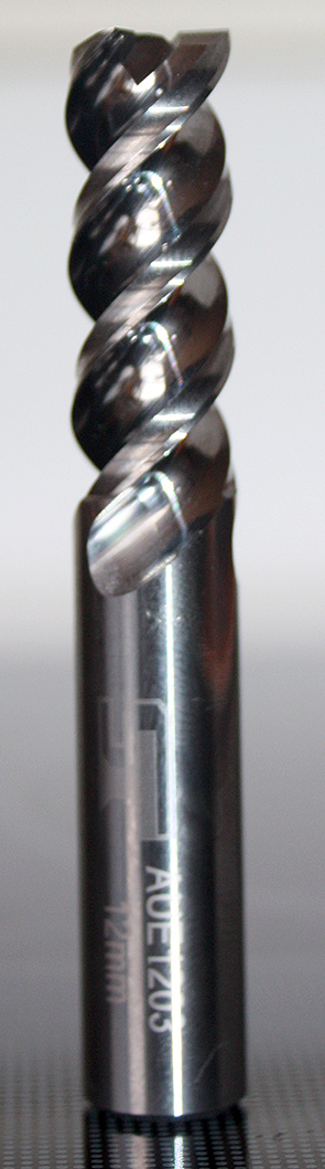

  4. Hi silyavski,
    Here I made a picture of AUE1203. Take a look and let me know what do you think.
    I will just mention that this tool has polished front and back cutting surfaces. To be honest yes, I am selling these tools, but I can assure you from the user point of view that these cutters are better than many world famous brands, which I will not mention here.

  5. #45
    These you show are 3 flutes and seem nice. But I believe here people/DIY, forums/ would be more interested in your AET series 2 flutes, cause they can be used also for plastic and wood, or at the long ones .
    Now other thing is the price and place of origin.
    Its difficult to convince people to buy something not made in USA or EU. At least me. Especially at similar prices. Thats the truth. I see many sellers /China, Taiwan, etc. / raise their prices and make them comparable to the famous brands. But reality is that a typical small business will search for discounted known brand,overstock sale, a deal or a clearance and will not buy 3rd brands.
    Hell, i would not buy, even try other brand carbide router bit while Drillman sells Kyocera bits at ebay, especially at his price. I don't see how sb. could beat him especially for the DIY people market -plastic, wood and aluminum. 1-6mm. Kyocera also have representatives in Eu. Do you know why no body has ever heard of them? I will tell you. Cause they sell for 20euro the 6mm stub 2 flute that Drillman sells for 6$
