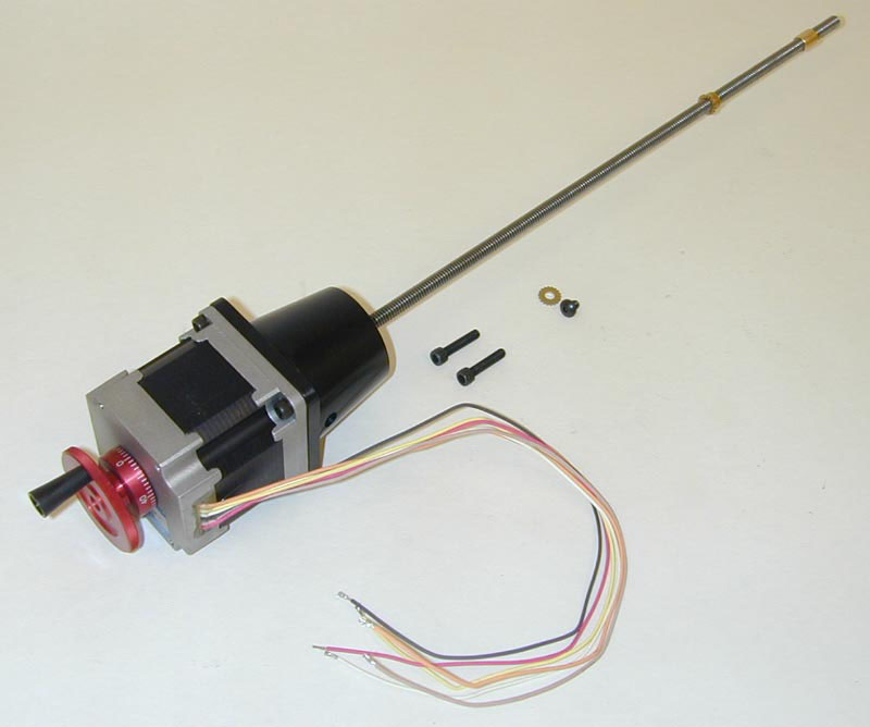

    To those that have suggested mechanical options then YES I know this and I can even push bloody the axis if I wanted but that's not what I want so please don't go there anymore it will only take the thread off at tangents.!
