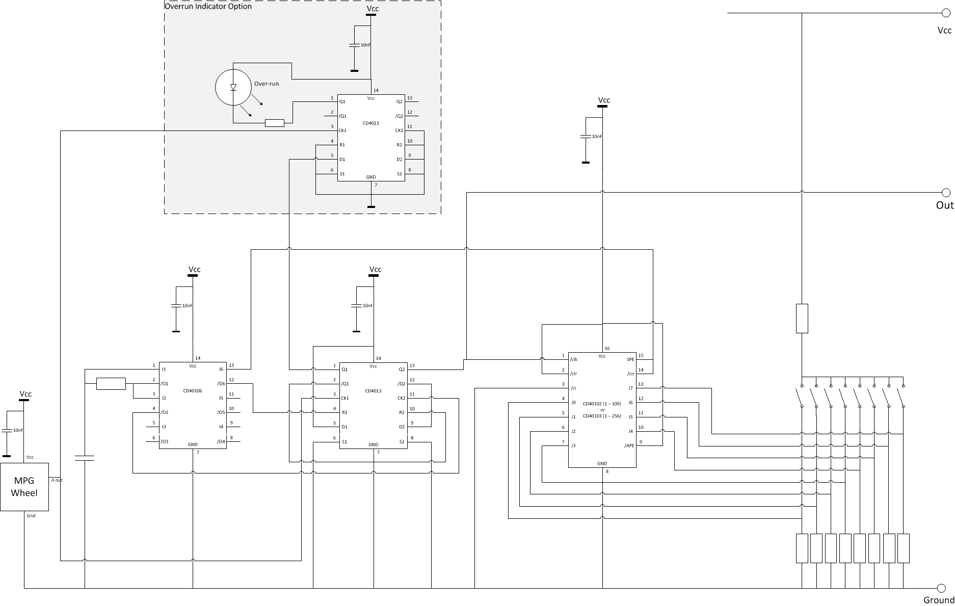

  6. OK, here's version 0.1 for discussion....

  7. #47
    Tbh my approach just generates n pulses for each wheel pulse at a rate that's fast enough to finish before the next wheel pulse.
    As touched upon earlier, the 'jitter' this adds to the pulse stream will reduce the maximum feedrate somewhat as the motors wont run as smoothly. How much is hard to say, but it could be a problem...
    Direction required?
  8. #48
    More and more it looks to me that the best approach is a mechanical step-up! Trying to multiply the number of pulses electronically is inherently the wrong way to go.
  9. #49
    Fix the mpg down on a board and mount a larger mdf wheel next to it on an improvised pivot. Use a wide rubber band as a belt . Should be relatively easy to get a 5:1 step up.
  10. #50
    Quote Originally Posted by JohnHaine View Post
    Better still, connect the rubber band to the stepper motor to get a closed loop system. I'm sure you'd get positive feedback for that idea ;)
