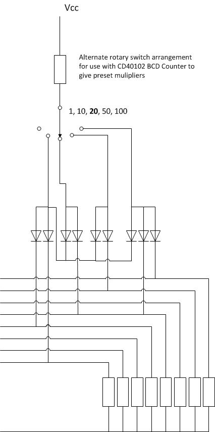

  2. Added option to replace DIP switch with rotary for presetting step multiplier rate.

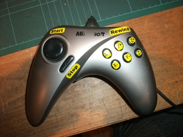

    But in mean time please keep giving the suggestions but just remember only needs to be simple doesn't need any thing fancy I'm not after accuracy or any kind of CNC pendant.!!
    How about a USB games controller like this. Mine cost me nowt, uses keygrabber and the biggest hassle was putting the labels on the keys.
    Nope.!! . . . . Remember NO PC involved.
