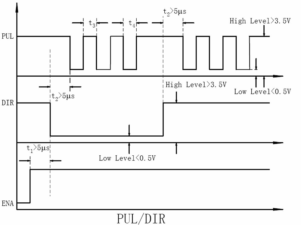

    The AM882 manual has this diagram, and it says
    "In order to avoid some fault operations and deviations, PUL, DIR and ENA should abide by some
    rules, shown as following diagram: "
    So will a simple controller also have to obey these 'rules' ?
