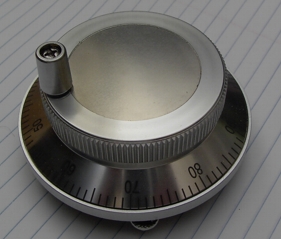

    Yes all I want is to Jog one axis at a time for testing purposes so can run machine thru it's travel quickly when no electonics are connected. I've got a spare drive and MPG wheel and just want a cheap way to increase the distance traveled per click, IE step multiplier.
    I've got a Raspberry Tart and could use that but don't want to as I want it simple and I've got another use for that.
    I could buy drive with Pulse generator built into it but don't want to as I have perfectly good drive sitting here that I'll never fit to a machine.
    Currently I've got the MPG connected to the drive and it works fine so I didn't think it would be a massive electronics project or expensive to create a step multiplier just to speed up the travel.?
    Thanks to those that pointed out the products that are available to do this and I did know about them but don't want to buy one, I want the experience of doing this and I'm sure it could be done for under a tenner.! . . . . If not then I'll not bother as I've loads of alternatives.

    Thanks Irving. Yes would like to keep the detent control of MPG. I could live with Fixed multiplier but would be nice if not too much more trouble.
    It's a 100 pulse per turn MPG so at minute it's 2 turns for one Rev of stepper. I mostly work with 10mm pitch screws so it would be nice if one turn = 100mm so say x 20 Multiplier. Idealy 10, 20, 50.

    Dean, can your MPG be set to 1 pulse/turn? Because a pulse multiplier needs to fit n pulses into each pulse from the MPG. If that's producing a sequence of fast pulses followed by a longish gap then a simple add-on hardware multiplier is going to struggle and the software solution is more practical.
  10. #20
    No it's only the MPG wheel not a pendent so just one pulse per detent. 100 detents per/Rev.
