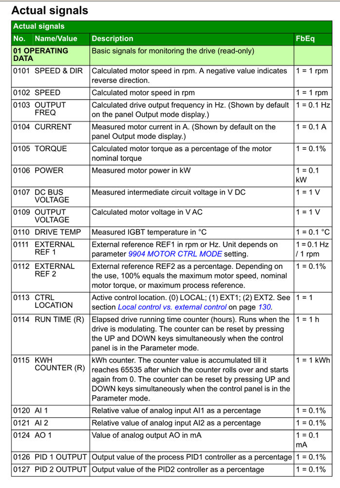

    These are just some parameters available in the ABB ACS355 inverter for example, torque, current, speed are there, a Fieldbus interface could be used to read these.
