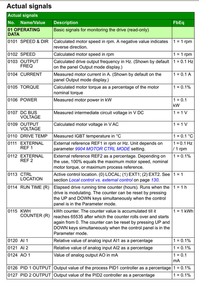

    I used a similar idea about 15 years ago on a large saw for cutting steel, we converted the machine from relay control to PLC. To enhance the design I came up with the idea of measuring the saw motor current combined with rotation speed and carriage feed speed, the main drivers being to increase throughput and detect when the saw blade needed changing for resharpening. It never got implemented.
    These are just some parameters available in the ABB ACS355 inverter for example, torque, current, speed are there, a Fieldbus interface could be used to read these.
