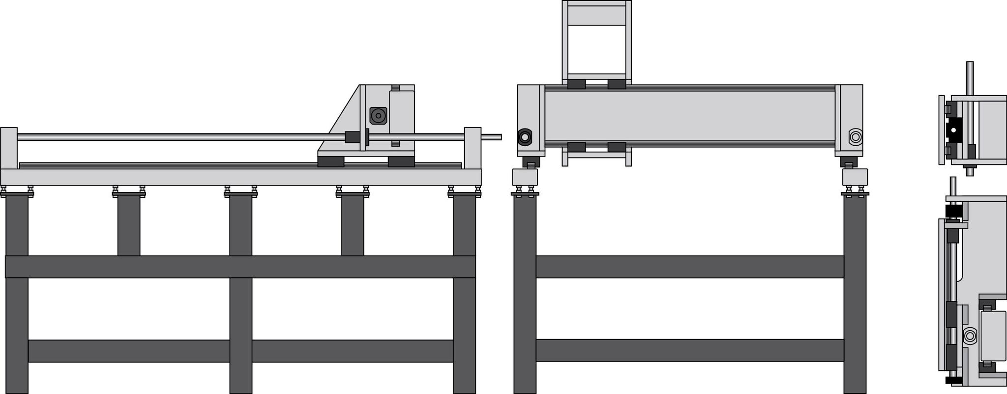

    This is a good diagram I think to explain positioning of parts Do it yourself CNC router: Design Considerations, the Gantry

    a design I'm trying now (based on a cnc I've seen) is to use 90x60 aluminium profile, heavy duty, which will hold the rail and will be linked to the steel sub-frame at 5 plates along its length - each plate will have 4/6x M10 stubby bolts to allow me to make fine adjustments to the level.
    Ive be attached a pic of the design in progress with this system - probably pretty confusing - I'm not using any regular design program, only what I'm used to, illustrator... But with some inspection would give a rough idea of where I'm heading... Anyway, it's certainly not finished, once I'm finalised on the equipment, I will modify the design to suit...

    The gantry you have drawn will need some bracing on the bracket holding the ballnut or much thicker bracket.
    To be honest I'm not a fan of the place you have put the ballscrew as it's in the firing line of chips and is fulnerable to damage being high up and exposed.

    Regarding the gantry sides, I am using 20mm alu as the bracket, I thought this would be plenty rigid enough based on other designs I saw - how would you size it different?
    the location of the ball screw - I accept your opinion on this... My thought was because at the max depth I'll be cutting just PU foam, and this is far below the ballscrew it should be ok, and in a simple location build-wise...
    Where would you try set it otherwise?
    20mm is ok-ish but I'd brace it more. Don't under estimate the power of steppers connected to ballscrews. If the cutter jams for any reason but doesn't snap straight away, which does happen with thicker cutters, then something will bend and those plates are directly connected to the screws so are first on the list.! Closely followed by the Z axis front plate( I've seen my front plate bend many times)
    It's a personal thing and while it's in simple location it's in a vunerable location for getting leant on or against while leaning into machine, crap hitting it etc.
    Tucked in at the sides lower down with some form of cover.
