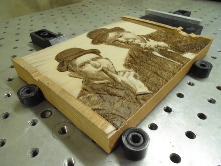

    We tried something new that has been planned by us now for quite some time. Me and my son 3D spindle engraved a Laurel & Hardy height map greyscale with a 1/32" Ball End Mill with a 1/8" depth. We then laser engraved shades on it with analog modulation from the original image afterwards. We combined the gcode movements generated from Picengrave Pro 4 + Laser using both images to accomplish this. Our Dual 445nm Laser Diode's intersecting focal points follows the spindle engraving's contours up and down to maintain focus on the surface. This is the very first time ever trying to do this.

    Now that's what I call a laser ! it takes pyrography to a new level
    Thank you,
    It was a fun build and project, that's for sure. We can actually laser engrave shades on wood, mirrors, artist canvas, leather and something painted white with our 445nm laser diodes. The white paint and white leather gives us the closest to 8bit shading. We are experimenting all the time on different kinds of materials and processes.

    Thank you. Yes, me and my son built the laser head using two 9mm Nichia 445nm diodes with two Flexmod P3 drivers. It has a total of 4.5W max power, but does not have enough power to engrave on stone. It was a one off build, so no plans are available.
