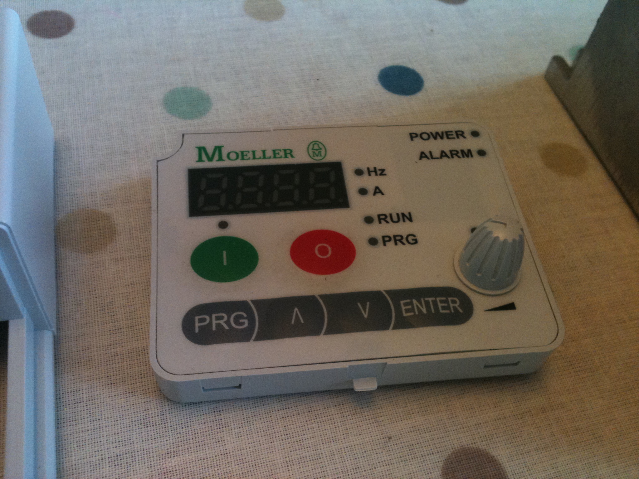

    I know the risks with these units and the most popular 2.2kW unit seems to be the HY02D223B. I also noticed that they make a SL-222EE model which shows Vector Control Drive as a feature, and has also been shown with an optional removable front keypad panel and connecting cable. This panel can also have a pot added to it to manually control the speed. This would make it the same as my Moeller drive for which I was about to mount the keypad in the control box door. Anyone bought and used one of these models with the Chinese spindles?

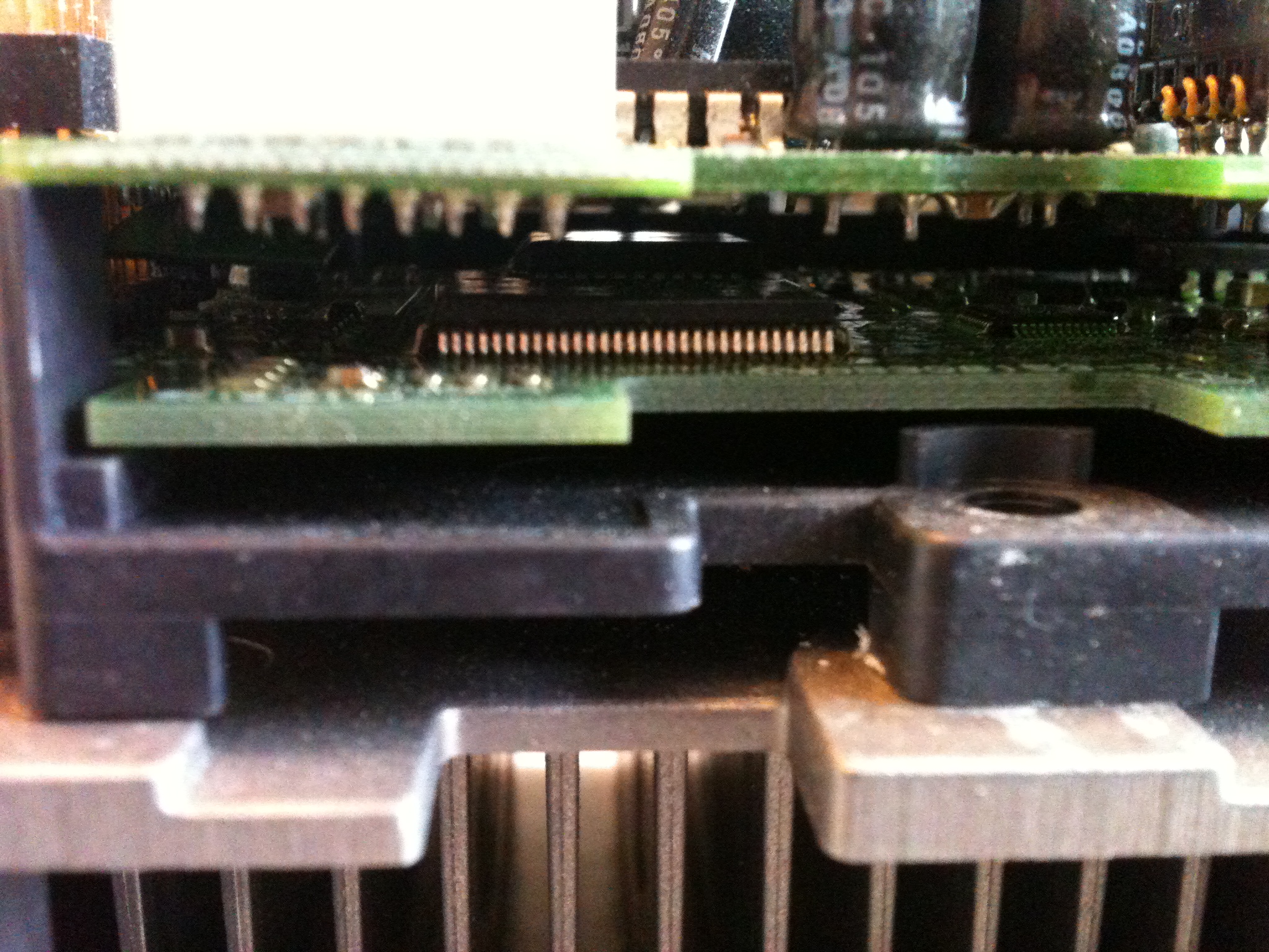

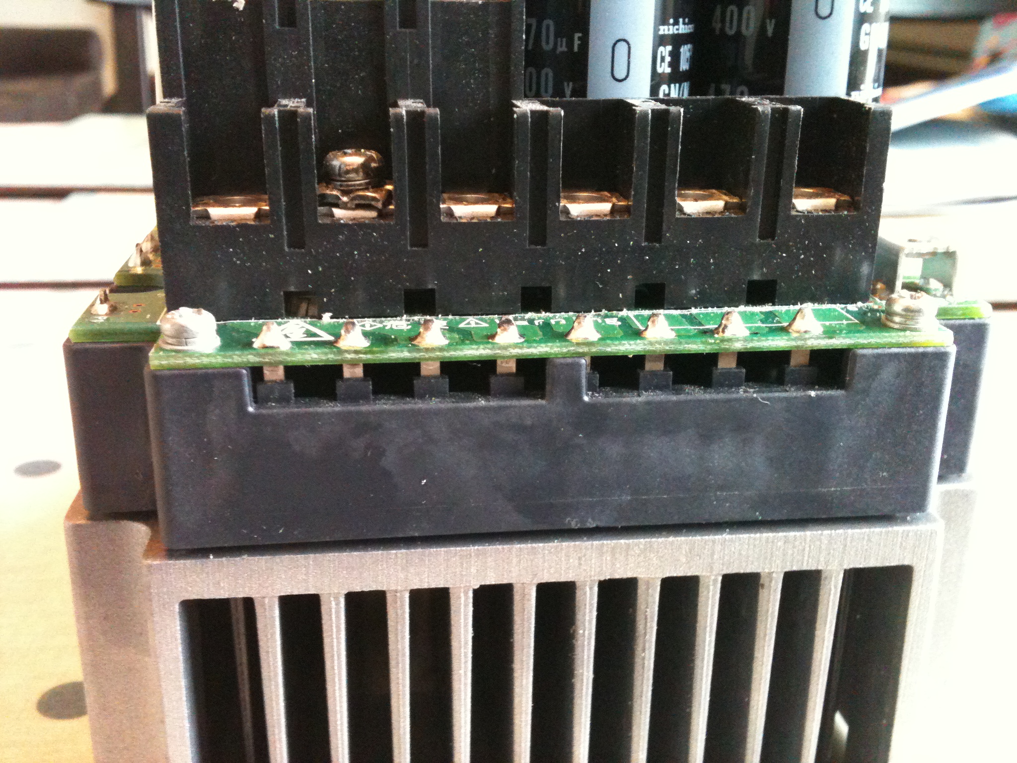

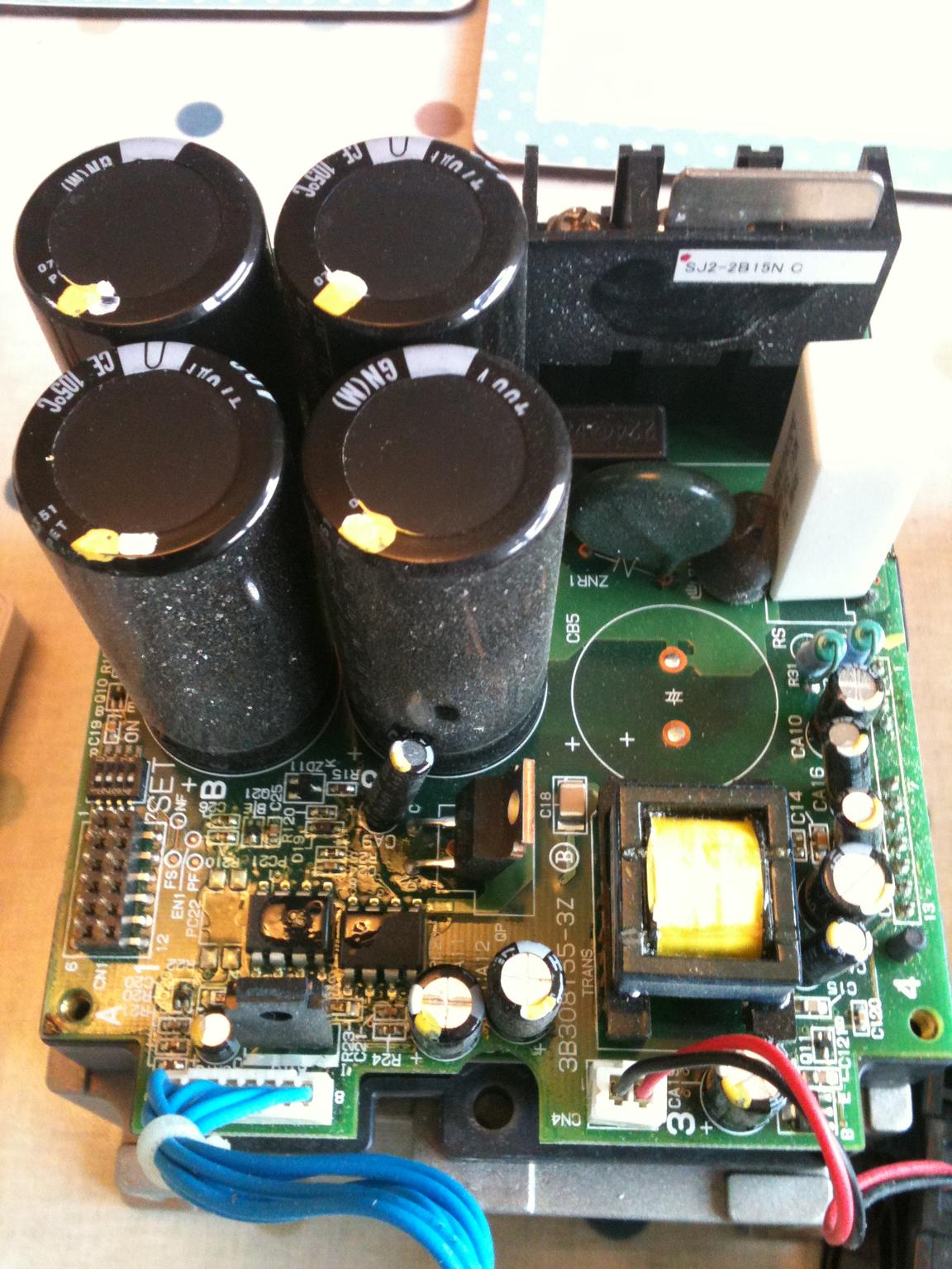

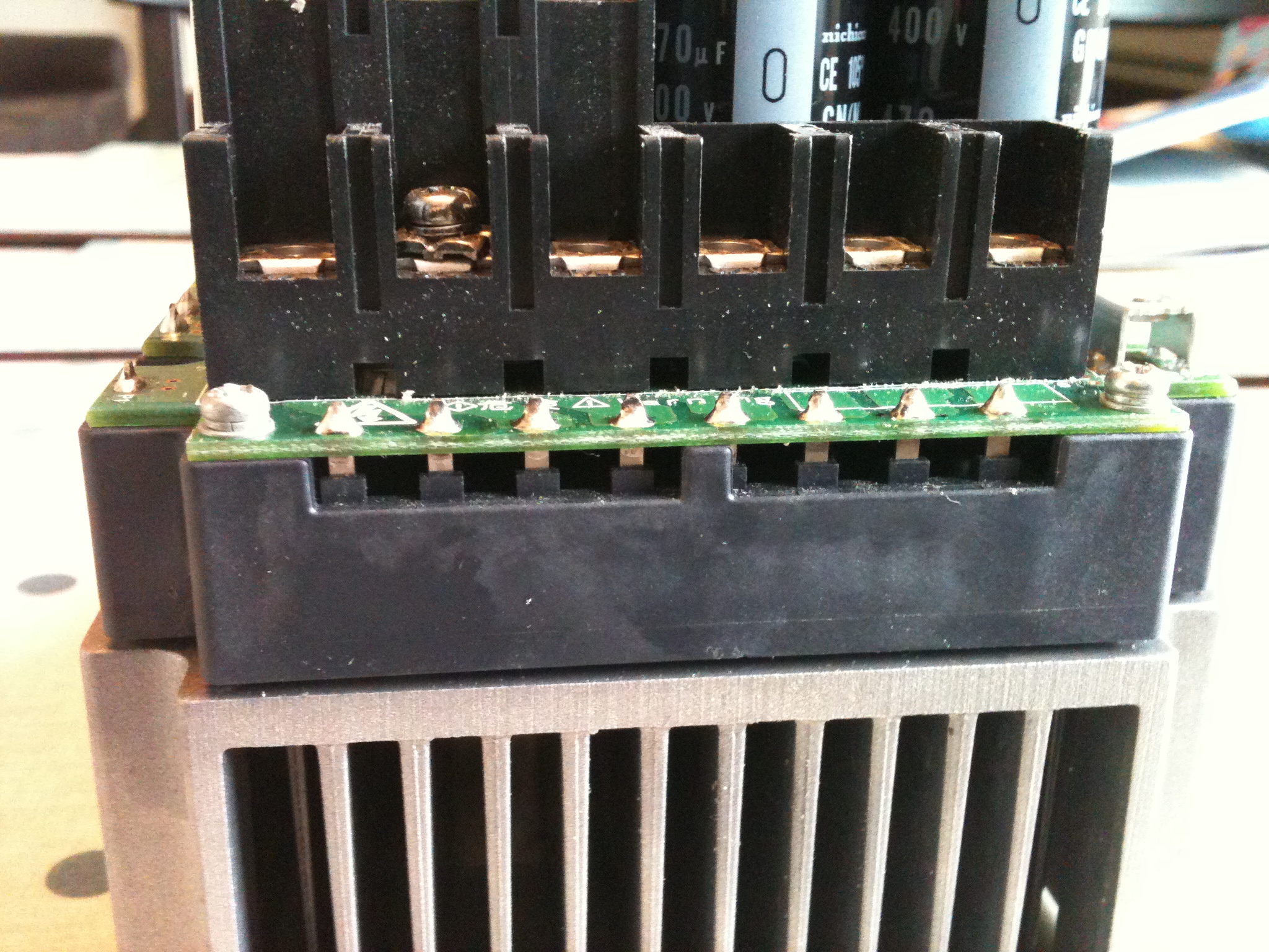

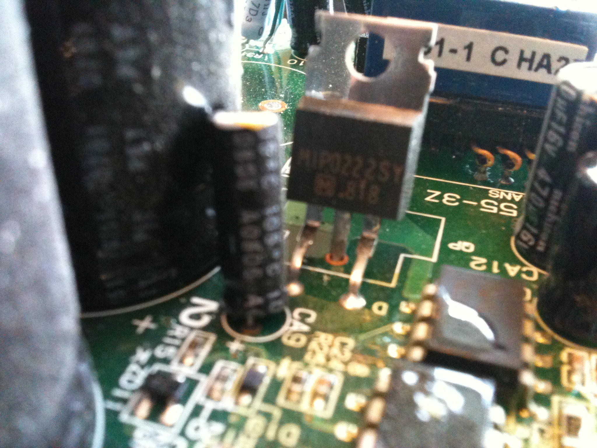

    Thank you Jonathan. Here are some pictures for reference:

    Are the IGBTs the 3 pin components with a small heat sink? I was vaguely expecting 4 pins but am no expert.
    To get to the DC bus I guess I need to get to one of the big capacitor pins? There are 2 boards stacked on top of each other with the top one looking like the high power side and the bottom one looking like the control/software side.
    It looks like quite a job to take the top board off to get to the pins since they've soldered multiple pins in place around the edge of the boards to hold it in place (or prevent tampering !).
    I'll have another look, but most likely going to send it away.

    The IGBTs will either be 3-pin components (6 of them - like in the picture you linked to), or a single module containing all 6. Either way they'll attached to the main heatsink as they are the components that switch the power through the motor, so have the highest losses in the driver. I don't think you can see them in your images, as they're probably on the lower PCB.
    Yes - the capacitors are connected to the DC bus so if you can get to both pins of a capacitor, that's the same thing. They seem to have missed out one capacitor on the top PCB (the big circle), so you can connect your meter to those pads. The capacitors say 400V on them, so they will all be in parallel.
    The 3-pin component in the 2nd picture is some sort of MOSFET to make a switching power supply - it's probably connected to the yellow inductor to derive the logic supply from the DC-bus.
