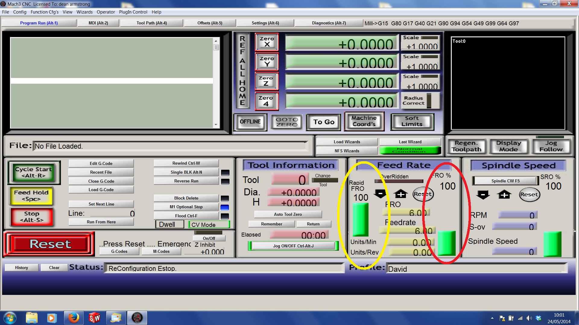

    How do we speed up the X and Y axis in the safe Z moves ?
    In other words, A G'code is executed..... the Z axis has risen to move across the the next location but X and Y are slow until the Z has returned to the work on the next pass again which is then controlled by Feed rates.

    Are you using G1 rather than G0 for the moves at safe height?

    G0
    Isn't that dictated by what is produced in the G-code ?
    Is there a manual speed I can set ?

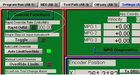

    Maybe something to do with "Lock rapid FRO to FEED FRO" ????

    Safe Z is used when homing and not controlled by G-code. G28.1 reference home can be in the g-code and this use's current feed rate so if your feedrate is low so will the homing.!
    Post the g-code file and will check it for you.

    Hi Jazz, Seems to be most if not All of my G codes. As soon as the Z axis retracts, to move the X and Y to the next point, its annoyingly slow.
