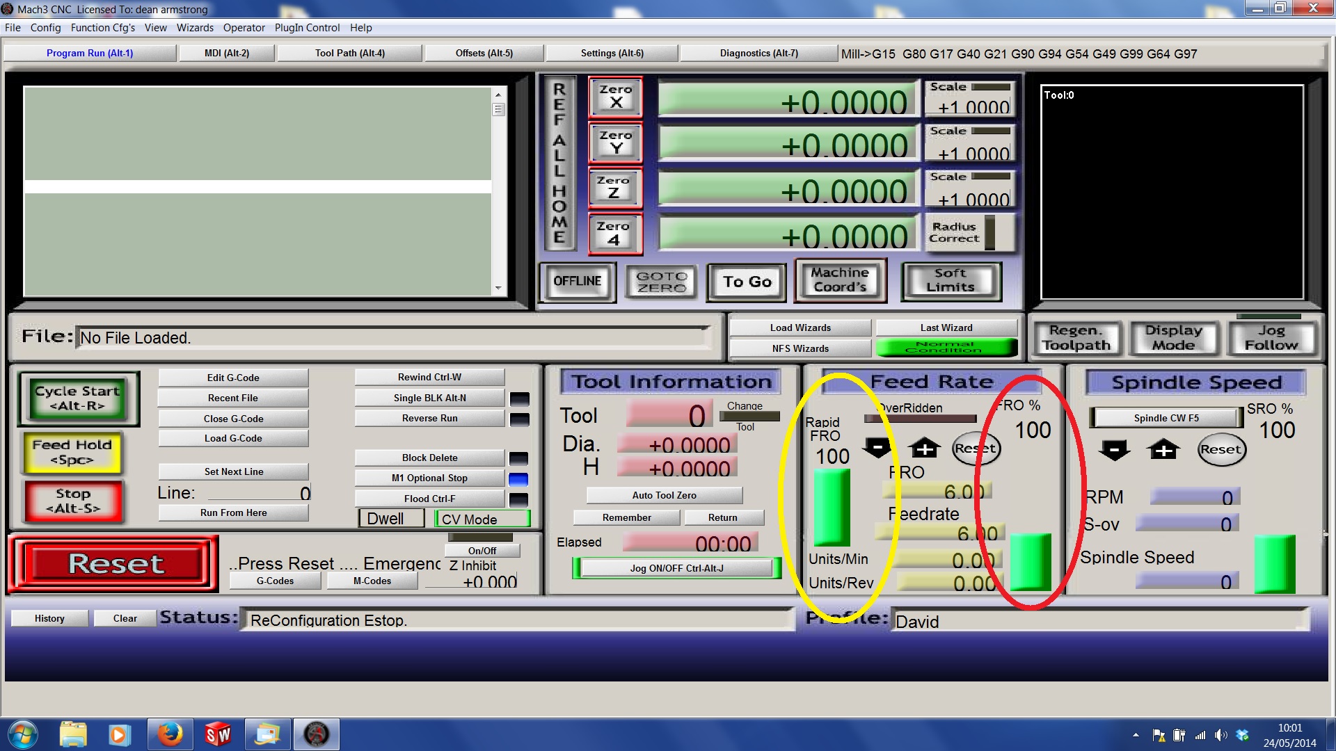

    X = 4000
    y = 4200
    z = 2000
    Just tried the famous aztec calender "cutting air". The fast feed G0 travels at 1000 units per min

    Sounds like you have feed rate override (FRO) set to roughly 25%.
    dudz's Avatar
    Lives in Dunedin, New Zealand. Last Activity: 06-06-2026 Has a total post count of 295. Received thanks 2 times, giving thanks to others 79 times.
    Which screen is that set in please ?

    The feedrate while milling is OK

    Which screen set are you using.? If it's standard 1024 then see pic and marked circles.

    I ran the aztec again. The X and Y travels around 1500 units/min while cutting but as soon as the Z retracts to go to the opposite side, it runs at 1000.
    Using Big Tex screen. It states 100% for FRO and Rapid FRO is not shown. I will try in the standard 1024 screen in a minute.

    With 1024 screen loaded. Both Rapid FRO and FRO are at 100%
    No difference

    Ok.. Done it. In Mach3. Open the settings tab. Top left hand box called Fast feed overide. It has 0.00 in the box. I changed the numbers to 1000 and left the tab without pressing enter. Now the 3 axis travel 5x as fast ( when not cutting material ) This is in the standard Mach3 screen. The Big tex screen is different
