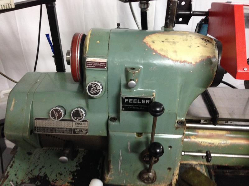

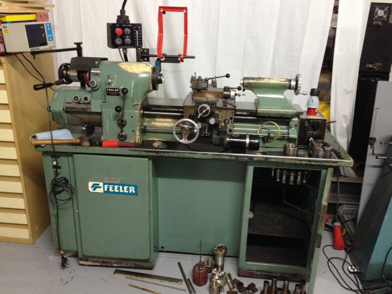

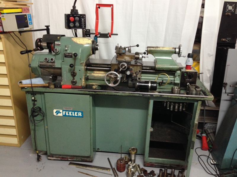

    As I have found the other logs on this forum handy so far I thought I would document my rebuild here. I'm not doing a full renovation right off the bat I just want to get it functional and make sure I'm not doing it any harm when I use it, later I might think about a more complete job.
    I got the lathe a few days ago, of course I wanted a Hardinge but funds don't allow and I want metric as I'm a youngun (ish). I found this Feeler and the price was right.
    Problems include:
    1. *Extremely* noisy gearbox
    2. No half nut lever
    3. Missing cross-slide scales
    4. Stiff carriage
    Here she is:

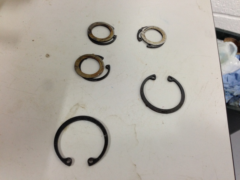

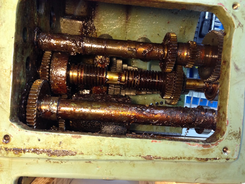

    On the day I got her I had to find out exactly what was wrong with the gearbox. If you take off the collet closer cover it reveals an access hole and there is another beneath it.
    Lots more fiddling and I find there is no special reason the selector should not work, very careful use of a slide hammer and it moves, so the gear train engages OK but there is something making a lot of noise.

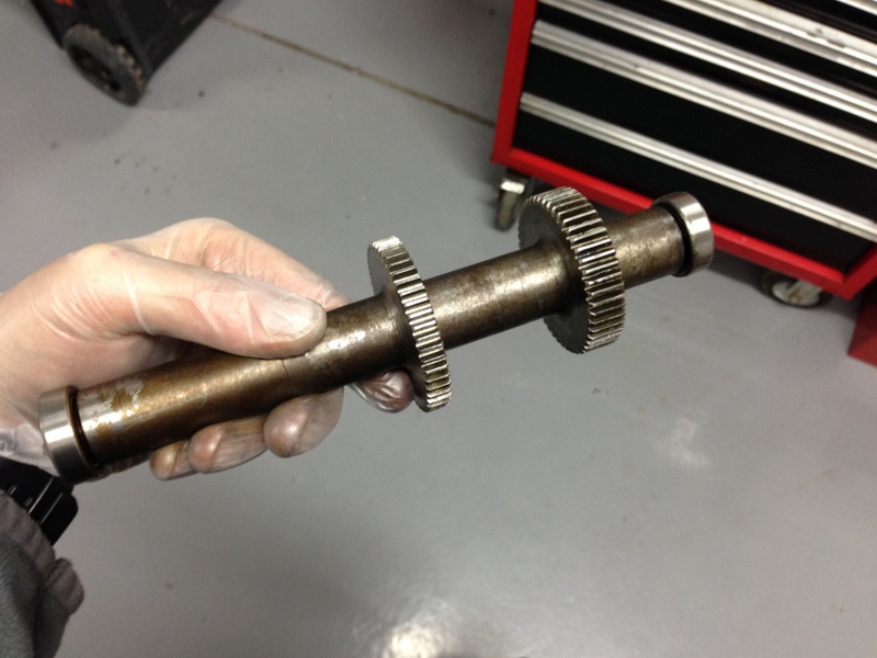

    I work out which gears it must be, The spindle drives two gears on parallel shafts in the same direction, one on the clutch shaft and one on a secondary shaft. The one on the clutch shaft free wheels. The secondary shaft has another gear that engages with a further freewheeling gear on the clutch shaft which now rotates in the opposite direction. There is a dog between them, keyed to the shaft which can engage with either gear depending on the threading direction desired. That shaft drives the rest of the gubbins. Or in other words:
    [The two gears on the left do not mesh but are powered by a gear that connects to the spindle when threading is engaged]
    The problem was the second gear on the secondary shaft, I could see damage to the teeth.
    I have the feeler service manual but it is just drawings, I have the Hardinge service manual and that has descriptions too. What I did find though was that this Feeler is not an exact copy of the Hardinge in my manual at least, there were a few differences when dismantling.

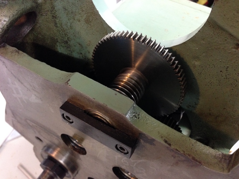

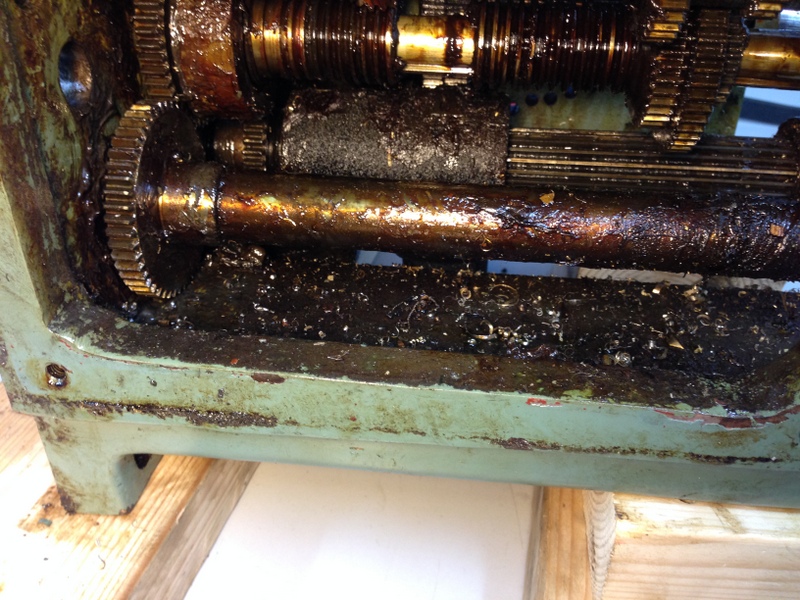

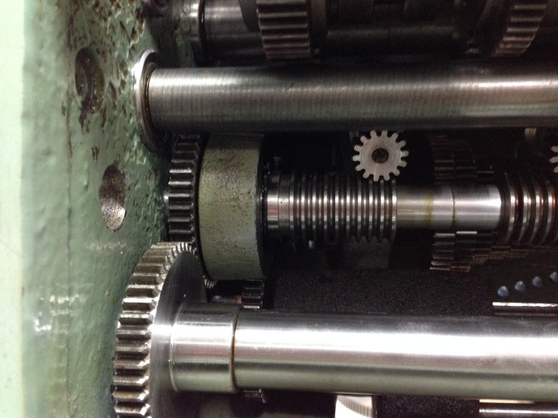

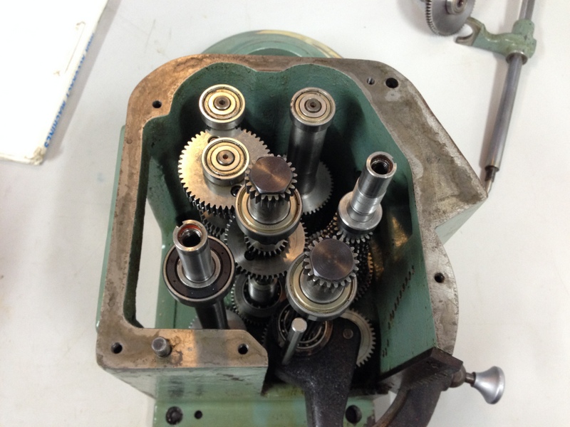

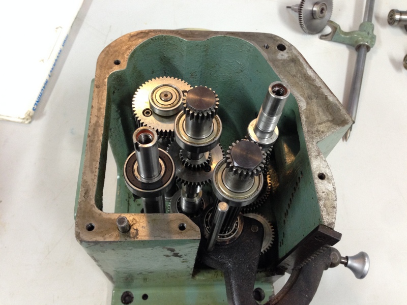

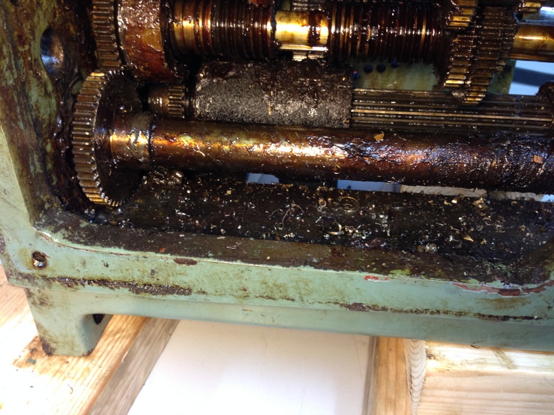

    This is what the inside of the gearbox looked like:
ID:	12425Click image for larger version.
    It looks like the recommended lubricant may have been exchanged for hoisin sauce with a liberal splashing of chips but at least it's not rusty.

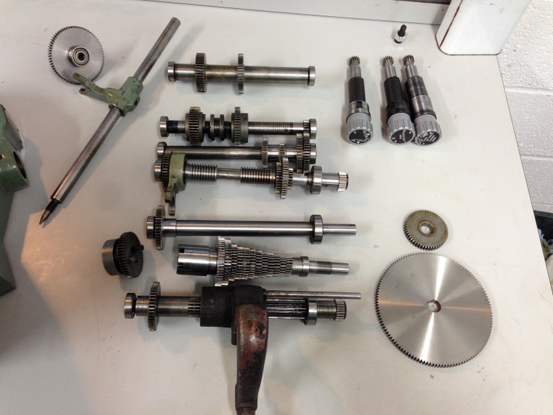

    After removing the various shafts I found the two gears that were not running well. I did my best to straighten teeth and dress them again. I put the two problem shafts back in the housing to test and well it seemed worse.

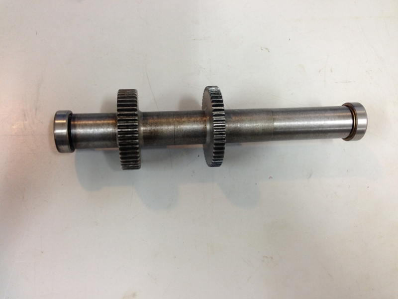

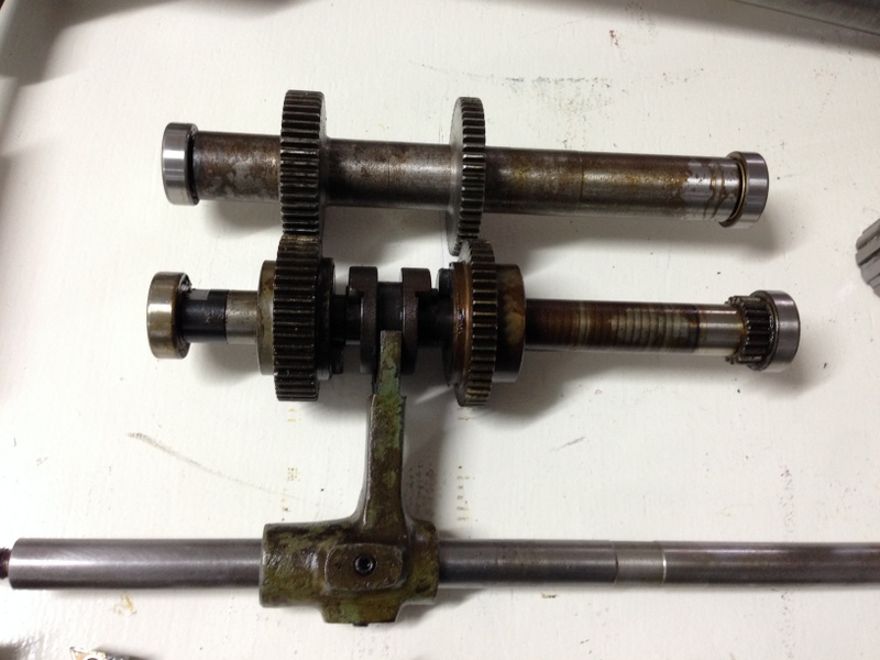

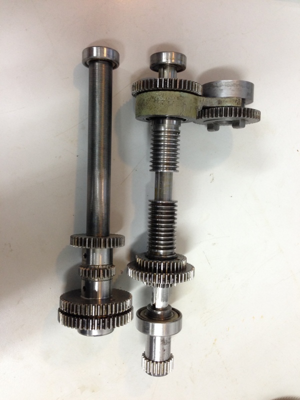

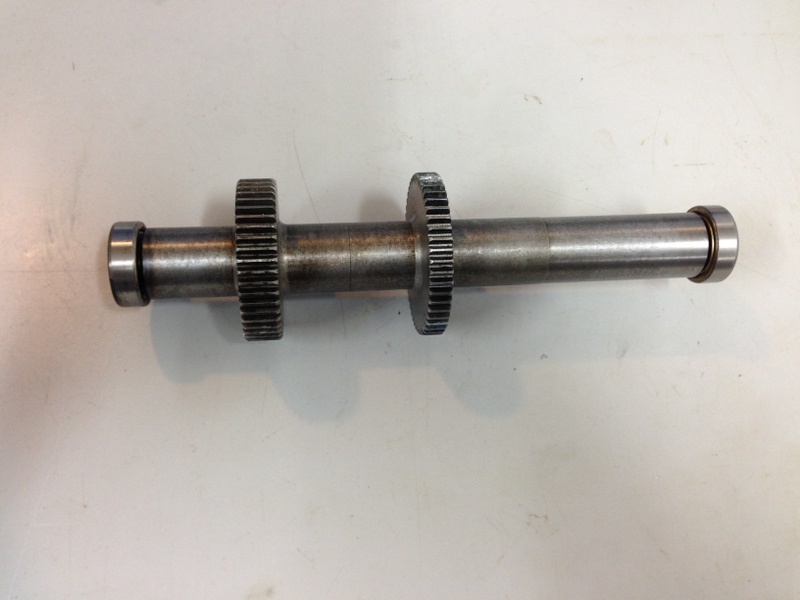

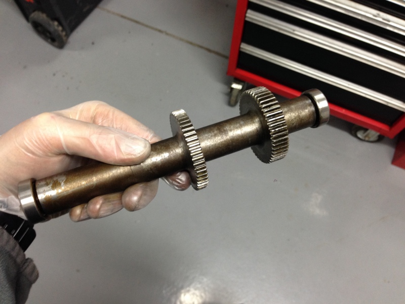

    So this is the shaft with the worse of the gears after dressing. Everyone I spoke to said "doesn't look too bad", "should get away with that". After two days of prowling and wondering what to do I thought I would go back to dressing to try and improve things. In the mean time at least I had cleaned up the gearbox housing.

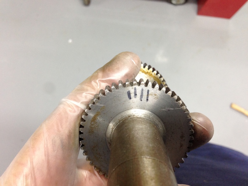

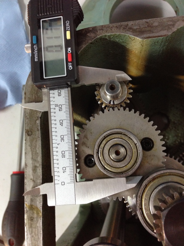

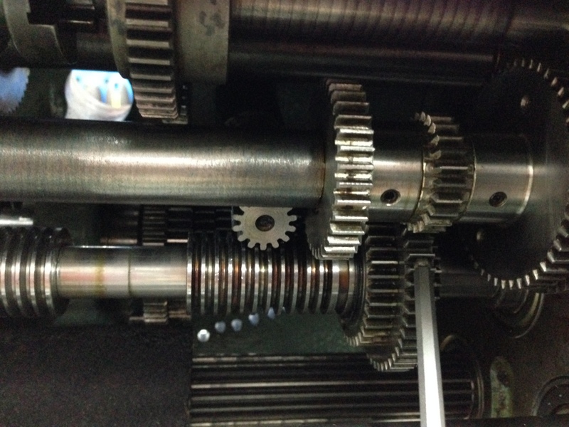

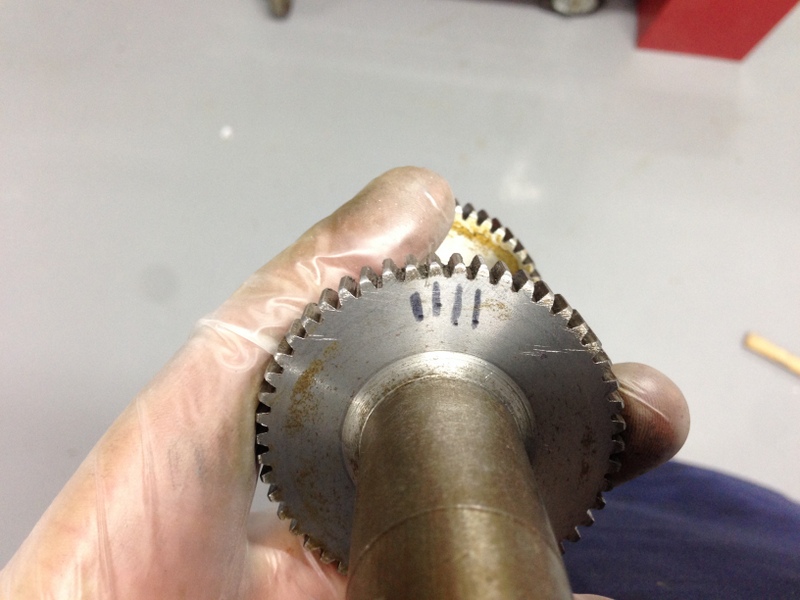

    I used some marking blue and the other gear to try and work out what material to shift and what to remove etc. I put the two shafts back in and they ran so smoothly and ... then they didn't and then they did. Totally random, what the ...
    Well the free-wheeling gears freewheel but of course there is some friction, this causes the output shaft to turn, in some positions of the shaft it would bind, in others it didn't. Ah ha! The shaft is bent.

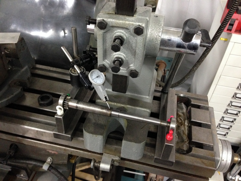

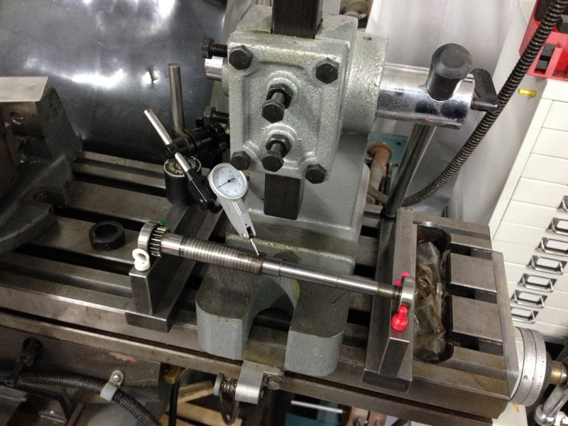

    On to my makeshift metrology area, table saw top, and some parallels plus some magnets to stop it all rolling away. Oh 0.45mm runout at the binding gear. The shaft has a thick section and a thinner length shrink fitted in to it, I think. In either case the bend happened at the shoulder where the gear mounted.
    Off with the gears and the dog and into the arbor press.

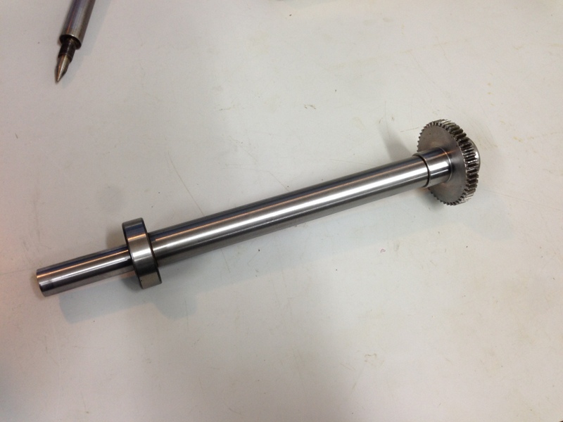

    I ended up using a plunger type gauge to get the travel and protected the shaft from my rough-arsed press with some ali. A few presses and I was running closer to 0.04mm and I left it at that.
    Back in the box and the two shafts run sweet as a nut.
    So the gear on the thin shaft was hardly damaged but the shaft was bent and the gear on the thick shaft was damaged but the shaft was fine. Swings and roundabouts for sure.
    Now let's get the gears cleaned up:
    I used some gunk engine cleaner, scotch brite on the metal and nonstick safe pan scourers on the few painted bits. Watch for the detent spring in the selectors.

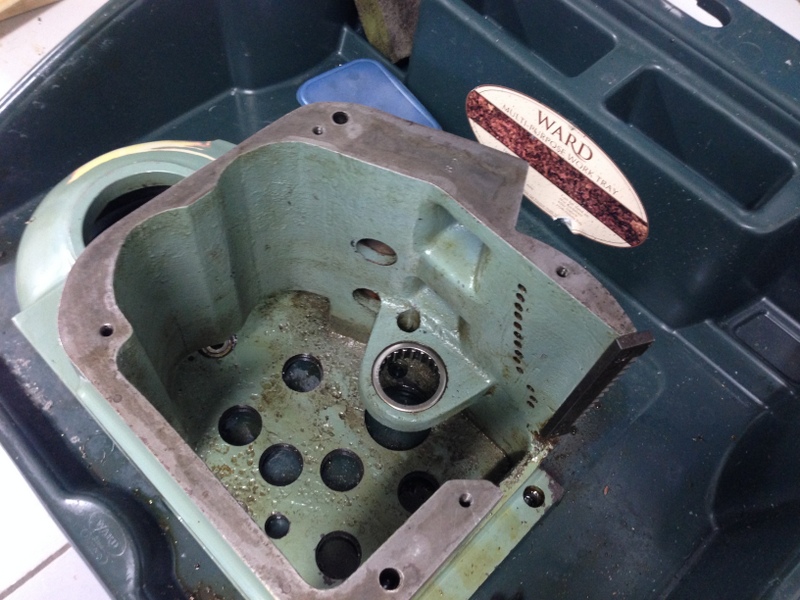

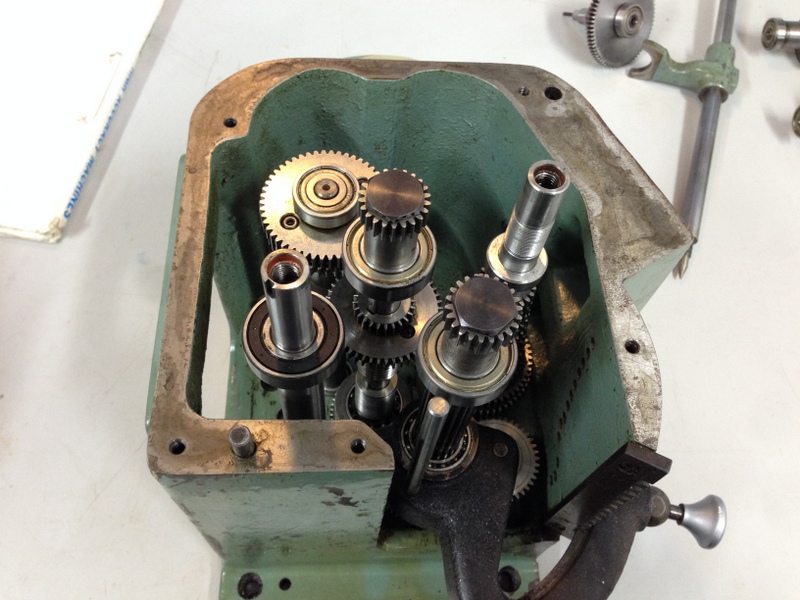

    First put the tumbler back in place:
    These two are best put in together
ID:	12434Click image for larger version.
ID:	12435Click image for larger version.

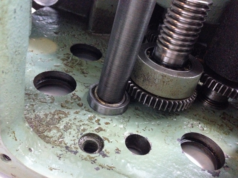

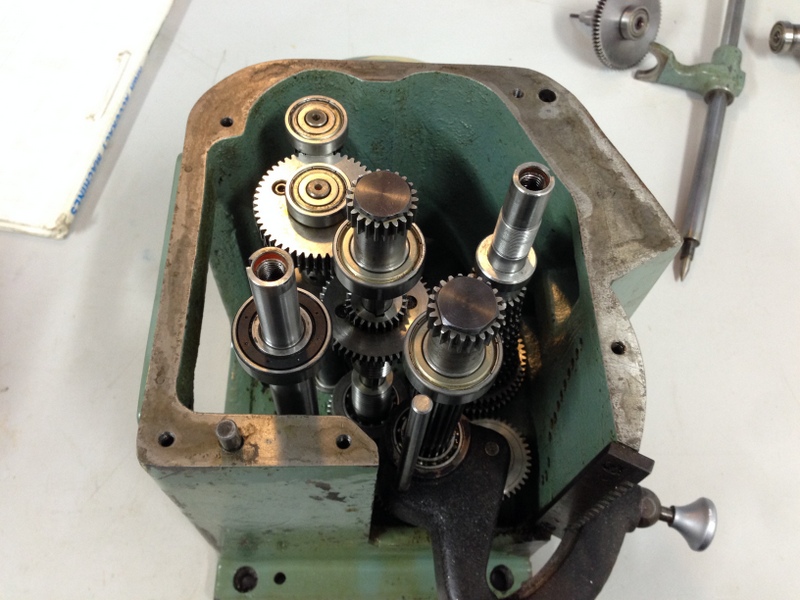

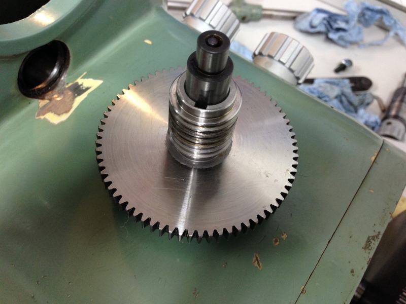

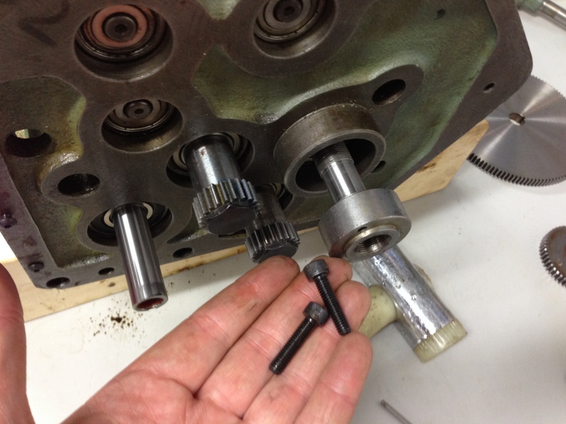

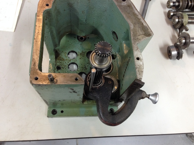

    Be careful to life the gear and dog to clear the bearing while inerting. The lower cluster of gears is the 3-position range selector, you can see the rack used to move the gears on the right hand shaft. The dog at the top is actuated by the metric/imperial selector which engages the gear or moves the short tubular shaft that connects with the leadscrew in and out of engagement with the gear cluster. I can't quite remember the details but I hope to do a video on it to help me remember how it all works in case I strip it down again later.
ID:	12437Click image for larger version.
    This shaft has a gear attached on the end once the gearbox end plate is back on, it forms the ratio that converts between metric and imperial (or vice versa). The other gear is mounted on the end of the cluster gear shaft.

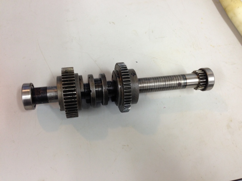

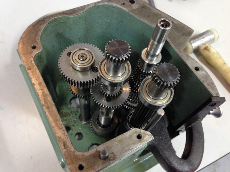

    Now the problem shaft all straightened:
ID:	12446Click image for larger version.
    And the shaft with the duff gear, all dressed:
ID:	12445Click image for larger version.

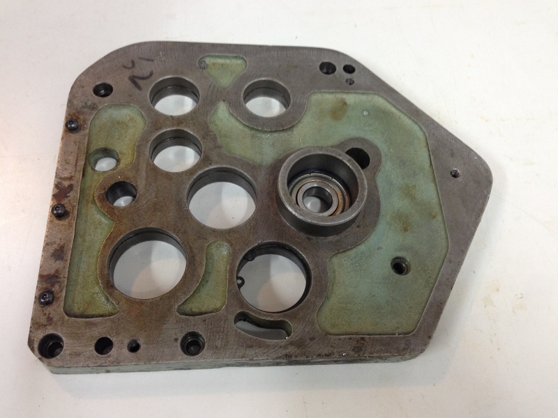

    The cover can then go back on, the idler gear can go in later as can the shaft and dog for threading direction selection. The selector switches can also go in later when I will be able to see how it all aligns more easily.

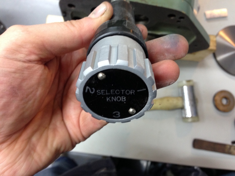

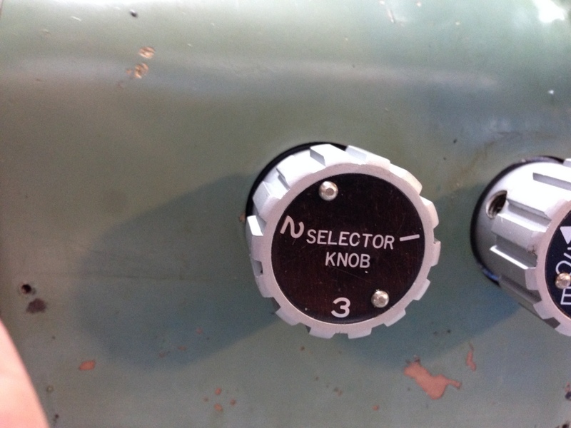

    As a side note, unlike the standard Hardinge gearbox (but perhaps not the rarer metric/imperial unit) you can leave the output shaft in the machine still connected to the leadscrew. If the lock nut next to the taper pin that connects it to the lead screw is stuck this might be an option, the only problem is that you then have a keyway to align on a loose gear when you offer up the rather heavy gearbox.

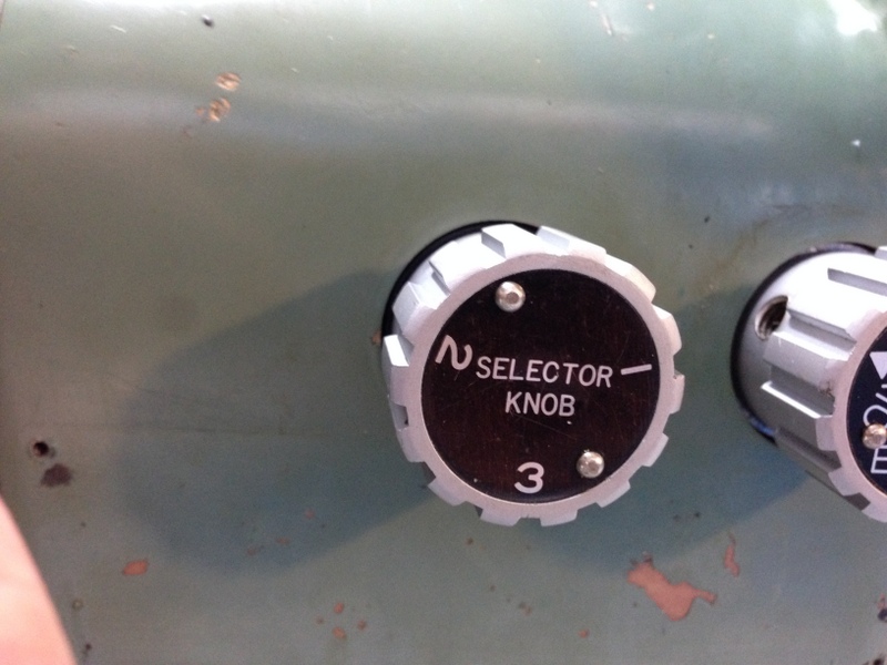

    OK, set the knob so that the marred flat on the body (the one that is clamped by the grub screw) is at the bottom and turn so the number 3 is at the bottom. Slide the gear cluster so it engages with the central gear and insert the selector with the marred flat to the bottom. Nip up the grub screw and test it works OK.

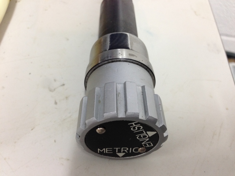

    Similarly set up the English/Metric knob so that Metric is at the bottom. Push the fork so that the gear engages with the shaft that drives the external imperial/metric converter gearing. Then insert the selector knob, test the function. The output shaft makes this much easier.
ID:	12450Click image for larger version.

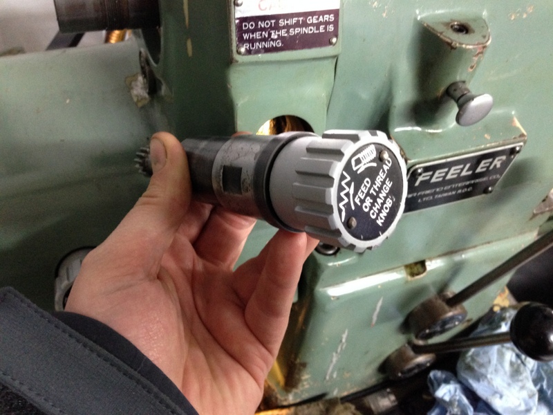

    With the gearbox back in place it is time to add the feed/threading selector. On the Feeler the flat is on the left and I put the knob in the thread position. Then align the idler so that it runs on the gear on the spindle.
ID:	12458Click image for larger version.
    Now just put insert, screw in place and test. Put the metric conversion gear back in place, add the handwheel to the spindle and it's done. [note the bearing is on the wrong side of the circlip in this picture, not sure what I was thinking.]

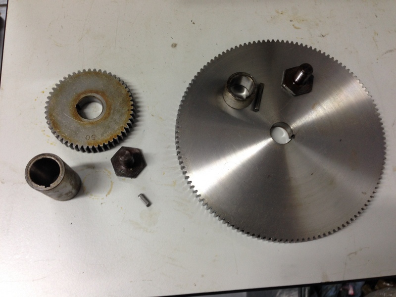

    So I finally got it running:
    At the moment there is no grease on it, I've just sent off an email to get prices on the various lubricants required. It rattles a bit but I suspect that will simmer down with some grease on it, over all I am happy.
    Now to tick some more stuff off the list.

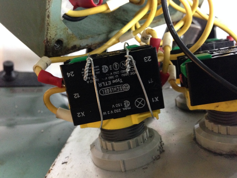

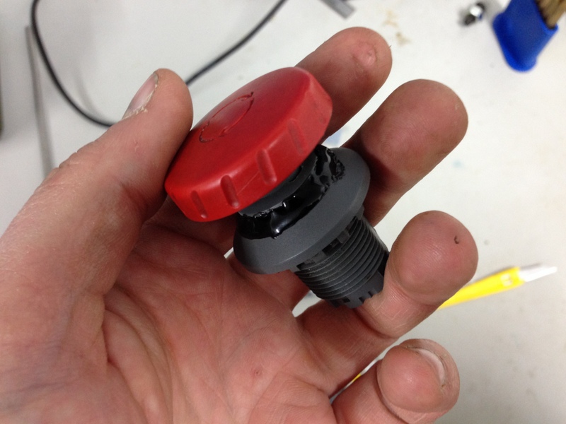

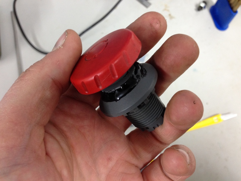

    The stop switch was extremely stiff, I stripped it down and cleaned it, deburred some little plungers and reassembled. The original ultrasonic weld joints were broken so as a temporary measure I hot glued it after keying it with sandpaper. I will replace the switch in due course. The power button's lamp was also not working and I found that the switch was falling apart. I have ordered an LED lamp replacement and tied it all together with some wire for now, again I will replace it later.

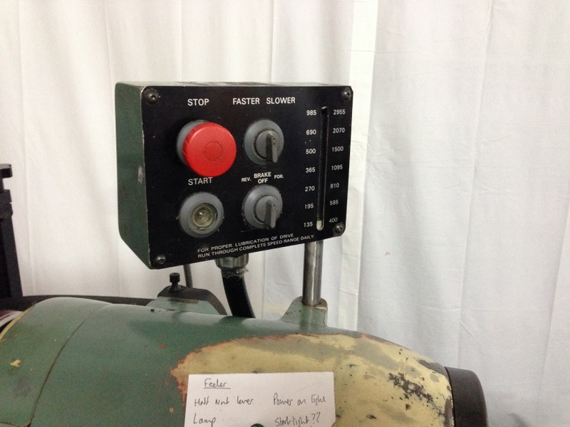

    The main power lamp is also not working, another lamp to source.

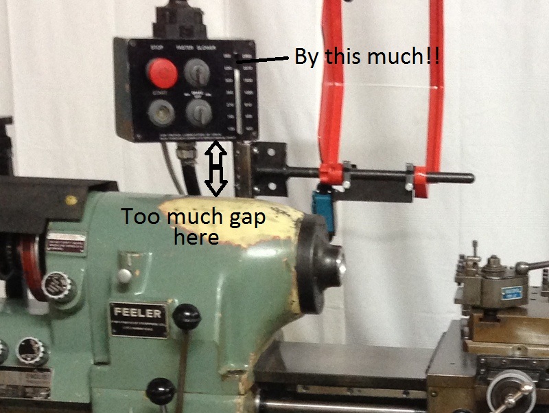

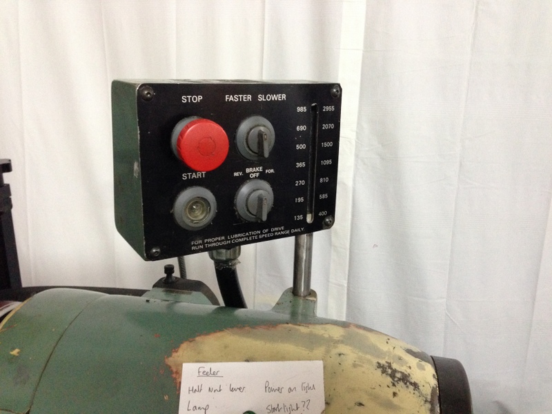

    The speed indicator does not go high enough, something is wrong there, the mounting is different to the Hardinge and not really shown in the Feeler manual, it seems like the rod should be adjustable but I can seem to find a way to move it, no grub screw in the end of the bolt as I expected, unless that is lost and it is just gummed up?
    Graham

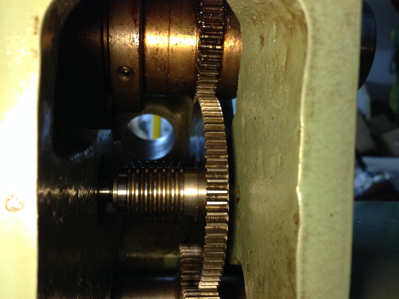

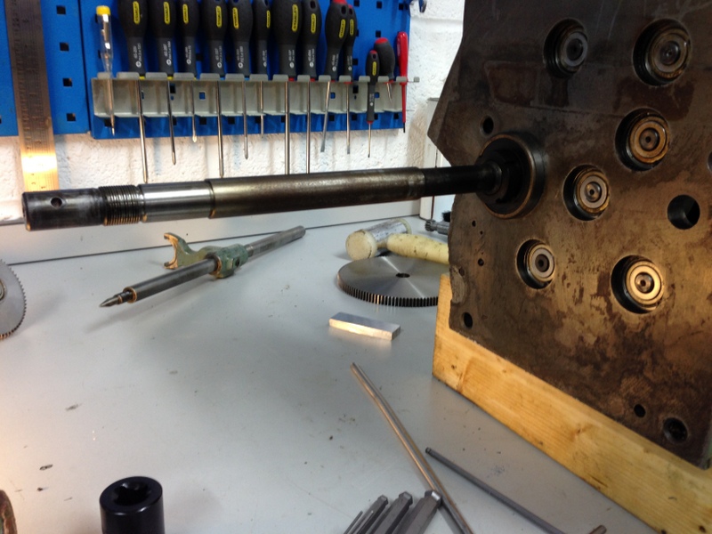

    I spent over an hour farting around with the speed indicator, trying to position it in various places or work out how the rod was attached to adjust it (I think it is punched in place) and then realised the issue, the previous owners had added an interlocked guard and to do this had welded a bracket on to the tubular stand that holds the control panel up and through which the speed indicating rod passes. Hmm, some measuring later and I see that the rod no longer bottoms out in the hole but now sits on the bracket!
    So that is why the indicator was not getting high enough!
    So I took the tube off and ground off the bracket carefully. I'd like the guard (maybe without the interlock) so will figure out some sort of clamping arrangement I think. Now it works perfectly.

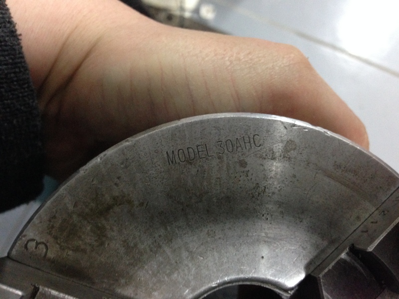

    Does anyone know where I can get some hard jaws for the Hardinge chuck it came with?
ID:	12476Click image for larger version.
    I have the jaws shown but not the other type.

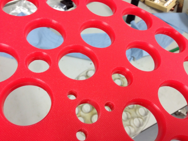

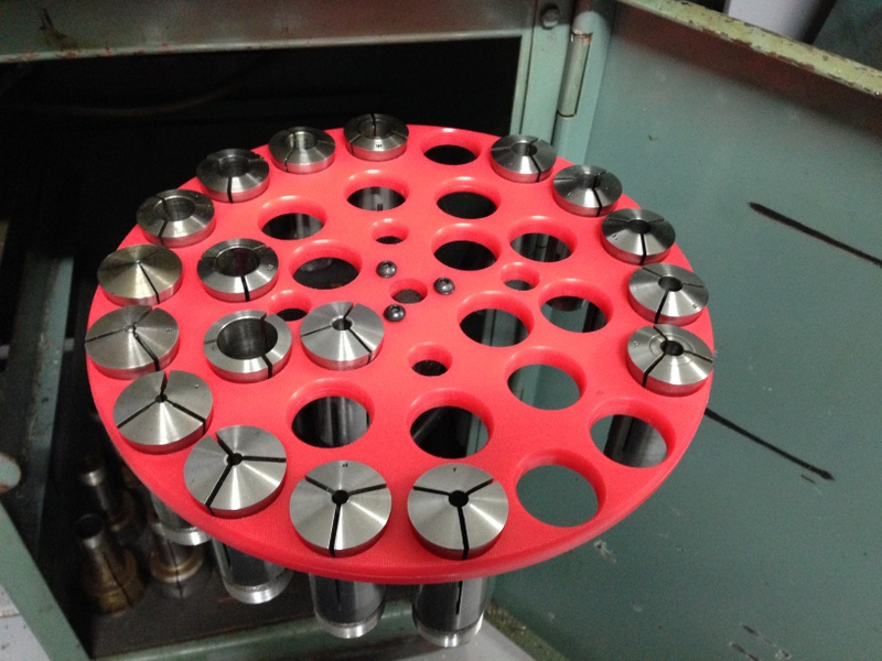

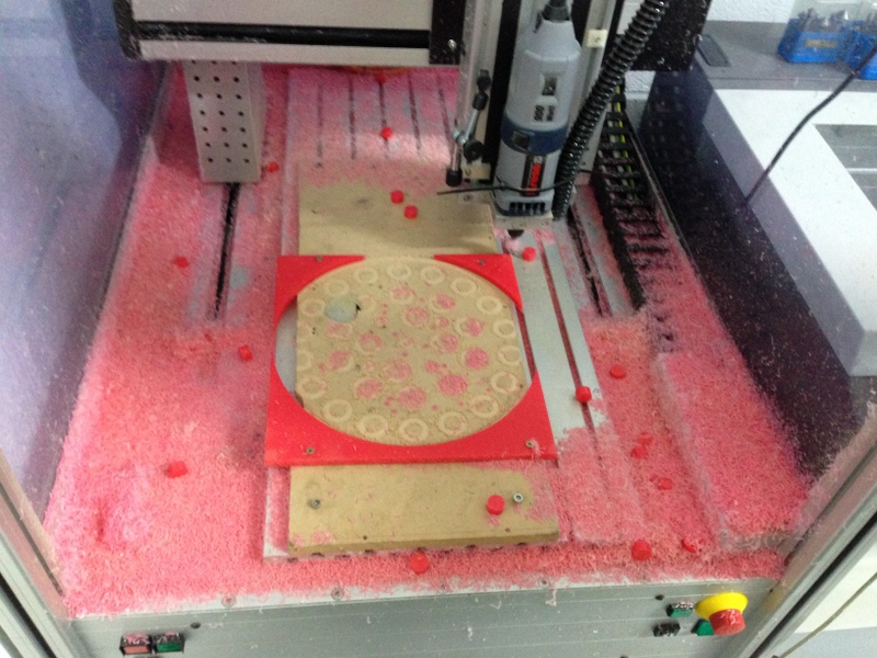

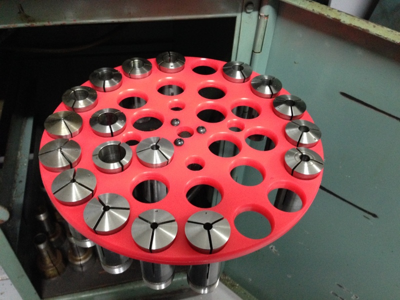

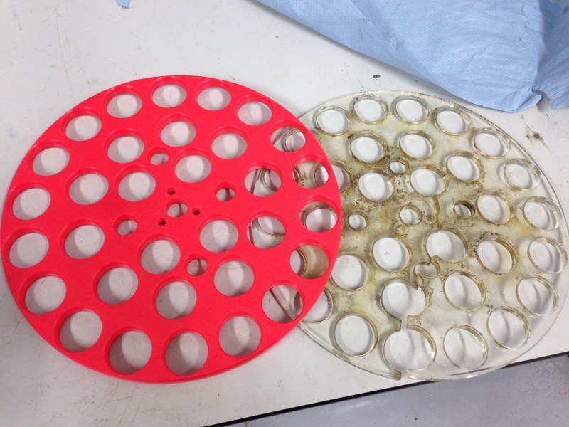

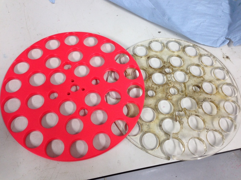

    I've decided to slow down a little and put panels back on etc and clean up while I get some other stuff done. This would be easier without a table covered in collets so time to sort out the collet carousel. One of the original perspex ones has cracked, it was held with cable ties when I got the machine.
    I could remake from perspex but it is likely to happen again, instead I'll use something softer and tougher, a catering chopping board, less than a fiver from the local cash and carry and just big enough. After some time in the CNC router:
    a quite presentable part. I used a trim router and round over bit to provide a slight lead in for the holes.

    I just need to get another chopping board and do the other one now.

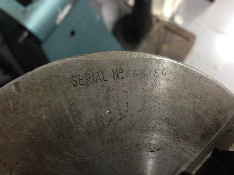

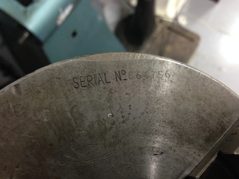

    Oh as far as the chuck goes, it seems it was made by Pratt and Burnerd but they no longer make them. Rotagrip do sell soft jaws so I may make a set, not sure I can harden them though. Another alternative suggested by Bill Todd is to make a back plate for a standard chuck and I will look into doing this.
