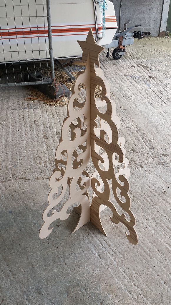

    spent an hour or so yesterday morning making a prototype of these trees out of some 6mm ply.

    Ive used vcarve for a while now without experiencing this problem, but for some reason (probably got something to do with importing a dwg) the toolpaths generated seemed to "stutter" the machine. Unline normal paths, the maching jittered all the way around the profile. Had to turn the acceleration and velocity down as it almost shook the thing to peaces.
    as im asking for help here, I thought id give you best possible chance of seeing the problem. So Ive included everything

    I check mach was set on 'constant velocity' and you can see from the straight at the end of the video, when in structed the machine normally runs much faster
    any help anybody can afford me will be greatly appreciated. thanks in advance.
    Hmm it looks like it is stopping or hesitating after every segment in the arc. Have you tried outputing the mach file as arcs rather than straight lines.

    thats what I thought... but the post processor is set to mach 2/3 with arcs
    is there anything else im missing?
    Can it be that the file was supplied with a really fine break down of the arcs into tiny little striaght line segements during .dwg conversion and mach just is struggling to keep up with the processing each move.

    Matt, The problem is that your curves are made up of thousands of tiny straight lines rather than arcs. You need to reduce the number of nodes making up the curves. Have a look at this post : Vectric Forum • View topic - Node editing

    Type g64 into Mdi and press enter before running code just to be sure your in CV mode. This looks very much like it's running in exact stop mode (g61).
    Check code for g61 using replace & find.
    Failing that then it's because there's too many lines making up the arc's so turn down tuning or reduce number of lines.!

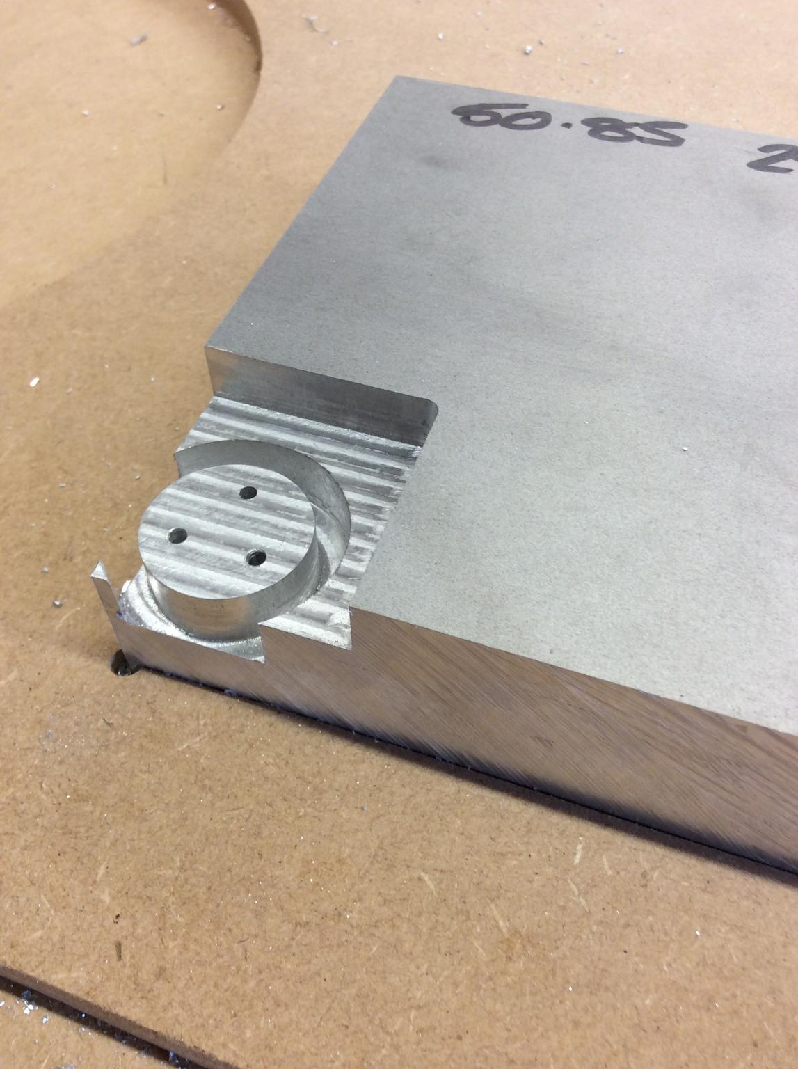

    It's running great thanks mate. It munched its way through a block of ali quite happily yesterday without breaking a sweat (or a cutter!)
    Clearly states in my terms and conditions "For wood use only" so your first job is great big macking lump of Ali.!!. . . . That's it Warranty void. .
