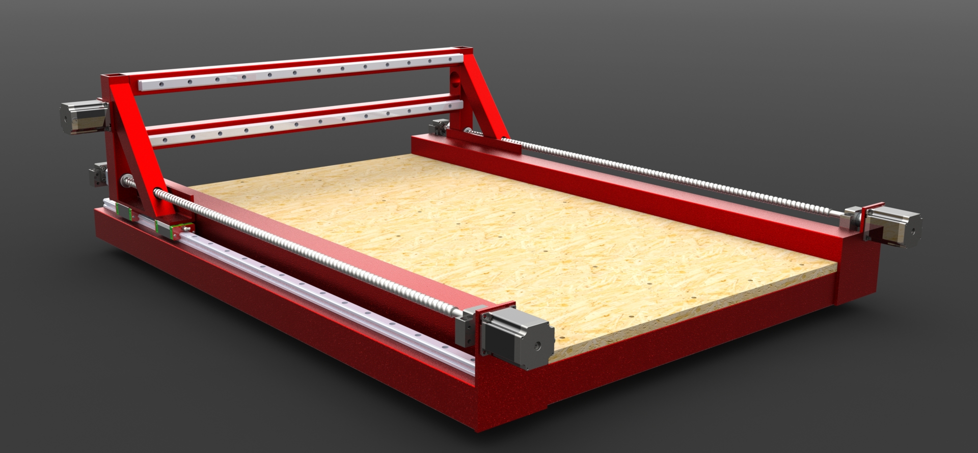

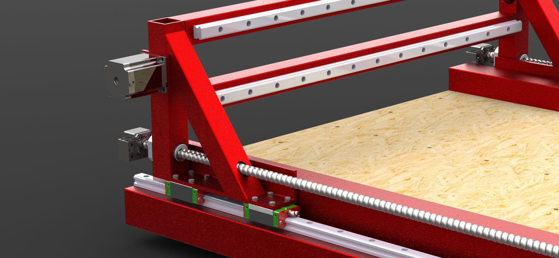

    So I have nearly completed the first draft of my design, Im very comfortable with being able to make this machine with the tools and equipment I have access too. The gantry im happy with and the way in which the gantry is mounted to the rails. Im also happy with the location of the rails, steppers and mounts etc... the ball screw support blocks have yet to be mounted to a plate(next job) then onto the z axis :)
    The frame is mostly 60x60x3mm box section with the gantries vertical section and support section being 40x40x5mm, Hopefully you guys approve this design...in which case I start my budget plan to make sure it can be built within my budget. Then progress to the parts list and DXF files for the laser cut stepper mounts and then go from there :)
    Added some colour to give it a bit of life...

    OK Mike, sorry I'm going to be blunt here. Jazz has said to go through the build logs as have myself, Jonathan and the others I still think you need to go back and do some reading as the design you have put here has been done before (or designs nearly identical to this one) and commented on.
    Again being blunt:
    Quote Originally Posted by FlyHighRC View Post
    Do you have a link to these linear rails?
    I dont know much about CNC but i know how to incorprate strength into a design. If there is one thing Im good at its designing...dont get me wrong...i have seen builds on this forum which to me seem fine but people who have been there and done that have pointed out aspcts of designs that didnt show up to me...but all their critisims and expertise has been written down on my Pukkapad to bear in mind when designing my machine, which will be posted so others can tell me what needs improvong and whats ok etc etc.
    Really appreciate the help :)
    The design you posted is anything but strong...people will have pointed out things in other builds which to you don't show up because they have experience of building the machines, normally by making the same mistakes and regretting it. My brief comments on "first draft"
    • Bed does not have enough support and will vibrate and bounce giving poor finish.
    • X axis bearing mount to gantry is too thin and flexible.
    • Mount the steppers with belts to reduce resonance, not essential but preferable.
    • Gantry has no bracing or support so will bend/bounce/twist giving poor finish.
    • 40x40 box (for the gantry) isn't strong enough as Jazz said before.
    The above assumes that you will be cutting some aluminium at some stage.
    Sorry my reply might come accross as being unfriendly and harsh but I can see you going down a route as Jazz said that will leave you dissapointed if you're not careful and if you're not careful you'll waste money prodcing a machine that won't cut what you want to cut.
