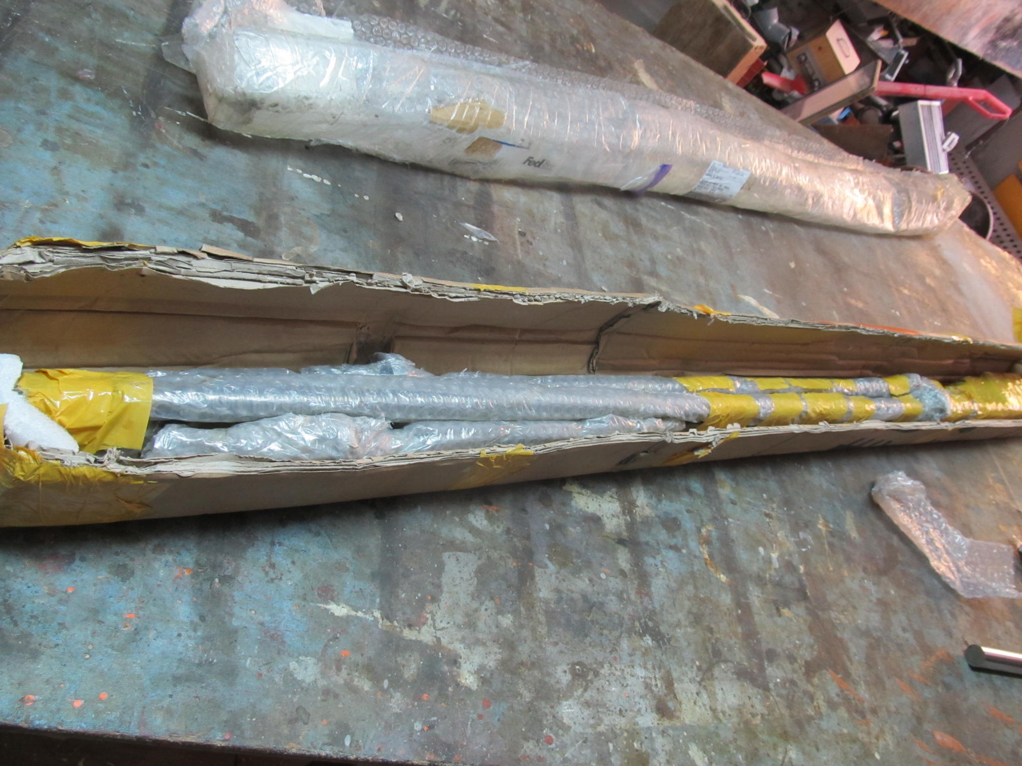

    Yesterday i receive from Chai the above things
    2X anti backlash ballscrews RM 2010 C7 end machined -1603mm Overall length
    2 ballnuts for 2010 ballscrews
    1X anti backlash ballscrews RM 2010 C7 end machined -1153mm Overall length
    1X anti backlash ballscrews RM1605 C7 end machined -501mm Overall length
    1 ballnut for 1605 ballscrew
    3 Set of BK/BF15
    1 Set of BK/BF12
    1x Ball Nut Mount/Bracket Flange For 1605
    3XBall Nut Mount/Bracket Flange For 2010

    I open the box to see if everything is ok
    I attach the bf/bk at the ballscrews, and i realize that the screws seems to be bended
    I give them motion with a wireless drill and they are "dancing" like crazy especially one of the 2010 1603mm long ballscrew. It seems to move 4-5mm out of the center axis. Also the other three are whipping(1-2mm).

    My questions are
    1. Is this bend so bad that make the ballscrews useless
    2. Is there any way to correct the bend
    3. What should i expect from Chai?
    a.To refund me the money?
    b. send other ballscrews with no cost?
    c. Something else?
    4. If i put that screw to my machine should i have resonanse or bearing ware problems?
    5. Did anybody had such problem with Chai? if yes what Chai did ?

    Hey Vagelis,
    I'm fairly sure that my (considerably shorter) z-screw isn't 100% straight - they could really do with packing 'em in a rigid box as opposed to cardboard/bubble-wrap, but who knows - it could as easily be a factory issue..! I guess it's a bit of a 'get what you pay for' scenario - having said that, it hasn't really caused me a problem. I think your screws look a lot worse than they perhaps are because the bearing blocks don't appear to be fastened down hard and everything's moving around, which is exacerbating the whip.
    This is a vid I made when I first got my steppers running:
    It looks REALLY bad, but when everything's bolted down it's actually okay. You could really do with having a look at this with the hardware fixed in place, as opposed to bouncing around on a couple of planks... That'll give you a better idea of how bad (or good) things are.
    Chai seems like a decent guy. Always been very helpful on the few occasions I've had to contact him for advice.
    Wal.
    I have told you this in an email but obviously you don't believe me.? . . . . Your cordless drill is exagerating the Wobble greatly and when on the machine and fastened down and aligned correctly it will most likely not be a problem. I have seen worse being used without problems.!!
    The runout on my cordless drill is huge, so if yours is the same that will make things appear worse.
    I recieved a noisy ballscrew which had about 0.5mm run out (measured with it bolted properly to the machine and driven by a stepper motor through a coupling).
    I considered returning it but they are packed in carboard boxes so chances are it would be no better if they sent another one.
    So I sent it off to a UK company and they straightened it to a claimed <0.05mm run out. Cost £45. After that it ran very smoothly and quietly.

    Yes it's standard way to straighten any shaft not just ballscrews. . . . BUT . . Trust me on this Vagelis chances are they will be OK when on the machine and setup. If any is bent enough to cause a problem then it's not difficult to straighten them like is shown in the link above and often this can be done in a standard vice with pair of V blocks. It doesn't take much effort to straighten screws just a little patience.!
