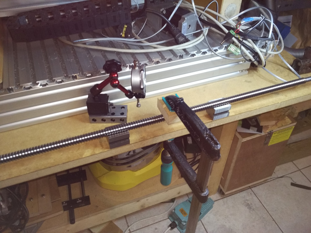

    After finding this topic, I thought to give it a go.
    As numerous people with Chinese rolled 1605-C7 ballscrews, I have to somehow deal with bends ...or live with them. In my case, we are talking about 3 items of 720~780mm lengths and 0.54~1.32mm runout (the latter can be seen with naked eye). This is how I am trying to deal with it.
    After finding the high spot, I have tried several variations:
    - v blocks at ends, quarters, 100mm and 50mm from high spot
    - bending down by 0.5*runout, 0.6*runout, 1*runout, 2*runout
    - applying force for 1m, 2m, 10m, 1h, 10h
    Of course I have not tried all the combinations of the above and I have lost track of what combinations I have actually tried so far. I am trying to deal with the worse runout of 1.32mm and after a couple of days I am down to 1.21mm. I would not call this a progress.
    Therefore my question to people that have had (some) success in the past is whether they remember what recipe (v block spacing, amount of bend, time of bend) started showing results.
  3. #23
    I think you just need to bend them further, to not spring back. You are probably not applying enough stress to go past the material's elastic limit.
    This.
    If you don't bend past the elastic limit, then they will just spring back, regardless of how long you leave the clamp on. Position of support blocks, and pressure application point depends on the bend. How much pressure is very much trial and error. Apply pressure, release pressure, check to see how much things spring back, then repeat with more pressure if needed.

    Quote Originally Posted by auhopu View Post
    I put them on v-blocks and tried to apply force in the middle.
    For straightening you ideally need to apply a precise displacement then measure to see if you have achieved a permanent change, then keep increasing the displacement applied until you get the required change.
    Measuring force is an imprecise way of straightening things, a press with a dial gauge is your friend ;-)
    - Nick
