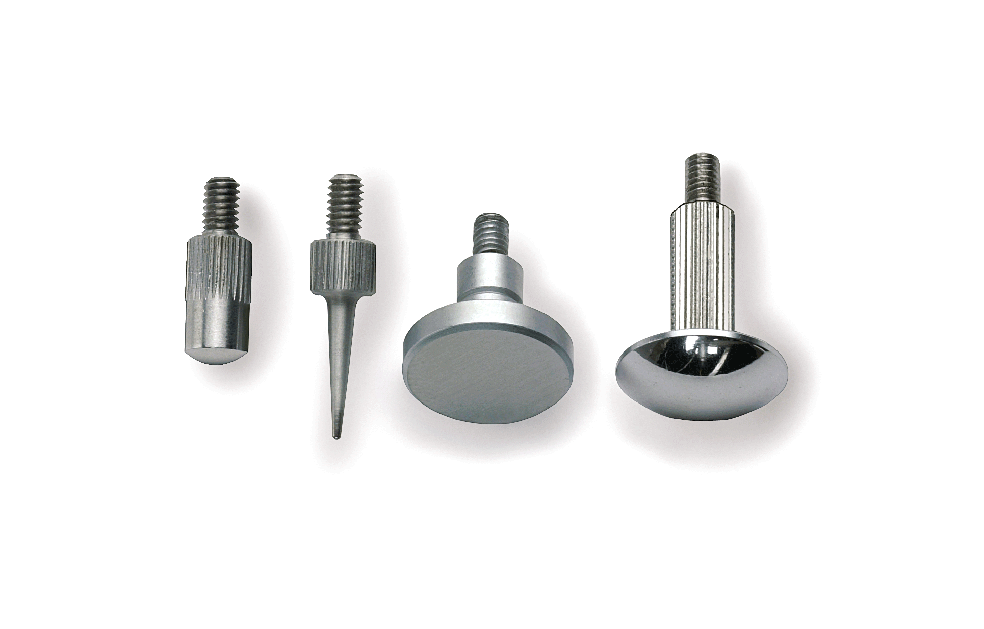

So Dean putting the ballnut on the screw and touch the indicator to the nut i think will work right?

Yep them's what's needed Wal but like finding Hen's Teeth unless your prepared to splashout on expensive dial gauges and then they are expensive for a one off job.!
Edit: I retract that statement I've just found this set at Arc eurotrade (bottom of page).!!. . . http://www.arceurotrade.co.uk/Catalo...nt/Dial-GaugesLast edited by JAZZCNC; 06-06-2014 at 09:00 PM.
