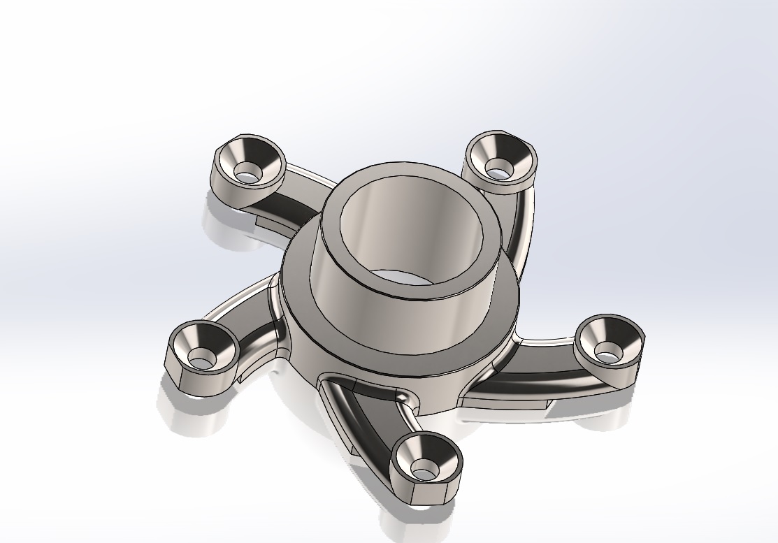

  6. #16
    Quote Originally Posted by Dean jeffery View Post
    Also how easy would it be to replicate that drawing above, for me new user, or for anybody who knows what they are doing lol.
    Well for a new user then probably bit of challenge but for someone used to Cad then no problem as you can see with the picture below which i've just knocked up in less than 15mins from your pics and obviously would have been quicker if I had dimensions to work from. Creating tool paths would be another 10-15mins.
    Now obviously I'm quite experienced and using Solid works which is highend software and really this is the problem most new users have.? Software makes all the difference and having software that's taylored to the type of work your doing really helps. For instance ArtCam could be used to create the 3D toolpaths for this part but it's more woodworking based so the 3D toolpaths it provides will not be optimal. Where has Solid CAM which again is highend CAM software gives much more options regards 3D toolpaths.
    Now both these programs are Highend in there own fields so it highlights why having software suited the type of parts your making will help. When you get to the lower end cheaper software you have Even less options regards 3D toolpaths so it becomes more important to find one that suits the type of work your doing.
    Hope this helps.
  7. #17
    Cheers for that yes it does help, means I've no chance of doing it lol.
    But around half hr is not a lot of time, clearly this is the most technical part 3d wise I would need to make it's only for RC use.
    They do sell alloy diff cases that would need 3d but would be easy than above.
    Would also need editing but dint want to ask, the arms would look better if they was smoothed out into the dia.
    Size of the stock could be given, the outa dia was 68mm but has left rads on the out side of the bolt holes. But at the time this was not a problem looking at the alloy version, but if I was to make these again then the dia would need to be 69.5 then I could get a full cycle around the bolt hole and would look evan better.
    Thanks for the info

  9. #19
    Just looked at the solid cam software, for DIY hobby use this is way out of my league just on price. Then I beleave you have to pay a subscription on a yearly basis, any other options that's with in reach for what I need it to do.
    Yes unfortunatly I know and wasn't suggesting you used SolidCam the point I was trying to make was the quality of the software you use greatly impacts how is or hard it is to make parts. Also choosing software which is aimed towards the type of work your mainly doing helps as they have toolpath stratergies more suited with larger range of options. This is Esp true with 3D software.
    Unfortunatly there is no one software that does all great. If mostly 3D work then Deskproto is about the best IMO at hobby level thou it lacks at 2D. Cam Bam is another ok run of the mill software. Then you have the Vectric and Delcam offerings but they tend to be leaning towards wood side with cutting stratergies more suited to that type of work. Dolphin Cam and MeshCam are also Ok softwares in the Mid price range but really your going to have to do some research and look around looking at will suit your needs best.
