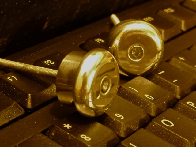

    Cheers all - ended up 3D milling the buggers..!
    About time I had a go with Cut3D.
    Wal.
