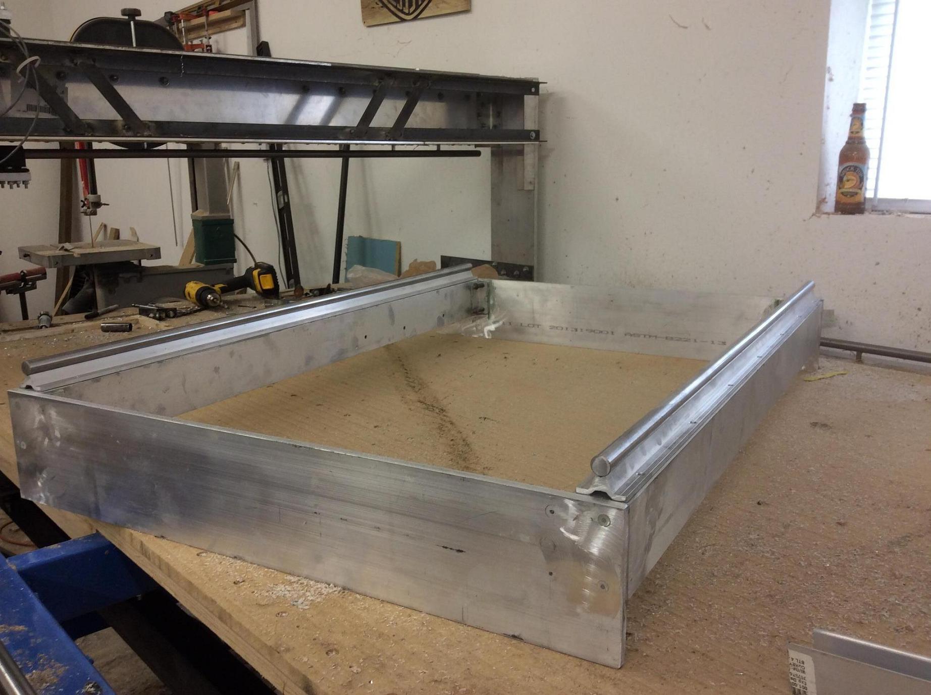

    Building new machine. Aluminum square tubing and plate.
    28"x39". Nema 23 stepper motors from china. 16 mm linear rails and bearings. 1605 ball screws. good pointers on gantry needed. So far thinking of using 1/2 plate for Z.
    going to fill all tubing with expandable foam, to dampen vibrations. I hope.

    Quote Originally Posted by T0rnado69 View Post
    must be a right pain having to unstick that cordless,
    everytime you want to use it. :)
    Ha, using Ridgid trim router. It will stay plugged in, lol
    why, the picture is upside, unknown.
    Quote Originally Posted by Timo View Post
    It would be nice if you could rotate the picture. Foam is no use for dampening it is not dense enough dried silica sand would be better. Make sure you get low inductance motors and 1/2" plate will bend like hell.
    What do you want to use the router for because as it is, it just might be able to cut foam. ..Clive

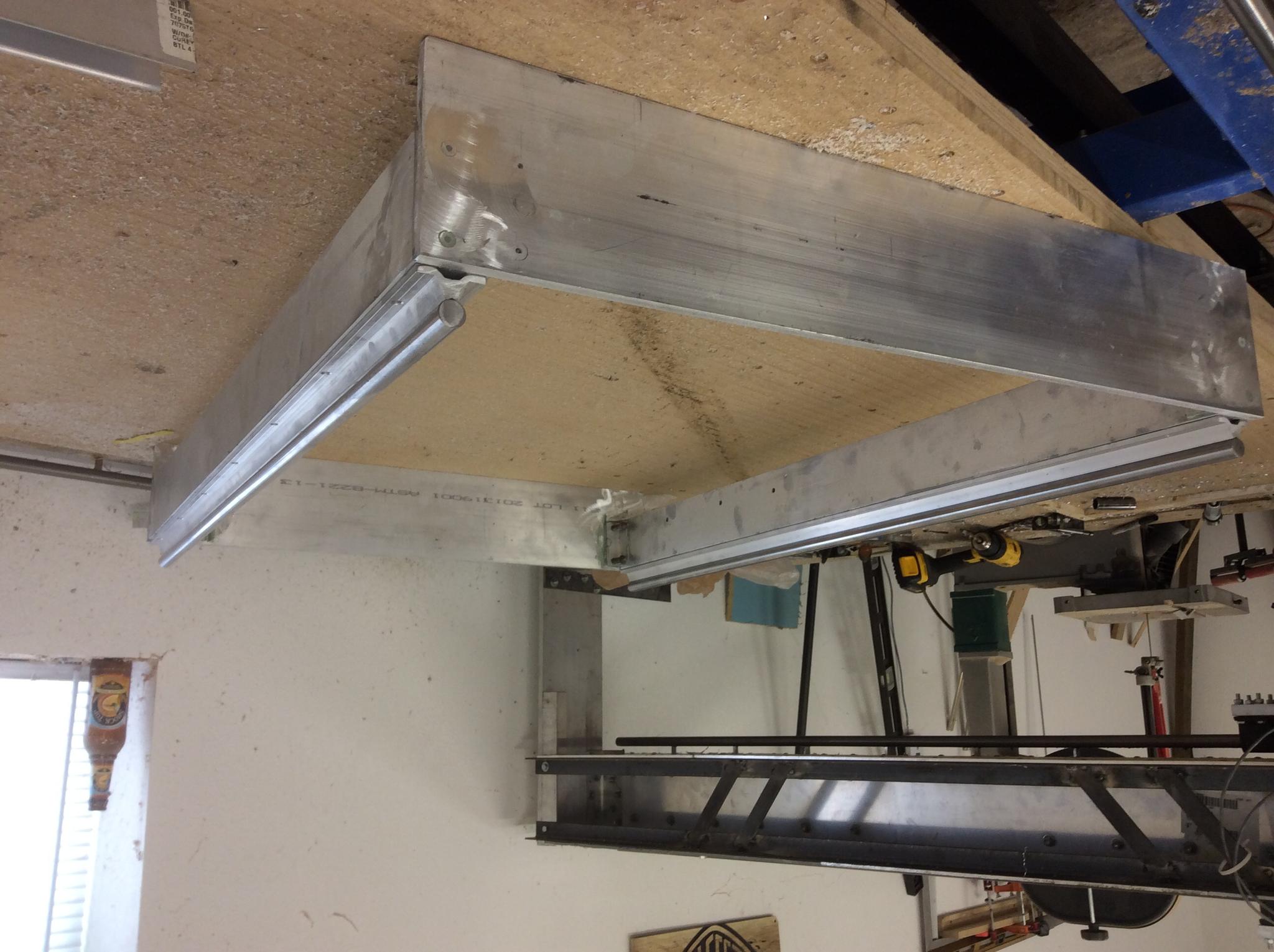

    rotated it around for you . . .

    thanks.
    its now painted and i'am working on side rails and gantry.
    will post picture as it builds. hope to have it done In a week or two.
