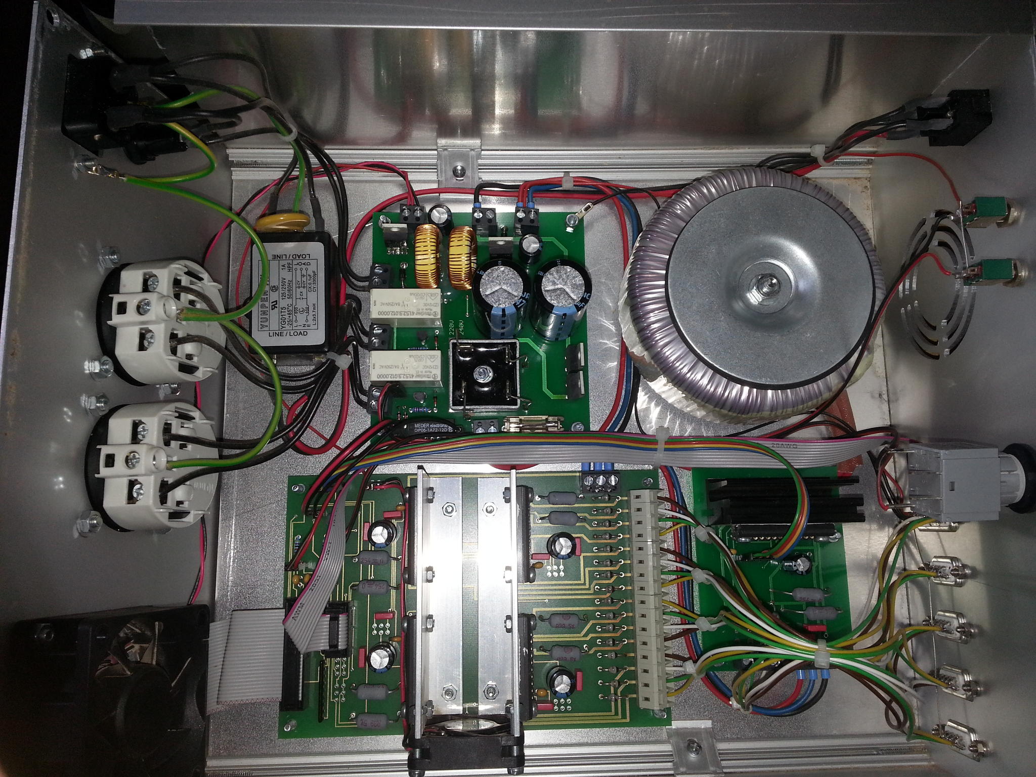

    I am a bit clueless regards checking the input guys.
    This is the inside of my control box.
    The signal i assume comes in on the ribbon cable via the ST port on the right of the picture and terminates next to the parallel port.
    Can anyone talk me through testing it so as i don't fry myself and the control box
