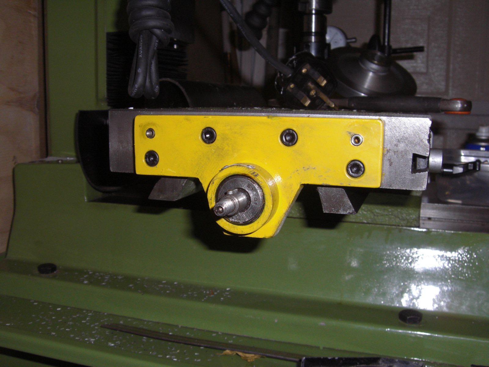

    I converted this mill about 9 months ago using the existing screws. with 3.1nm motors and now
    I am just changing the lead screws to ball screws if this helps on my Warco WM-18 mill I will be use 1605 screws.
    I machined a slot out under the X table with my router very slowly 1mm DOC 200mm/min with a 6mm carbide 4 flute at 5500 rpm.
    The yellow endplate on the X table will have the boss taken off and the hole opened out to 42mm, then a boss will be made to insert into the 42mm hole.
    The boss will then have a 32mm hole cut out for the AC bearings offset by 3 mm to bring the screw up into the machined slot under the X table by that amount.

    The Y screw will fit using the original boss just opened out to 32mm for the AC bearing.
    Then of course there is the Z to think about. ..Clive

    Excellent pics Clive, thanks (do you have a build log?)
    I'm assuming the slot in the bed and moving the replacement ballscrew up is needed to clear the Y axis carriage below it? I was rather hoping to get away without modding the main milling structures (beds etc.)
    BTW - when you milled that slot were you using a 2.2Kw Spindle on your router? I've not tried running mine that slow as I thought you got torque issues below 6000rpm?
    The Z axis looks like it could be converted by using a new top plate/bearing holder with a stepper/belt arrangement essentially strapped to the back of the column and abandon the "differential/bevelled gears" from the original?
