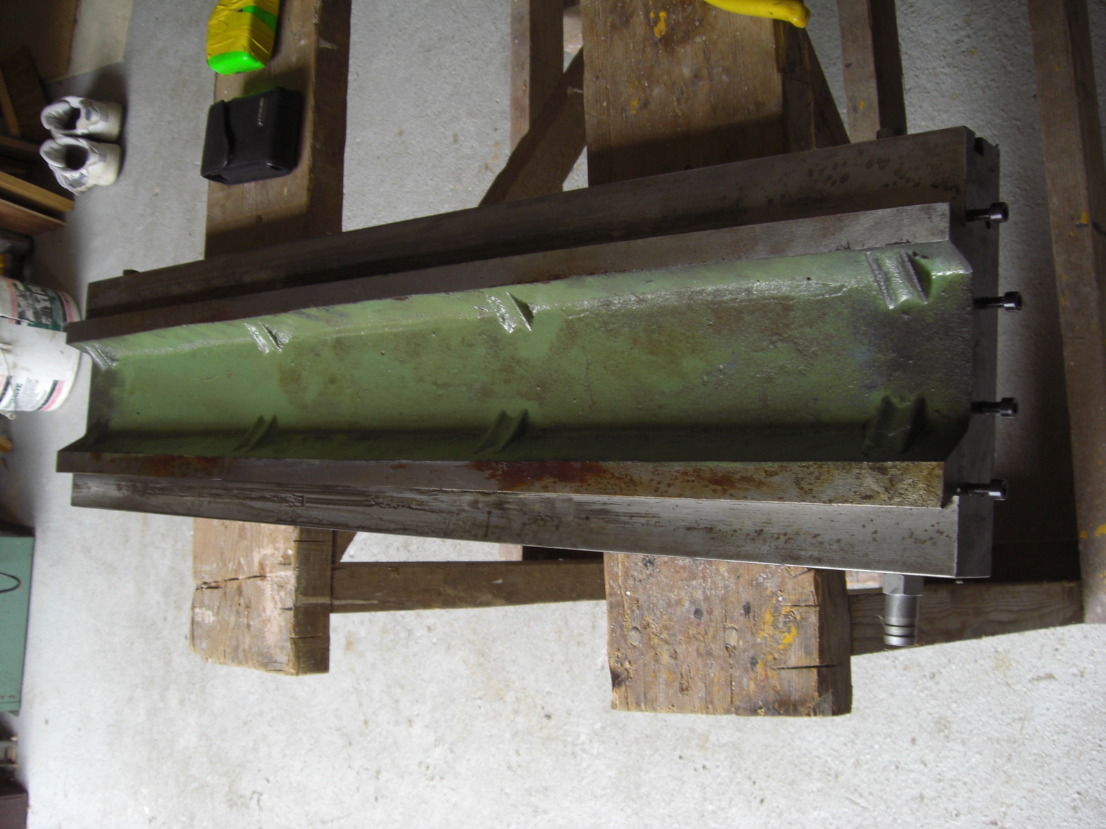

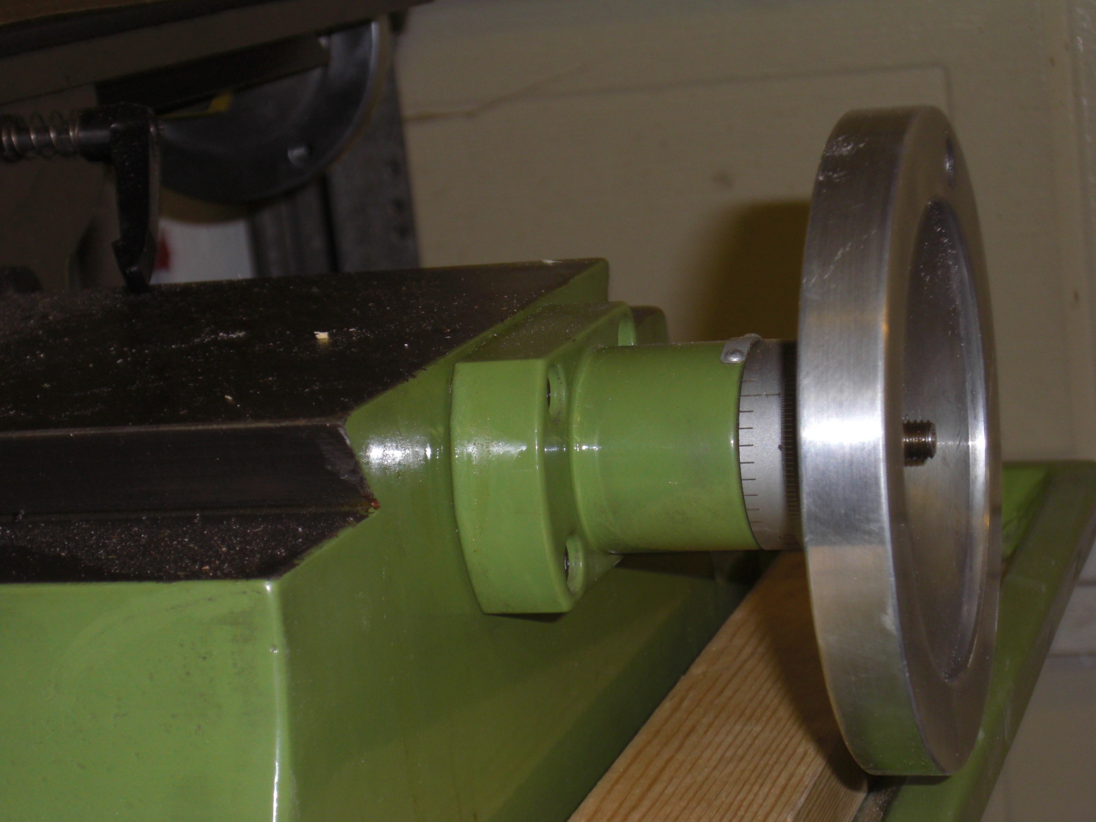

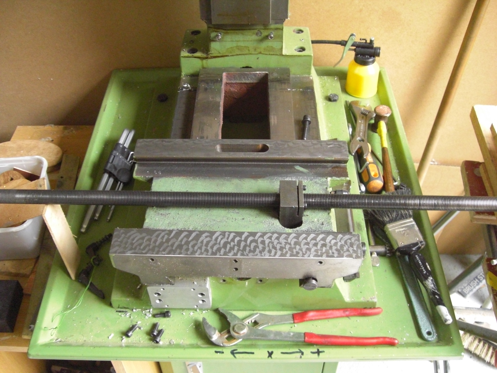

    Hope these are of use?
    Neil...
    Build log...here
  10. The Following User Says Thank You to njhussey For This Useful Post:
  11. #8
    Thanks Neil
    Those are perfect and looking at the lead screw mounts/bearing blocks I think those will be fairly easy to adapt to ball screws/steppers - clearance underneath looks a little tight, but I guess a custom coupling can be made also.
    I'm guessing that a 1605 size would fit in there?
    I'm 90% sure I'll be buying the same machine or the dovetail Z axis variant.

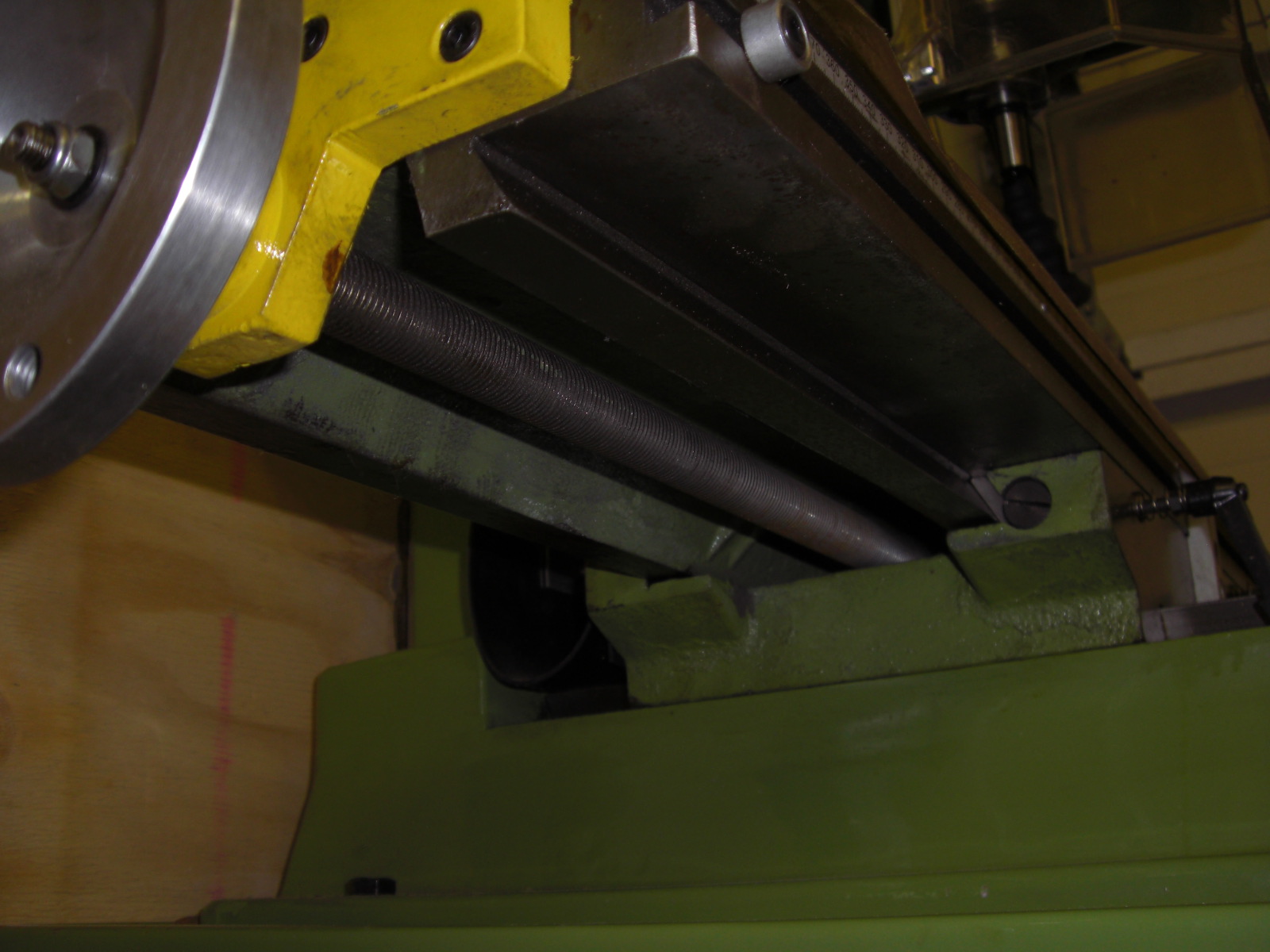

    I converted this mill about 9 months ago using the existing screws. with 3.1nm motors and now
    I am just changing the lead screws to ball screws if this helps on my Warco WM-18 mill I will be use 1605 screws.
    I machined a slot out under the X table with my router very slowly 1mm DOC 200mm/min with a 6mm carbide 4 flute at 5500 rpm.
    The yellow endplate on the X table will have the boss taken off and the hole opened out to 42mm, then a boss will be made to insert into the 42mm hole.
    The boss will then have a 32mm hole cut out for the AC bearings offset by 3 mm to bring the screw up into the machined slot under the X table by that amount.
    Attachment 12572

    The Y screw will fit using the original boss just opened out to 32mm for the AC bearing.
    Then of course there is the Z to think about. ..Clive
