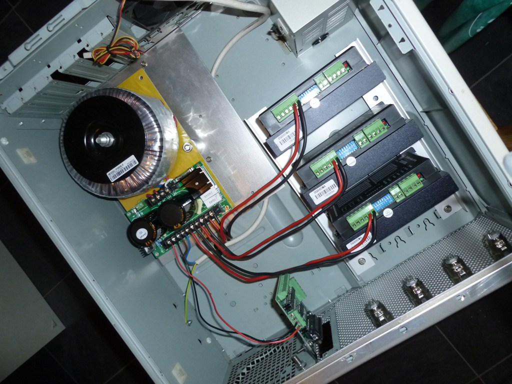

    I'm currently working on my driver box and it seems to be going okay (thanks in no small part to Clive.S - a top bloke who has helped me out massively) but as Clive is using a different BOB to me, I thought I'd throw my plans out here to see if I was heading down the right path...
    I'm using 3 Wantai drivers (DQ860MA) at 70v along with the free BOB that comes with 'em, which I'm powering from the integrated 5v auxiliary on my power supply.
    The first question - if you look at the picture of the BOB - how come there are 2 sets of inputs for the power - my board has them marked as +5V/GND/GND/VDD - or is the idea that you power the board with one set and are then able to take power from the other set?
    I know that P1&P2 are intended for XPUL and XDIR respectively. P3&P4 are intended for YPUL and YDIR respectively and (yep) P5&P6 are for ZPUL and ZDIR. I've also been told not to worry about the ENBL+/- pins for my application.
    So, with that in mind, will this wiring work:

    Ok well don't know this BOB but I'll take educated guess and say that VCC is the positive to power the board and GND is obviosly the ground.
    The +5v & Gnd will be a output the BOB provides for powering other things.
    Regards the wiring then Yes the diagram is correct and will work. Don't take power from the Vdd to the Pul/dir.
    Can't see the Linux link but again I'll take a guess.? . . . Chances are he's done this so when there a Limit or E-stop it disables the drives but doesn't Kill power so the Motors stay Energised and don't lose holding torque, the Enable just stops any signals getting thru.

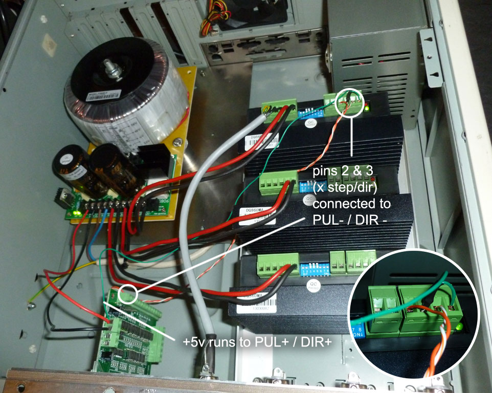

    Okay, so I connected an axis up using the control pins (2/3) to PUL+ / DIR+ respectively with the PUL- / DIR- going back to the GRND on the BOB.
    Nowt.
    Set the step outputs to 'active low' - thanks again Clive for pointing out how to do this: check the 'invert' box in the Parallel Port Setup window (Stepconf utility)
    Still nothing.
    After a fair amount of head-scratching I measured the voltages coming into the PUL+ / DIR+ terminals on the driver - I know that it's gonna fluctuate when the 'test axis' utility is running, but the voltage was peaking at about 2v, both at the driver and the BOB. A bit more head-scratching before connecting the control pins (2/3) on the BOB to the PUL- / DIR- and +5v to the PUL+ / DIR +. Output pins still set to 'active low' and hey presto...
    Pics and (rather meaningless, yet somehow satisfactory) video of my motor rotating back and forth attached.
