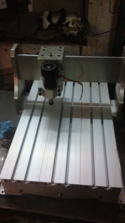

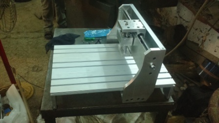

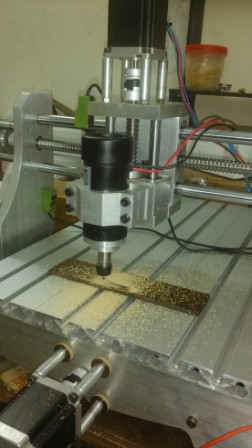

    Hi every one it has been a week now. I have assembled the frame.
ID:	12645Click image for larger version.
ID:	12646Click image for larger version.
    I am running Mach3 Version R3.043.066
    Every thing is running fine, but there is a problem. when a program is running or the machine is idle, motors rotates randomly. The motion is for fraction of a second. This can happen any time even when the machine is not running any g-code. I am unable to identify the problem. Please kindly help.

  4. #14
    This will be electrical noise. Use shielded cable on all motors and signal cables and ground the shielding at one end only and take all grounds to a single point. Don't run single cables along side high power cables like Spindle power cable.
    Don't fasten signal and power cables together using cable ties.
